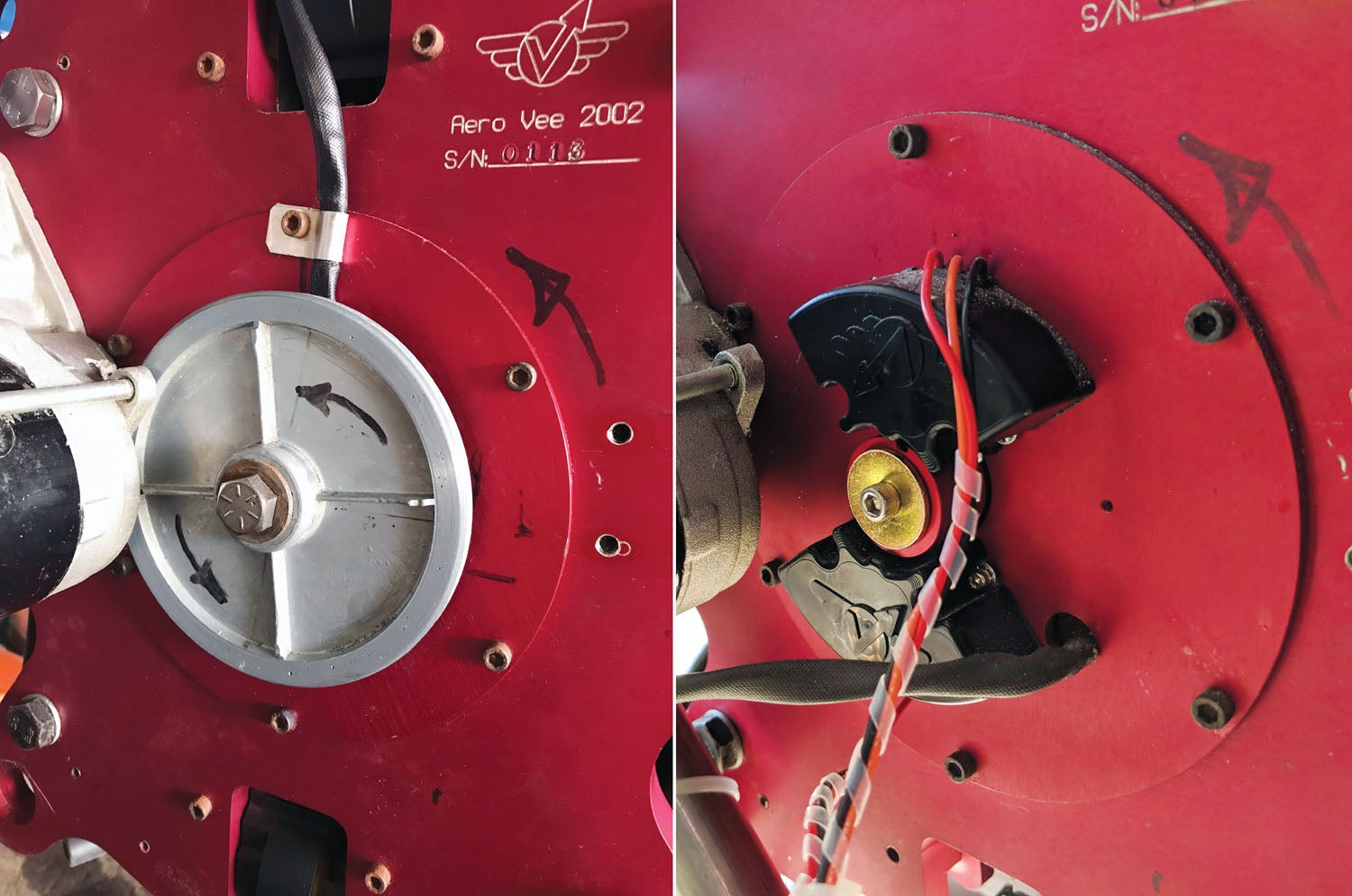

Dreams take Flight Photo 2 FORES
A secondhand AeroVee engine had been modified with an alternative ignition system. Neither the new owner nor I knew this until confusion on both sides was resolved by my request for photos. The photo on the left shows the incorrect ignition. The photo on the right shows the engine after the ignition was returned to stock configuration.
