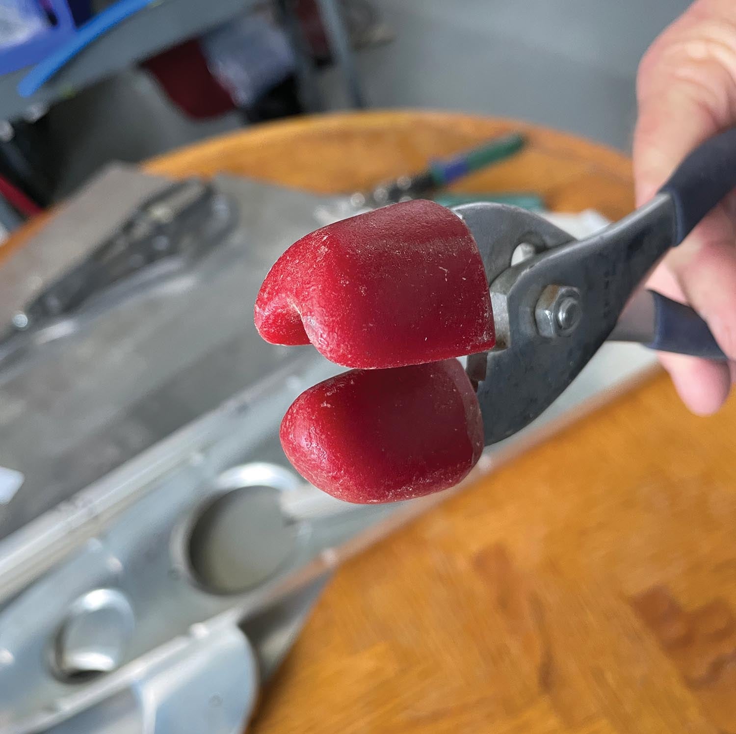

pliersAs a builder of a metal aircraft kit, you no doubt have heard the term “fluting” and fluting pliers. Let’s examine fluting pliers and why the fluting process is an important aspect of building a metal aircraft. If you haven’t experienced fluting firsthand, you will be pleased at how useful and easy it is to master the techniques. An inexpensive set of special pliers is all you need to get started.

Note the shape of the plier tip for forming flutes.
How does fluting modify a normally straight, rigid L-angle? Looking at the tip of these pliers reveals what is happening. The pliers press a bump into the flat metal, which causes the linear dimension of the metal to shorten. Repeated flutes shorten (shrink) the length of one side of the L-angle and something must give! With practice, you can predict in advance what alteration will take place to a component as a result of shrinking one of its features.

Two popular styles of fluting pliers commonly used in aircraft work are shown here. The difference between the two is the size and style of the bump impressions that are made. Larger, deeper flutes mean that fewer of them are needed for a given job. The pliers with the smaller flutes will require more flute impressions to achieve the same effect. More precise, less aggressive modifications can be achieved with these smaller flutes.
