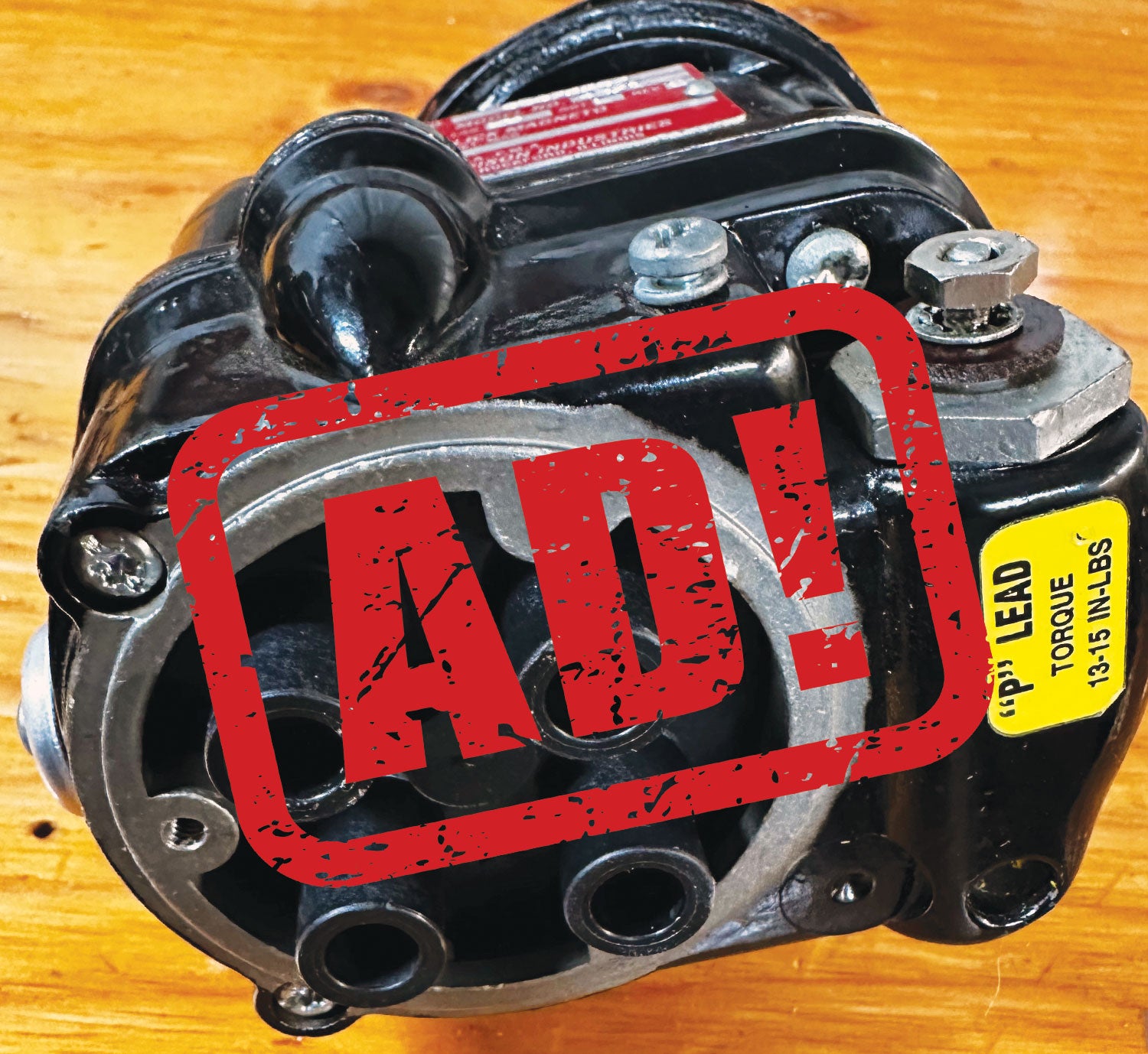

This magneto may have an active AD on it. Does it apply to your airplane? What will you do about it if it does?

But even the FAA’s newer stance on ADs for Experimentals has holes in it. One example I found is an older AD on certain Hartzell propellers. In the Applicability section it lists a number of engine variants and their common airframe mates. It also says, “These propellers and engines could be installed on, but not limited to” a range of models. Included in that list is a smattering of Experimental/Amateur-Built types—including the Lancair 360 and Van’s RV-6, RV-7 and RV-8—but it’s sure an incomplete list. Which explains the “not limited to” phrase that precedes the list.
Another example is the now-infamous crankshaft AD on Superior 360s. In fact, the Superior-made cranks could be in new Superior engines or used as a replacement in rebuilt 360s. In the Applicability section, the AD states that it applies to a range of engines with one of two crankshafts installed. It does not explicitly say that the AD applies to any aircraft with these installed; that part is implied by the AD on the engine itself.
In both of these cases, I can see owners shrugging their shoulders and claiming that these ADs don’t apply to them because their installation isn’t specifically listed. That’s nonsense.
