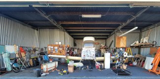

Last winter, with a storm howling and rattling the hangar doors, I decided to make an intake duct for our Tundra project. The male mold was carved from laminated slabs of blue insulation foam, then wrapped in 2-inch-wide vinyl electrical bundling tape to give it a smooth, non-porous surface. Next, I waxed it with an old can of car paste wax I keep around as a mold release.
After a couple of layers of glass had been applied and allowed to cure, it was time to remove the core. Carving it with a knife is one alternative, but a far quicker and simpler trick is to get out a little acetone and pour it into the foam core. Heck, the entertainment value of this technique is worth it, all by itself. The acetone dissolves away the foam like Alien blood eating through the Nostromo’s decking material (old sci-fi movie reference). The glue holding the layers of foam together doesn’t react with the acetone, so you end up with some interesting planes of dissolution (not to be confused with the plains of desolation). With the foam rapidly disappearing, it was a simple matter to grab an edge of the vinyl tape and pull it away from the fiberglass—the paste wax acting as a perfect parting agent.
