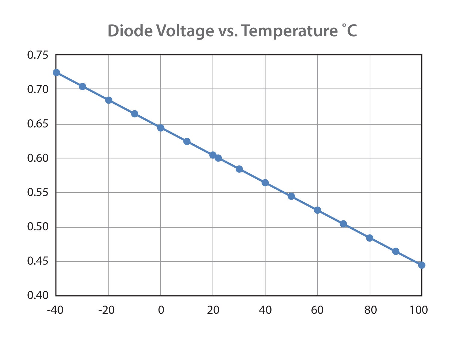

DiodeVoltage
Diode voltage versus temperature at sea level. This doesn’t quite work at my home base, Nevada County Airpark (KGOO) at 3000 feet AGL.
The simplest use I can think of is to measure outside air temperature (OAT). We might think of using it to measure cylinder head temperature (CHT). That’s about the limit for silicon diodes. Most of them don’t like much above 400° F (204° C), and even for high-performance engines this may be a bit high. In my experience silicon diodes are much more useful in the electronic engineering lab for measuring transistor heat sink temperatures and the like. Or the temperature of the coffee coming out of the lab coffeepot. Or the temperature of your firewall or the engine baffles in flight.
So, here’s the deal: The forward voltage of a silicon diode, biased with some reasonable forward current (say, 20 mA or so), is about 0.600 volts. That is at room temperature, 22° C. For each °C above this, the diode voltage drops about 2 millivolts (0.002 volts). So for a summer room temperature of 32° C, our diode has dropped 20 millivolts, so the diode voltage is now 0.580 volts.

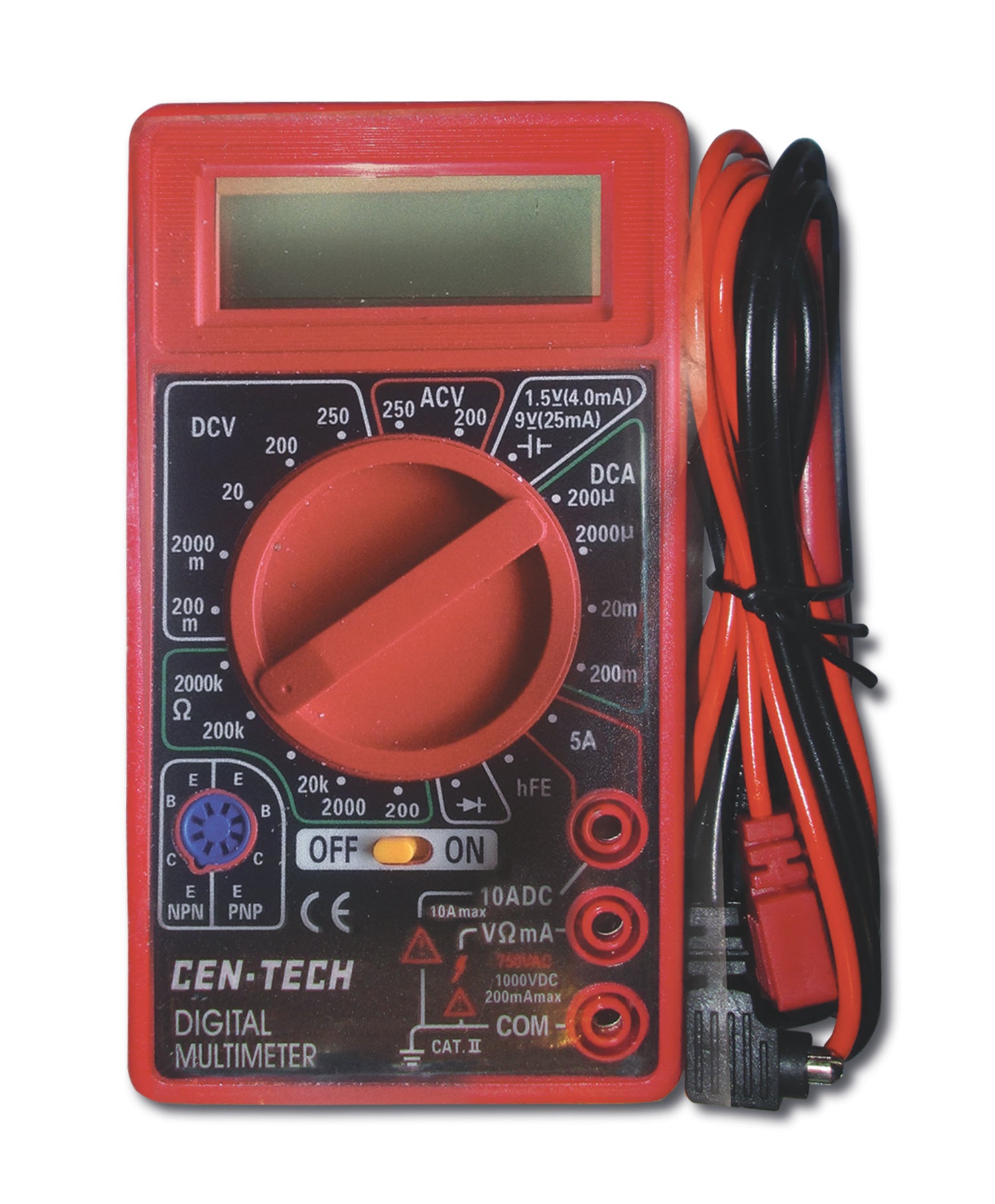

cen tech multimeter
A Harbor Freight voltmeter is what I use for aircraft mechanic work and KITPLANES project development. Still $6.99 but often on sale or free with a coupon and other purchase.
The first and easiest implementation is to use a high-impedance voltmeter to measure the voltage and then use your hotshot cellphone computer to do the conversion of voltage to temperature. My voltmeter of choice (as I have expounded in these columns over the years) is the cheap Harbor Freight digital voltmeter. This particular unit has been my go-to companion for nearly 20 years (in various incarnations as I drop one while working on the rotating beacon on the top of the fin to a concrete floor). Still seven bucks and available every now and again for a free coupon with any other sale. It’s every bit as accurate as the most expensive meter in my arsenal and still runs for about four or five years on a regular old 9-volt battery. While I would never admit it to the feds, there are several dozen aircraft flying today that have had this voltmeter used to repair them. (There must have been a typo in this article to admit this.)
