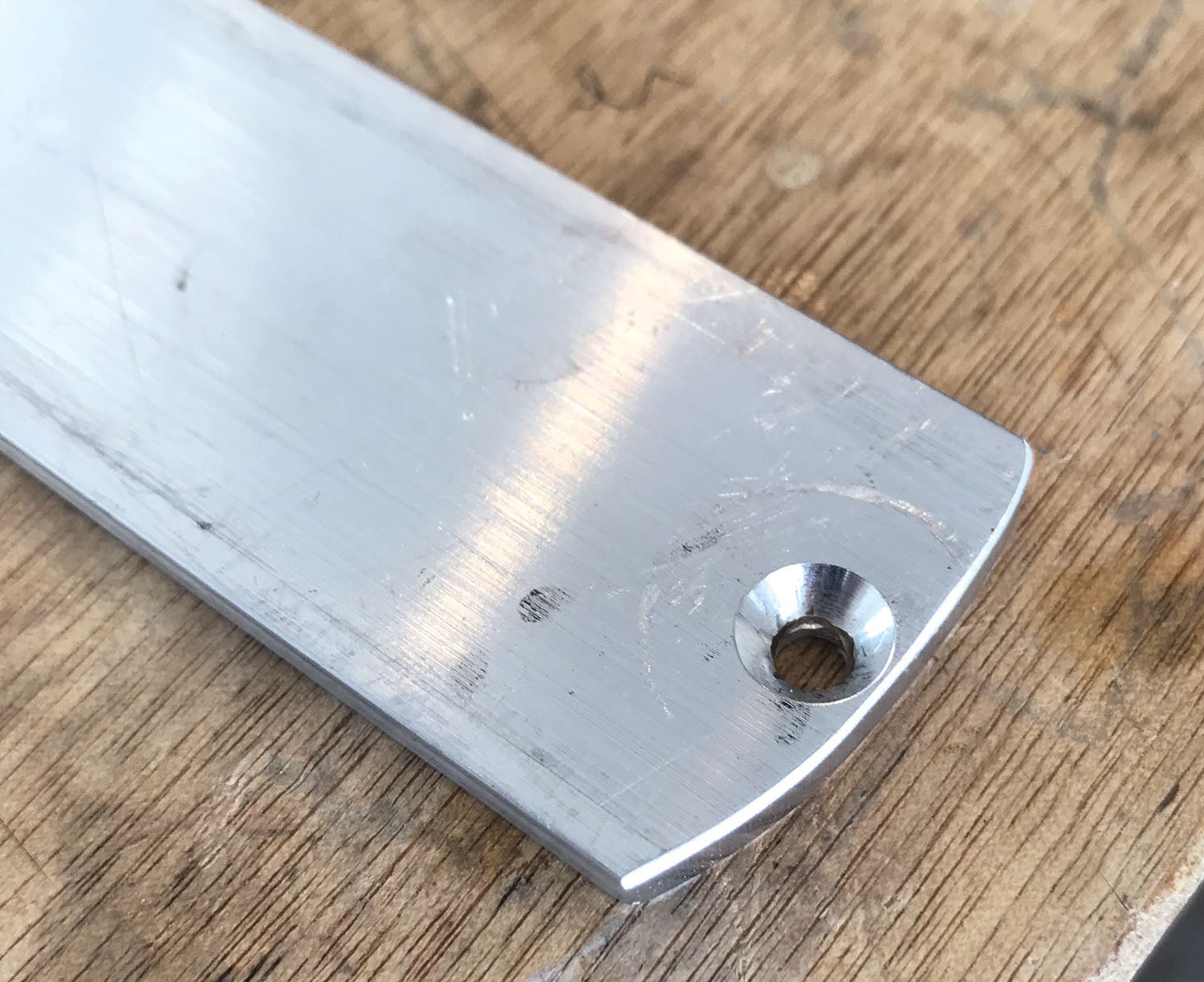

Illustrating the problem. Yes, you could remove the glareshield to make room for the die on this hole (left), but the flange slants inward shortly ahead of this hole and the angle of the longeron will get in the way. You need a thinner female end. The dimple stick is nothing more than a scrap of aluminum with the appropriate countersink cut into it (right). Make sure it is thick enough to account for the full length of the nose on the male die.
The answer we found was to make a “dimple stick.” It’s simply  a piece of 3/16-inch aluminum long enough to give us a handle that we could manipulate. We drilled a hole near the end and countersunk it, making a female die in the stick. We then adjusted the squeezer with the no-hole yoke so that we’d get a perfect dimple with the dimple stick placed against the end of the yoke. The total thickness was less than 3/8 inch and fit everywhere we needed it. You do have to be able to tease the trigger on the squeezer to get the male die started into the hole and then line up the dimple stick before you close things up and go full force. The funnel nature of the female die helps, but you could ding things up if you aren’t careful.

The dimple stick fits up against the back of the material to be dimpled and will fit in a very narrow space (left). Now you just need room for the squeezer yoke. The thin end of the no-hole yoke makes quick work of this little problem (right) and proves once again that gold lies within your scrap bin—or at least the making of golden tools.
The trick worked well for us, and I’m saving the stick for the next time I run into a place where there is just no room—or no good angle—to get an actual die around the back side of the work piece.
