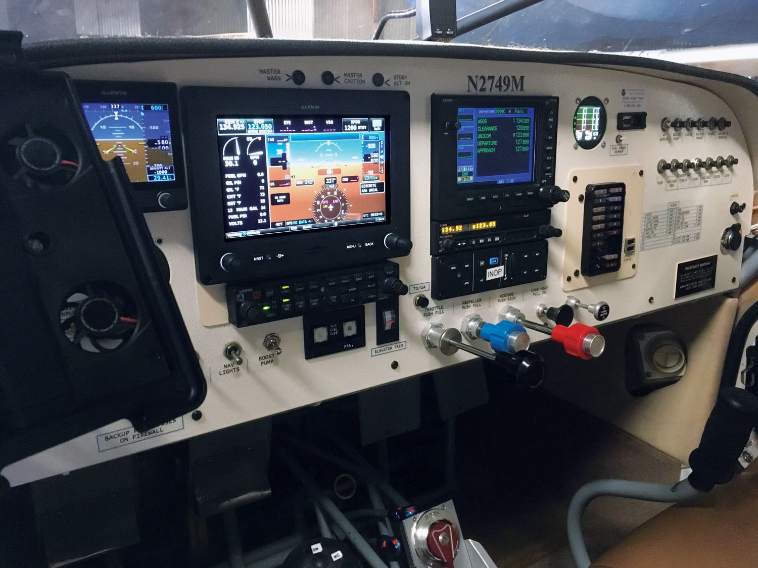

46 throttle
Here the engine controls have been labeled (left). The autopilot is temporarily “inop” pending installation of the servos. The circuit breakers and fuse box get their own labels (right); the “fuse function” grid is a necessity.

At this point, the project is physically complete. I should be able to get the four-month-old condition inspection signed off. Then I can start doing some calibration flying and debug the headset noise issue. I’m going to see if I can find a GMA 340 audio panel on the field to borrow. I bought my unit used. It behaved oddly enough on the bench that I sent it back. He put it in his plane and said it worked fine and returned it to me. It’s behaving properly in the plane, but I’m still suspicious about it.

Here’s the current stack with the GTN 750 replacing the GNS 500W and SL 40. This is the final panel, I promise.
