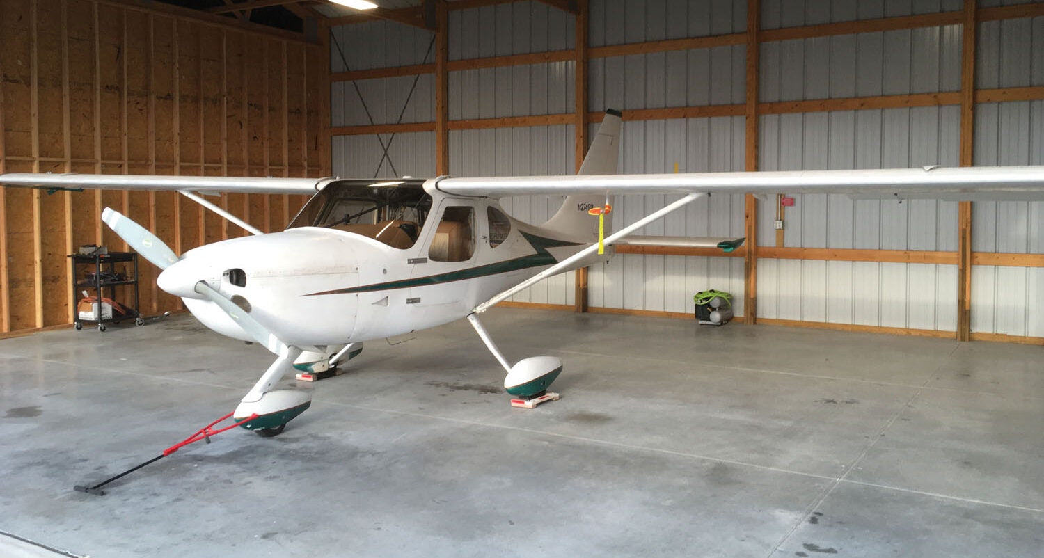

It’s especially fun doing this work in an unheated hangar when it’s below freezing. Fortunately, most of the time, it’s been in the 40s, so I don’t freeze up too bad.

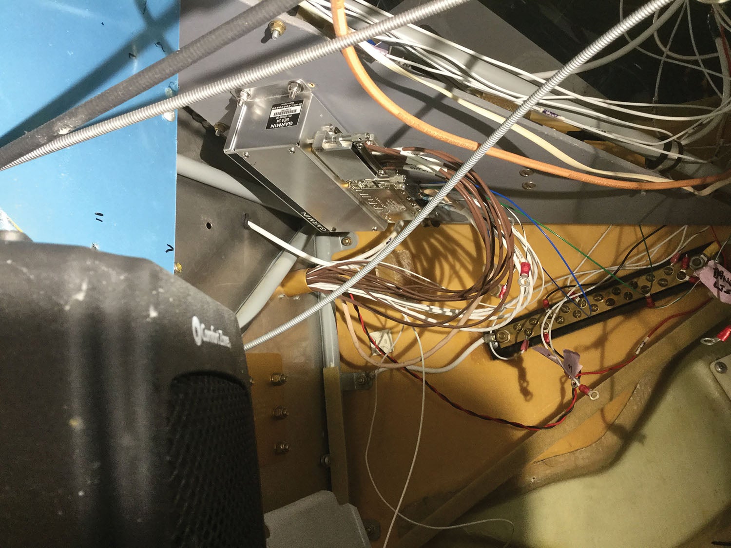

A custom-built rack holds the transponder (shown) and the remote com on the cabin side of the firewall (left). It’s important to test-fit all the boxes (right). Note that the audio panel was slated to go in the “normal” spot at the top of the rack.

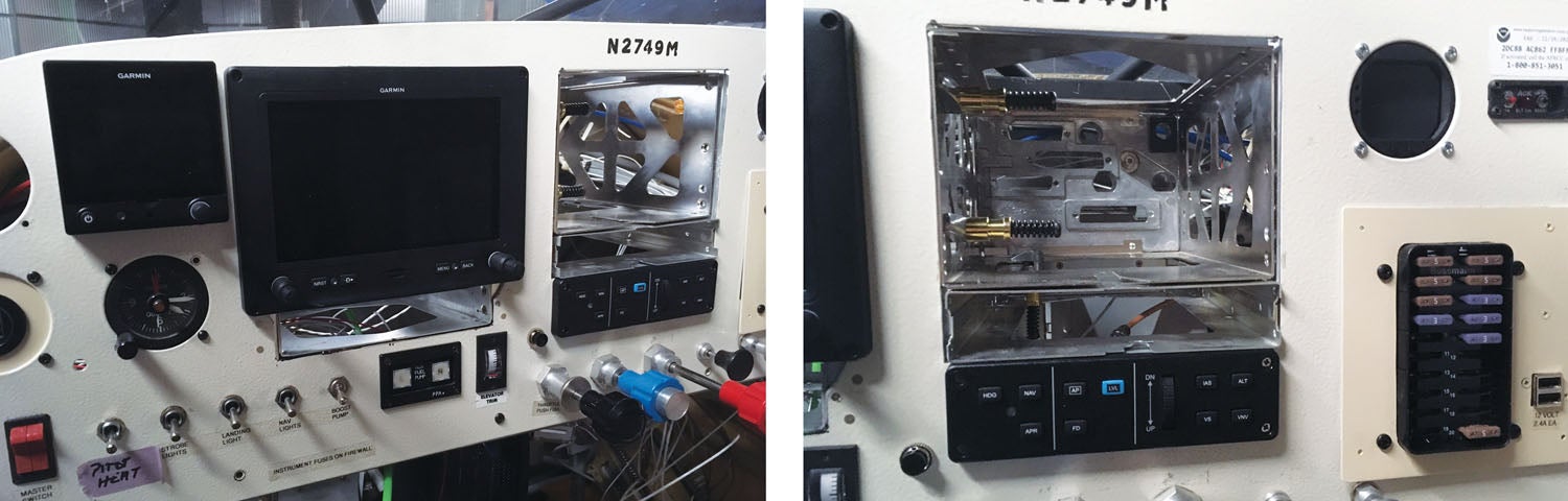

I did decide to mount the audio panel right below the G3X, and my other task today was cutting that hole and riveting in a couple of mounting brackets. I also riveted in the bracket that holds the G3X. While not technically necessary, this will allow me to remove the unit without having to take the glareshield off. Finally, I relocated the clock to the space below the G5. With my iPad in the corner, it completely hid the clock in its previous position.
A panel on the right side of the instrument panel covers up the hole where the VM 1000 was. Yes, I am using fuses for all the new instruments. I built that panel to mount behind the hole, and I may still. But if I mount it in front, it covers up the five push-button holes along the bottom edge. They are probably a good conversation starter anyway. If I decide to leave it this way, I’ll make the edges and corners a bit prettier.
glastar panel upgrade 09
Final layout with the audio panel under the G3X (left). The GPS 500 is at the top of the central stack with the SL 40 underneath (right). While the GMC305 autopilot control unit looks like it’s the same width, it’s actually 1/2-inch narrower behind the bezel.

The sensor kit came with one, and I installed it on the B-lead from the primary alternator. The shunt can be installed on the battery lead, in which case it shows charge and discharge rates, or on the alternator where it shows the load on the alternator and, therefore, the current all the equipment is using. I prefer the latter because I feel it gives me a better picture of what’s going on. The Garmin G3X can support two shunts. I’m sure many people put the second one on the battery lead, but since I have two alternators it makes a lot more sense to monitor the second one.
The rest of the day was cleaning up some of the existing wiring and sorting out the grounds on the two voltage regulators. I still have to run power and install the low-voltage warning lights. Sorting out where to mount my warning lights is turning into a chore. Because of the small panel size, there is not a lot of free space within the proper field of view. I potentially have five lights: warn and caution from the G3X, caution from the LASAR ignition system and low-voltage from both the primary and secondary alternators. I’m also debating whether any of these will get turned into inputs into the G3X instead of lights.
I was awake half the night Saturday trying to figure out how I was going to run the cable from the new com to the new antenna. Because I don’t have the tools to crimp a BNC connector, I ordered a prebuilt cable. What occurred to me was that the normal openings I run wires through are not big enough for a BNC connector. So when I got to the hangar on Sunday morning, solving that mystery was job one. I won’t keep you in suspense: I ran it down the front copilot corner of the firewall, below the fresh air intake, and by prying with a hammer I was able to make a large enough gap between the fiberglass fuselage shell and the lower diagonal tube to squeeze the BNC through.
