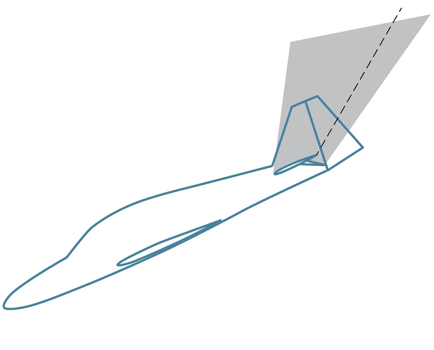

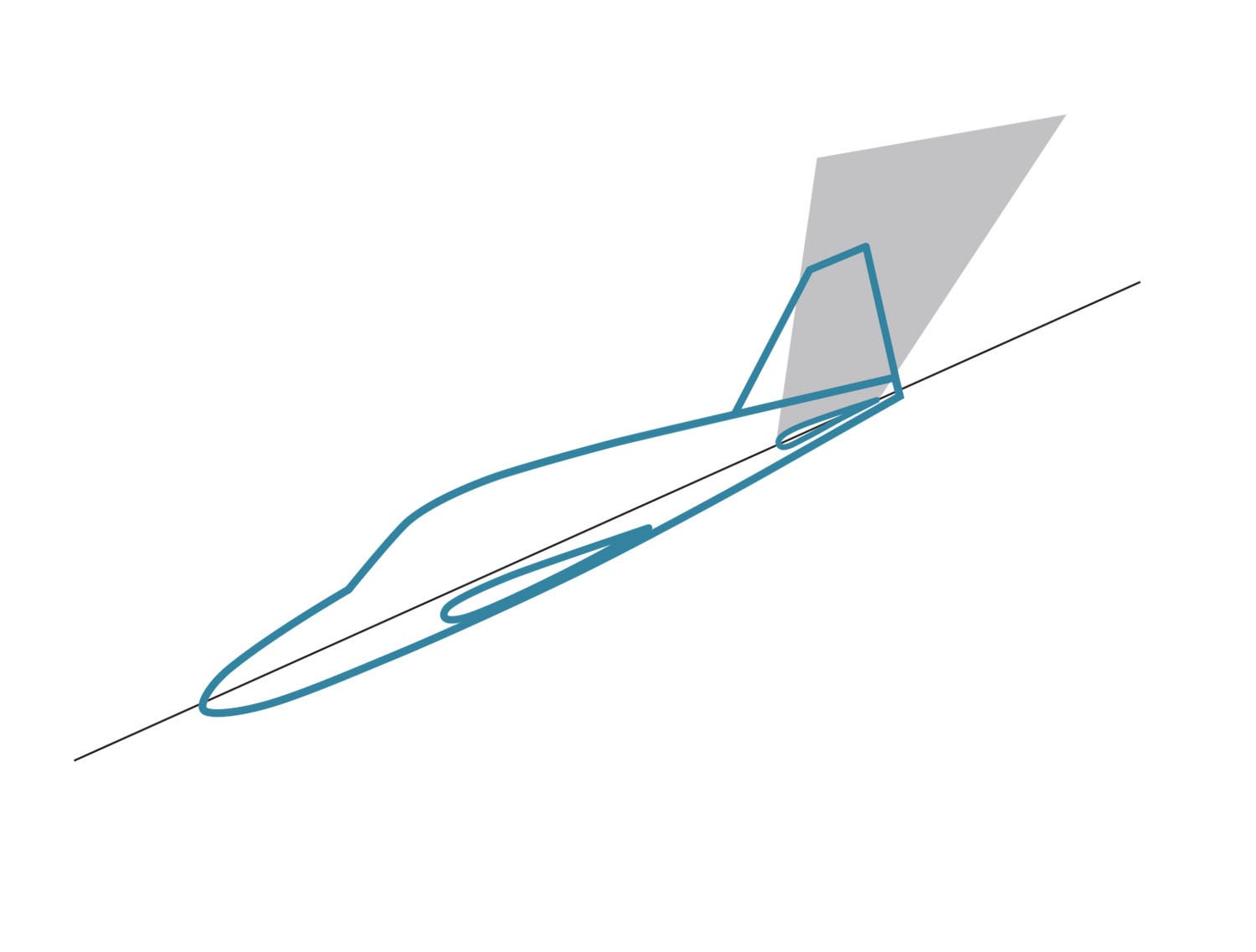

A simple method of estimating how much of the fin and rudder is blanked by the tailplane wake is shown in Figure 1. On a side view of the airplane, draw a line from the leading edge of the tailplane upward at an angle of 60% above horizontal. From the trailing edge of the tailplane, draw a second line upward at an angle of 30%. The airflow in the area between these two lines is likely to be separated in a developed spin. Any fin or rudder area between the two lines will be blanked by the tailplane and will be ineffective.
Figure 2 shows how some combinations of tail position and fin planform affect how much of the vertical tail remains effective in a spin. Note in particular that having side area (fin and/or fuselage) and rudder below the horizontal tail gives the best spin recovery characteristics. If you look at aerobatic airplanes, almost all of them share the following characteristics:

The position of the elevators affects the flow over the rudder at high angles of attack. Deflecting the elevators down can significantly increase the blanking of the rudder by the tail wake as seen in Figure 3. There is at least one airplane that is used for aerobatic training where this effect is so significant that the spin recovery procedure for that type is to keep the stick full aft until opposite rudder stops the spin rotation before moving the stick forward to reduce angle of attack. (Note that this is not a standard recovery technique and should not be used on any other type of airplane unless it is specifically required in the POH.)
