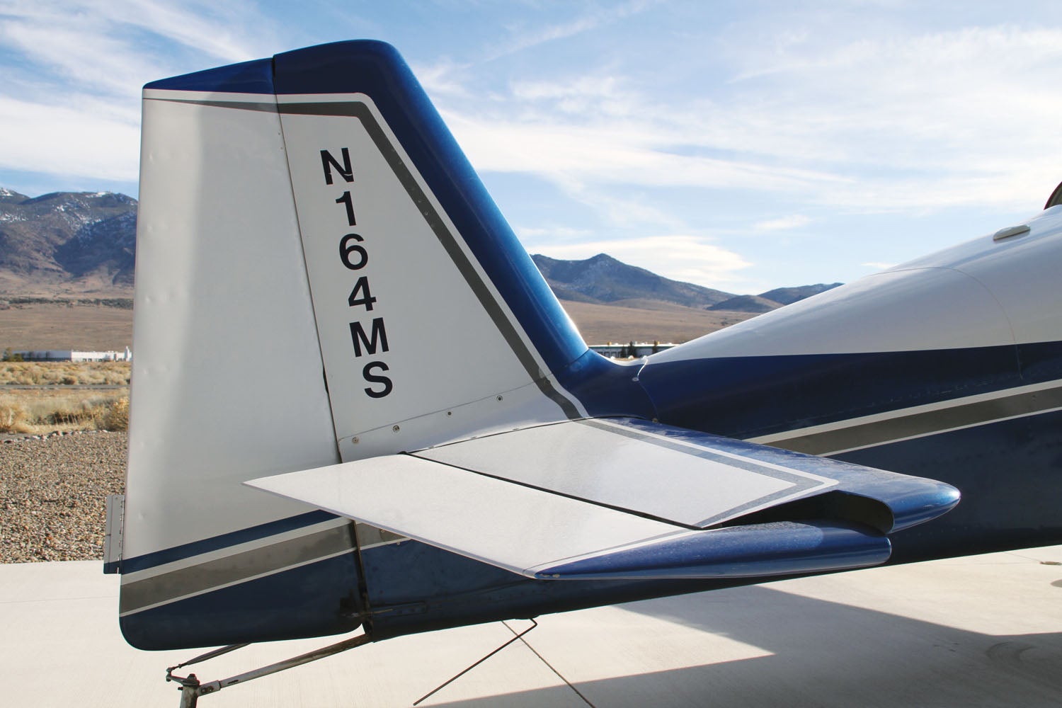

In addition to stabilizing and trimming the airplane, the tail is used to control the airplane in pitch. (Photo: Paul Dye)
The tail of the airplane performs three functions: It stabilizes the aircraft in both pitch and yaw. It provides trim. It provides control power for the pilot to trim and maneuver the airplane.
