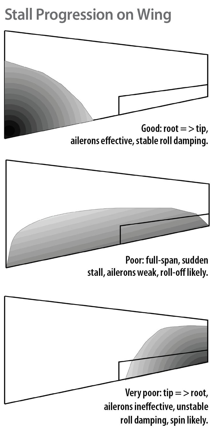

How well the airplane behaves when stalled depends on how the stall develops along the span of the wing. As illustrated in Figure 2, it is best if the wing stalls first at the root.

For the pilot to be able to maintain control in roll at the stall, two things are necessary.
First: The ailerons must remain effective and provide roll control in the proper direction. If the ailerons become ineffective, or if the stall causes aileron control reversal, the pilot will not be able to command the airplane in roll.
Second: The airplane must retain lateral stability and stable roll damping. If these conditions are met, the airplane will not tend to roll off at the stall or try to enter a spin on its own. If not, it will tend to depart into a spin entry at the stall.
How the stall progresses along the wing has a large effect on both of these.
Roll Control
Looking at Figure 2 we can see that if the stall starts at the root, the wing will have attached flow over the outer panel as the stall starts. Since there is still good airflow over the ailerons, the pilot will still have good roll control.
As the initiation of the stall moves outboard, the flow over the ailerons gets more separated and roll control degrades.
A wing that stalls first outboard of the mid semi-span will lose aileron effectiveness early in the stall. In extreme cases, aileron control inputs may exacerbate the stalling of the portion of the wing to which the aileron is attached. In this case, deflecting an aileron downward will exacerbate the local stall and cause that portion of the wing to lose lift, while deflecting the opposite aileron upwards will reattach the flow and increase lift. The lift changes will be opposite of those for normal flight, and aileron control will be reversed, causing the airplane to roll away from the direction of the stick input. This is unsatisfactory and extremely dangerous since the airplane will be uncontrollable in roll, and a pilot’s normal instinctive stick input in response to any roll will accelerate the roll and cause the airplane to depart into a spin entry.

When the wing is partially stalled, dihedral effect depends on the relative roll leverage of the stalled and un-stalled parts of the wing. The outer portion of the wing has a larger lateral moment arm than the inner portion. If the stall starts at the root, the outer part of the wing will still have a positive lift-curve slope and will still provide enough stable dihedral effect to overcome the unstable contribution of the stalled inner portion. The airplane will retain lateral stability during the incipient stall.
If the outer portion of the wing stalls first, the reverse is true and the airplane will become unstable laterally at the stall. It will tend to roll off, and the roll will get worse if the pilot tries to correct the initial departure with rudder.

During the stall, the effect of where on the wing the stall starts on roll damping is similar to its effect on lateral stability. If the stall starts inboard on the wing, the airplane will have stable roll damping during an incipient stall. Any initial roll rate will be opposed by the roll damping and die out.
If the stall starts outboard on the wing, the airplane will have negative (unstable) roll damping. As the airplane starts to roll, the wing will produce a rolling moment that propels the roll, causing the roll to accelerate. Negative roll damping is the primary aerodynamic phenomenon that drives a spin. The unstable rolling moment drives and sustains the rotation.

As we saw last month, wing twist affects the spanwise distribution of local lift coefficient. This is what the designer can use to define a wing that stalls from the root first. For any planform, it is possible to come up with a twist distribution that ensures that the local Cl at the root reaches its airfoil’s Clmax before the outer portion of the wing. This will almost always be a washout, where the wing is twisted leading edge down at the tip relative to the root.
There appears to be a temptation, particularly in the homebuilt community, to minimize or eliminate wing twist to try to reduce drag and increase performance. This is a dangerous mistake. Eliminating twist will save little or no drag and can make the airplane dangerous to fly because of its effect on stall characteristics.
It is critical for safety of flight that the airplane retains stable roll damping and lateral stability at the beginning of the stall. The primary way to ensure this is to put the proper twist in the wing.
