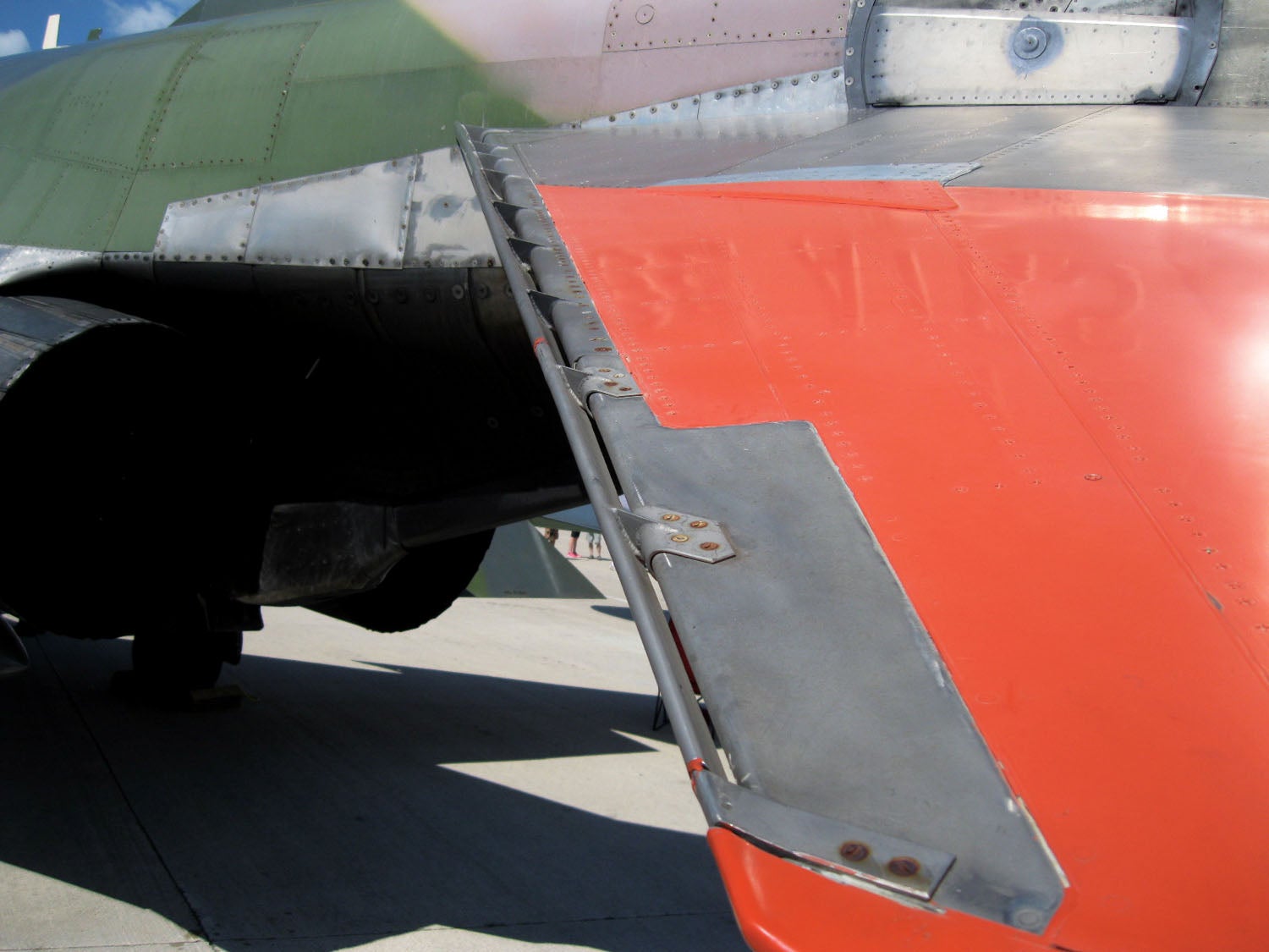

f 4 phantom leading edge slat
The F-4 Phantom has a fixed leading-edge slot on its horizontal tail to delay tail stall and increase nose-up pitch-control power .
Some versions of the F-4 Phantom also had fixed slots on both the wings and tail.
The fixed slot has the advantage of being a fixed-geometry feature with no moving parts. Properly designed it can have a very low, but not zero, drag penalty in cruise if it is incorporated into the base airflow correctly.
The fixed slot has the same issue as vortex generators in that it will trip the boundary layer, and no laminar flow can be expected on wings with fixed leading-edge slots.
