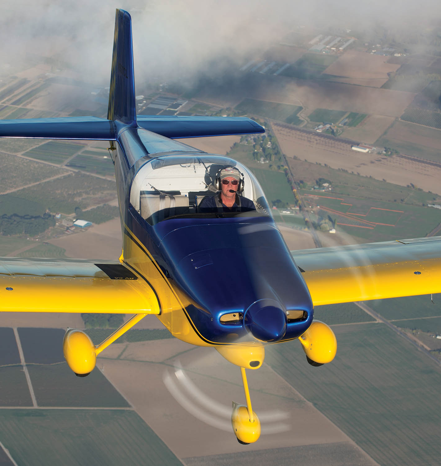

slipstream rv
On most single-engine tractor airplanes, the root of the wing is immersed in the propeller slipstream. The increased velocity in the slipstream increases the amount of lift the immersed portion of the wing is generating. (Photo: Ed Hicks)

On most tractor airplanes, some portion of the wing is immersed in the propeller slipstream. For a single, the root of the wing is in the prop wash, while for a twin it is the portions of the wing behind the engines. The slipstream has two effects, both of which tend to delay the stall. First, the propeller turns the oncoming air and directs it aft more parallel to the prop shaft than the free stream. This reduces the angle of attack of the wing behind the prop. Second, the increased velocity in the slipstream increases the lift the immersed portion of the wing is generating.
Because it delays the stall of the blown portion of the wing, the slipstream changes where the wing stalls power-on. Particularly for a single-engine airplane, the point of initial stall on the wing will shift outboard of the propeller slipstream. A wing that had a benign root-first stall power-off may well stall farther outboard and tend to roll off during a power-on stall.
The combination of the delay in the stall and the shift in stall characteristics is what makes departure stalls more abrupt and dynamic than power-off stalls. The airplane stalls at a slower airspeed and at a more nose-up attitude, making the stall break more dramatic than with power off, and the lateral shift of the initial stall increases the chances the airplane will depart laterally into an incipient spin.
