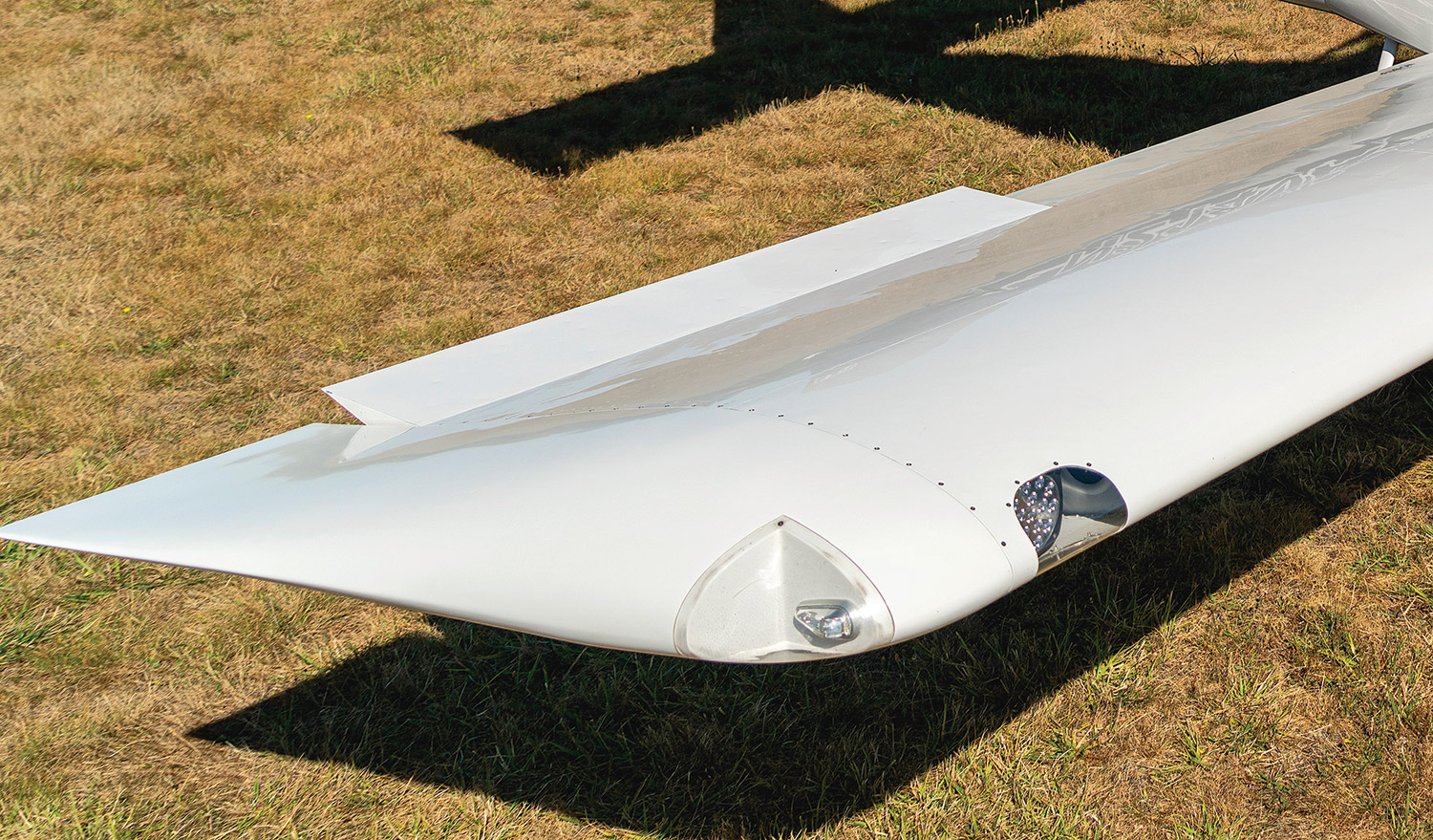

rv-14 aileron
The wing with the aileron deflected up will have less lift than the opposite wing with the aileron deflected down. This asymmetry in lift causes a rolling moment.
