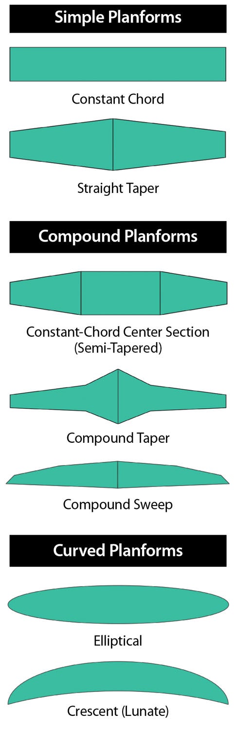

Common Planform Shapes
Constant Chord
The simplest wing planform of all is a constant-chord wing: the leading and trailing edges are parallel. Except for the tips, which might be rounded or have a variety of molded shapes, the planform of the wing is a simple rectangle.
Constant-chord wings are very common on light airplanes. While they have poorer aerodynamic performance and tend to be heavier than more complex wing shapes, they have the very significant advantage that all of the ribs are the same and the spars have a constant height. This makes them cheaper and easier to design and manufacture.
For a large number of general aviation applications, the savings in cost and reduced complexity afforded by the constant-chord wing are sufficient to overcome the weight and aerodynamic performance penalty.
Straight Taper
A second common approach to wing design is to use a simple tapered wing. On a simple tapered wing or “straight-tapered” wing, both the leading and trailing edges are formed by a single straight line. The tip chord is smaller than the root chord, giving the wing a trapezoidal planform.
Tapered wings have better aerodynamic efficiency than constant-chord wings and are also more structurally efficient. The price of this improved efficiency is greater complexity in the structure and a few aerodynamic issues (to be discussed in a future edition of “Wind Tunnel”) that make getting acceptable flying qualities a bit more of a challenge.
Sometimes this trade-off ends up favoring the tapered wing in spite of its issues. For higher-performance airplanes and for missions where efficiency is important, a tapered wing is often the preferred approach.
Compound Taper
The next class of planforms have more complex shapes, which are formed by a series of straight-line segments. There are several types of “compound-taper” planforms that are used.
