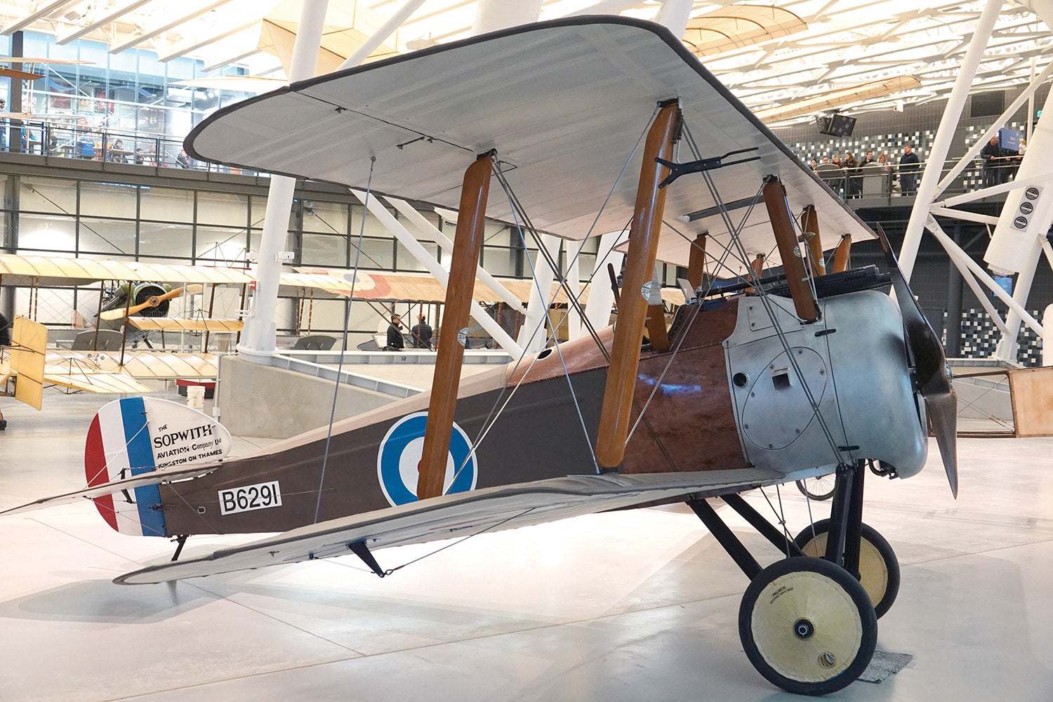

1917 Sopwith F.1 Camel
Early airplanes that operated off grass fields, like this Sopwith Camel, had tail skids that provided stabilizing drag on the aft end of the fuselage when they were in contact with the ground. (Photo: Sanjay Acharya [CC BY-SA 4.0, https://creativecommons.org/licenses/by-sa/4.0])

Early airplanes that operated off grass fields had tail skids that provided stabilizing drag on the aft end of the fuselage when they were in contact with the ground (Stick back!), which made the directional control issue workable even for airplanes with no brakes like most WW-I fighters. This approach does not work on smooth paved runways, so tailwheels were introduced. Some airplanes, particularly larger ones, had lockable tail wheels that could be locked in the fore and aft position to help with directional stability on takeoff, and most modern taildraggers have steerable tailwheels. In spite of these measures, the amount of side force a tailwheel can generate is small because it is lightly loaded, and if the turn rate gets very high, the tailwheel will skid and cease to be helpful in keeping the airplane straight.
