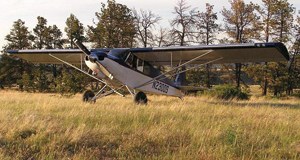

flap types img 2589
When deployed in short-field conditions the double-slotted flaps on this Super Cub decrease stall, takeoff and landing speeds.
The way to delay flow separation to higher deflections is to incorporate a properly shaped slot at the flap hinge line. The slot collects high-energy air from the lower surface of the wing and ejects it onto the upper surface of the deflected flap. This fresh air reenergizes the boundary layer on the flap and helps keep the flow attached.
Slotted flaps increase maximum lift more than plain flaps, so they are a good choice for improving landing performance. A properly designed slotted flap can have low enough drag at small deflections to help takeoff performance too, but the drag of a slotted flap is higher than that of a plain flap because of the airflow though the slot. The drag of the slot flow also makes slotted flaps unsuitable for in-flight camber changing.
Slotted flaps are more difficult to implement mechanically since the hinge geometry must move the flap in such a way that the slot is sealed when the flaps are stowed for cruise, but open when the flaps are deflected. This usually means that some portion of the hinge mechanism will protrude below the wing lower surface and be exposed to the airflow. It’s also common for some portion of the slot to remain open on the lower surface when the flaps are stowed, even though the slot seals internally so no net airflow goes through the slot.
Both of these factors exact a small drag penalty as compared to a clean wing or a clean wing with plain flaps. Accordingly, the extra lift increment from the slotted flap must improve performance enough to be worth this drag penalty.
