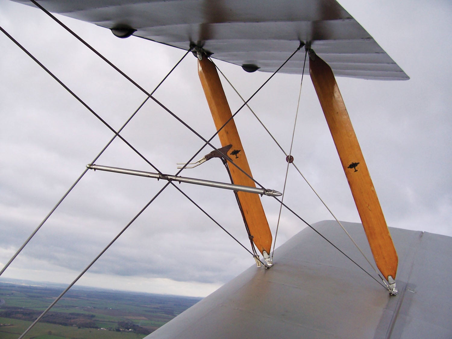

FlyingWires
Wire bracing is well-suited for biplanes because the wires can be arranged to form the diagonal elements of a bridge-like box girder structure. (Photo: Nimbus227)

Wire Bracing
Early airplanes were almost exclusively wire-braced. Since wires only carry tension, the structure needed separate wires to bear the upward and downward loads on the wing. The “flying wires” carry positive lift loads, and “landing wires” handle inertial droop loads on landing and negative lift in inverted flight or in a down-gust.
The biplane layout is well suited to this since the wires can be arranged to form the diagonal elements of a bridge-like box girder structure. By using multiple bays with sets of interplane struts, the wires can be kept relatively short and placed at favorable angles relative to the imposed load.
It’s harder to effectively wire-brace a monoplane wing since all of the wires must go directly to either the fuselage or a fuselage-mounted strut system. This is less structurally efficient than the crisscrossed wires of a biplane and may help explain why early designers tended not to see any significant advantage in a monoplane configuration.

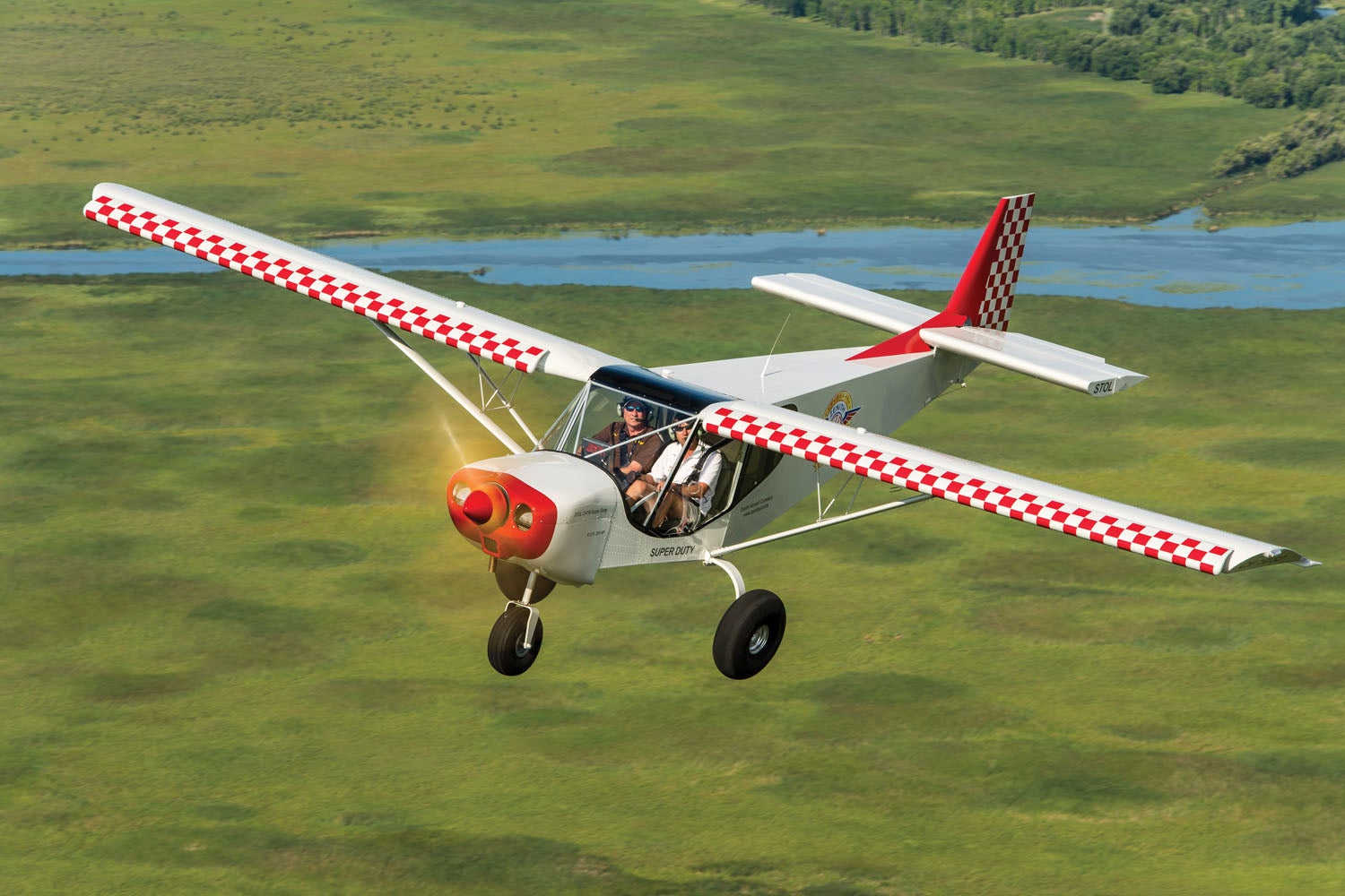

A strut-braced wing consists of a main wing with internal spars braced by either a single strut or a pair of struts. The number of bracing struts depends on the internal layout of the wing itself.
Zenith CH750SD final VanderMeulen RV52302
Strut-braced wings are a good design option for airplanes like the Zenith STOL CH 750 Super Duty, where absolute maximum cross-country performance is less important than takeoff distance and load-carrying ability. (Photo: Richard VanderMeulen)

The primary disadvantage of any externally-braced wing is that the bracing elements, be they struts or wires, are exposed to the airstream and generate significant drag. On early wire-braced wings with circular cross-section wires, the bracing wires actually produced more drag than the wing. On a strut-braced wing with a properly streamlined strut cross section, the struts themselves produce drag approximately equivalent to that of a section of wing that has the same wetted area as the strut. There is some additional drag penalty due to interference of the junctions at the ends of the strut. This can be partially alleviated by well-designed junction fairings.
Strut-braced wings are a good design option for airplanes where absolute maximum cross-country performance is less important than takeoff distance and load-carrying ability. Many utility and bush-flying airplanes are high-wing, strut-braced machines for this very reason.
