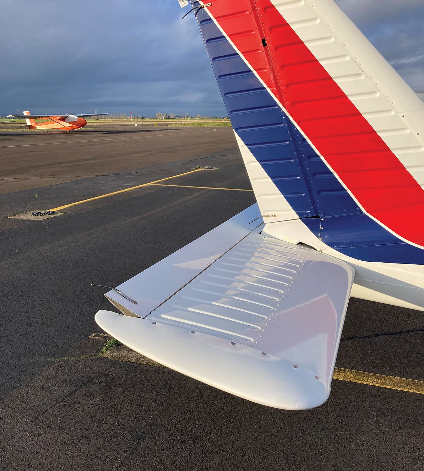

All-moving tails are used on most Piper single-engine airplanes. (Photo: Barnaby Wainfan)

Stick Stability
It’s essential that the pivot axis on an all-moving tail be placed such that when the tail deflects, the moments produced about the hinge line tend to oppose the deflection and drive the tail back to its neutral position. Accordingly, the pivot axis must be ahead of the aerodynamic center (AC) of the tail.
If the axis is behind the tail AC, the tail will be divergent. It will produce moments that tend to increase deflection and will go hard over if the stick is released. This is very dangerous and should be strictly avoided.

The key to regaining the stabilizing influence of the tail stick-free is to reduce or eliminate tail float. A simple way to get some improvement is to use centering springs to hold the tail in a specific position so the airplane is never truly stick-free. This has been tried occasionally with limited success. It is difficult to get acceptable flying qualities this way. By the time the springs are strong enough to have a large favorable effect on stability, they are also strong enough to make the pilot’s stick force to move the tail against the spring force objectionably high.
The aerodynamic and mechanical solution has two parts: The first is to place the pivot axis for the tail at, or very slightly ahead of, the AC of the tail. This minimizes the aerodynamic hinge moment driving the tail float. Unfortunately, it also makes the stick forces too light, so the airplane will be unacceptably sensitive in pitch.
To solve this, we add an anti-servo tab to the trailing edge of the tail. This is a tab, usually covering most of the span of the trailing edge), that is geared to “lead” the deflection of the tail itself relative to the fuselage. For example, if the tail is deflected trailing-edge-up by the pilot, the tab will deflect trailing-edge-up relative to the tail.
The tab produces a hinge moment that opposes the deflection of the tail. This fights float and is also used to tailor pitch stick forces by tuning the ratio of tab deflection to tail deflection. The anti-servo-tab linkage can also be designed to make the neutral position of the tab adjustable by the pilot, so the tab also acts as a classical trim tab. This is the system used by most general aviation airplanes with all-moving tails.
