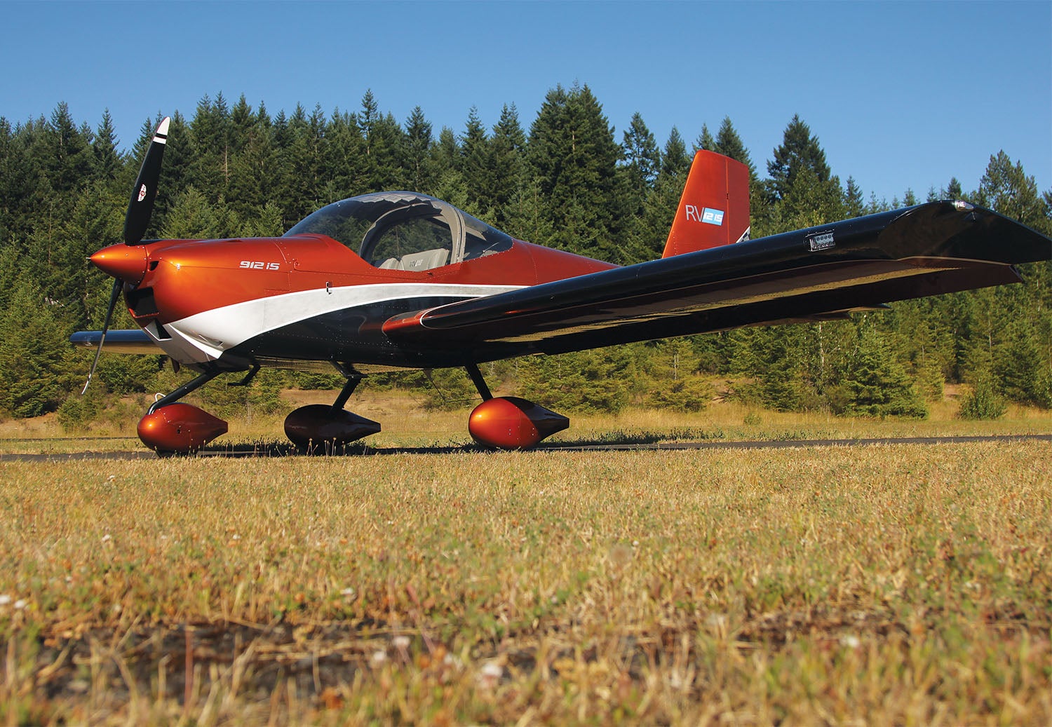

Landing and 1G Stall
rv 12 wind tunnel
The second flight condition to consider is landing, where the primary concern is stall speed. For many airplanes, the wing is sized by a stall speed requirement. (Photo: Van’s Aircraft)
The primary concern in the landing configuration is stall speed. Stall speed is a function of the wing loading of the airplane and the maximum lift coefficient (CLMAX) the wing can develop. Once the CLMAX is set, it determines the wing loading and hence wing area the airplane must have to meet a given stall speed.
For many airplanes, the wing is sized by a stall speed requirement. The wing size needed to meet the stall speed requirement is larger than the optimum wing for cruise performance. Because of this, the maximum lift performance of the wing is relevant to cruise performance because the higher the CLMAX, the smaller the wing can be. Reducing wing size reduces wetted area and, all other things being equal, reduces the parasite drag of the airplane in cruise.
Where the tradeoff comes in is that changing the airfoil to increase CLMAX may also increase CDp. The optimum section is the one that gives the minimum value of ( S * CDp ), so the relative change in wing size and airfoil CDp must be evaluated for each candidate section.

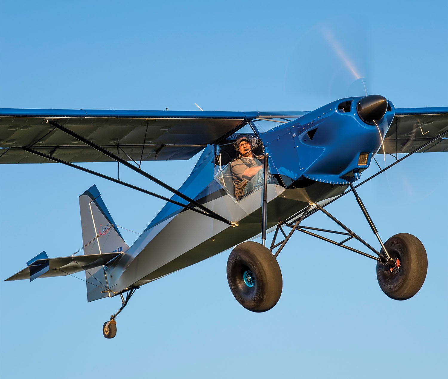

The third flight condition/configuration we need to check is takeoff and initial climb. This rarely sizes the wing, but we do need to be mindful of both maximum lift and drag of the wing in takeoff configuration.
Just STOL XL Titan VanderMeulen RV41982
The third flight condition we need to check is takeoff and initial climb. Once the airplane lifts off, it must be able to climb away and clear obstacles. (Photo: Richard VanderMeulen)
The CLMAX of the wing in takeoff configuration and the wing loading define the stall speed in that configuration. That stall speed in turn is one of the major parameters determining takeoff distance. It’s rare that takeoff distance sizes the wing, particularly if the wing is sized to meet stall speed requirements in landing configuration, but it does happen, particularly for an airplane with a purely cruise-optimized wing.
Drag is also important because of climb performance. Once the airplane lifts off, it must be able to climb away and clear obstacles.
As with landing, it is important to do the evaluation with the flaps in the proper configuration. Most single-engine airplanes take off with the flaps up because they have acceptable takeoff distance and lower drag in this configuration.
Higher-wing-loading airplanes, or airplanes with extremely short takeoff distance requirements, may take off with some flap deflection to reduce liftoff speed and takeoff roll. For these airplanes, the wing design and airfoil choice should be evaluated with the flaps in the nominal takeoff position.
