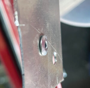

Rivet
A rivet set into a hole that was not deburred. Note that the head does not sit perfectly flat. If the burr should ever crush or break off, the rivet will become a little loose.
Life would be so much simpler if the act of drilling a hole in a piece of metal left nothing but a clean hole. Unfortunately, the reality is that most drilled holes possess a ragged ridge around their edge. The reasons for the creation of this ridge are numerous and can be controlled to an extent. This raised area around the hole is also known as a burr and is easily seen in the photo (note the smaller hole). The act of deburring is the removal of this ridge and any other irregularities in that area. But why is it so important to remove this ridge? How can it possibly do our aircraft any harm?
The holes we create will generally be filled with a fastener such as a rivet or bolt. We generally want our fasteners to stay tight for the life of our aircraft! The burr that is left after drilling a hole will keep the head of the bolt or rivet from contacting the metal surface—almost like a crude washer. But unlike a washer, the burr is not a solid or consistently formed spacer. It will crush when setting the rivet or tightening the bolt. There will be no solid grip between the fastener head and surface of the metal. Eventually, this burr may break and fall out. This leaves the fastener just a little loose! You could tighten a loose bolt—but a rivet has no retightening feature so it will forever be loose. Not a good thing for an airplane structure. If only a couple of rivets are a tiny bit loose, it is probably not a major concern. However, if you never deburr any holes then potentially there might be thousands of rivets that are not holding things as tight as they could or should. The bottom line is that we want the head of our fasteners to be tight against their holding surfaces. Only a hole with no burrs or ridges fits this requirement.

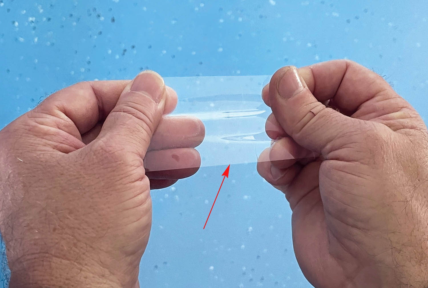

Another potential problem we want to avoid is crack propagation. What is that? My favorite analogy to understand how insidious this action can be is to take a piece of clear packing tape between your fingers as shown in the picture. Pull as hard as you can—you may not have the strength to tear it apart. Then place a tiny, tiny nick on the edge of the tape with a pair of scissors, for example. Pull again. This time, without effort, the tape breaks into two pieces as the tiny nick propagates into a crack that travels all the way through the piece in your hands. It’s rather amazing how the immense strength of the tape is quickly compromised with a tiny cut!
TapeEdge
As an example of what can happen to sheet metal that has a burr or other irregularity on its edge, create an extremely tiny cut at this location of the tape and see how a “crack” quickly forms and the sheet breaks apart.
The same is true with sheet metal. Any edge of the metal, whether the perimeter edge of a sheet or the edges that surround the inside of each and every hole in that sheet, has a potential location for a propagating crack. Jagged burrs can be thought of as tiny nicks that could propagate into a crack. This is why we need to deburr the perimeter edges of our metal sheets as well as every hole we drill. The vibrations and stresses imposed on our aircraft structures are not unlike you pulling on that packing tape. We don’t want a simple crack caused by an edge irregularity to undo all of our work!
