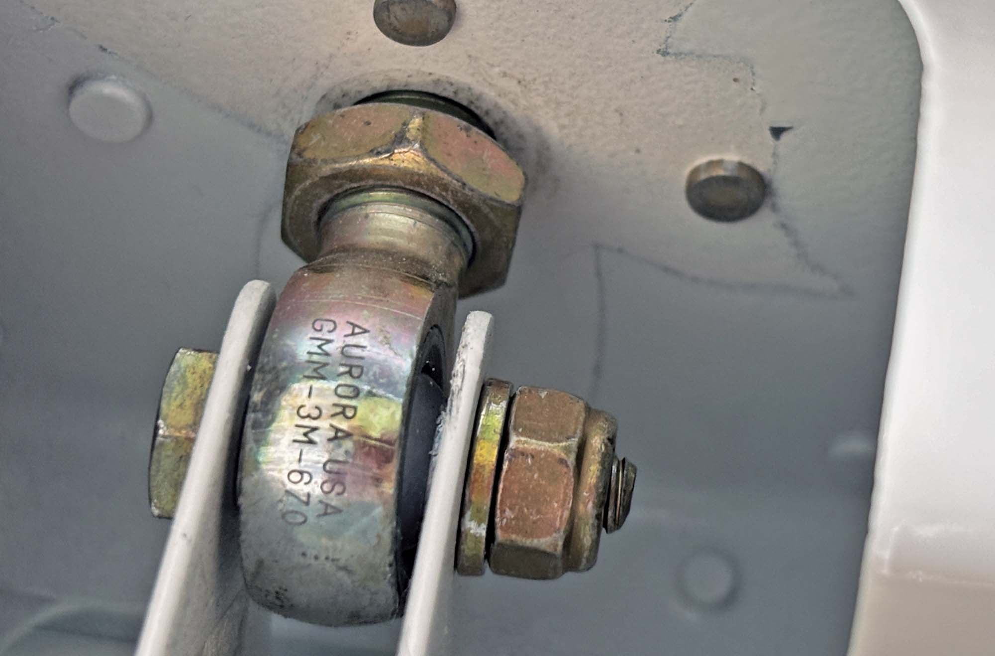

Rod ends are often used as hinges on RV-series aircraft. Be sure to tighten the jam nut!
One of the advantages of using rod ends for hinges is that it makes aligning the rotational axis easier since you can adjust the length (x-axis) of individual rod ends in order to achieve collinearity for the whole control surface. (It’s up to you get the z-axis correct!)
Since rod ends typically screw into a horizontal or vertical spar, the back side of which is often inaccessible, it is customary to use nut plates to secure the rod end. As Vic Syracuse has pointed out numerous times in his own articles, it is essential that a jam nut be incorporated in the rod end assembly as this not only helps prevent the rod end from loosening, but more importantly ensures that the rod end is primarily stressed in bending only from the point of the jam nut forward (minimizing stress on the rod end) and doesn’t transfer those bending loads to the nut plate.

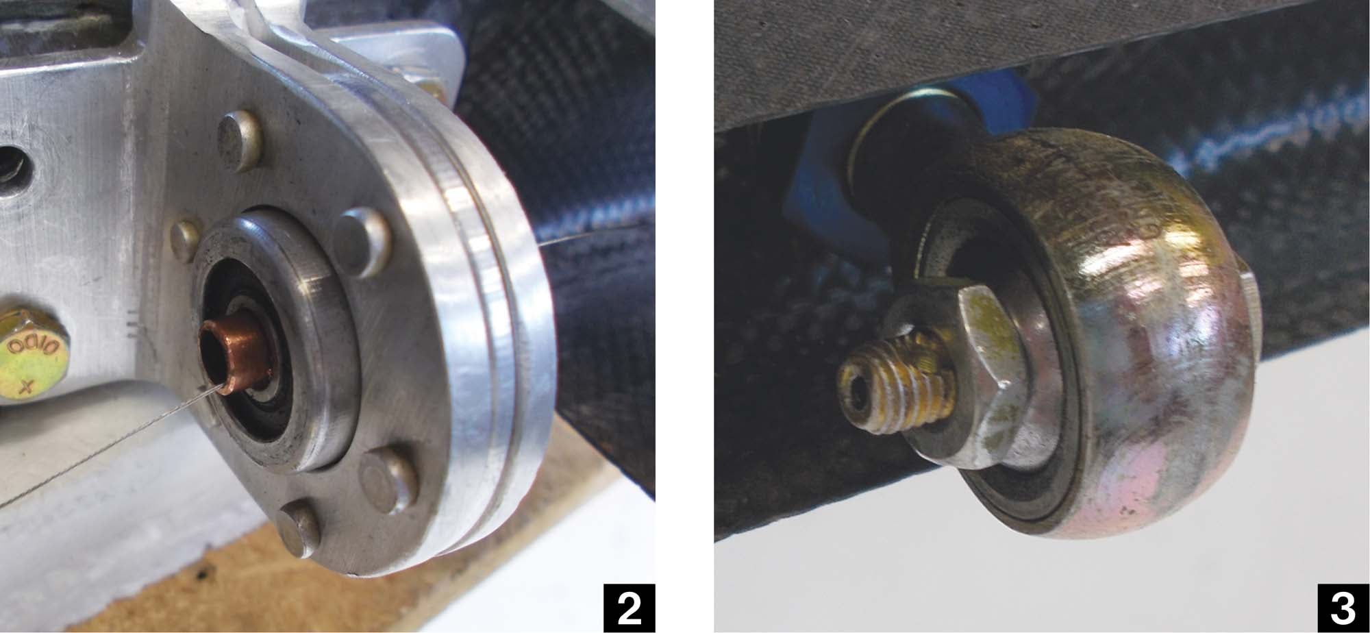

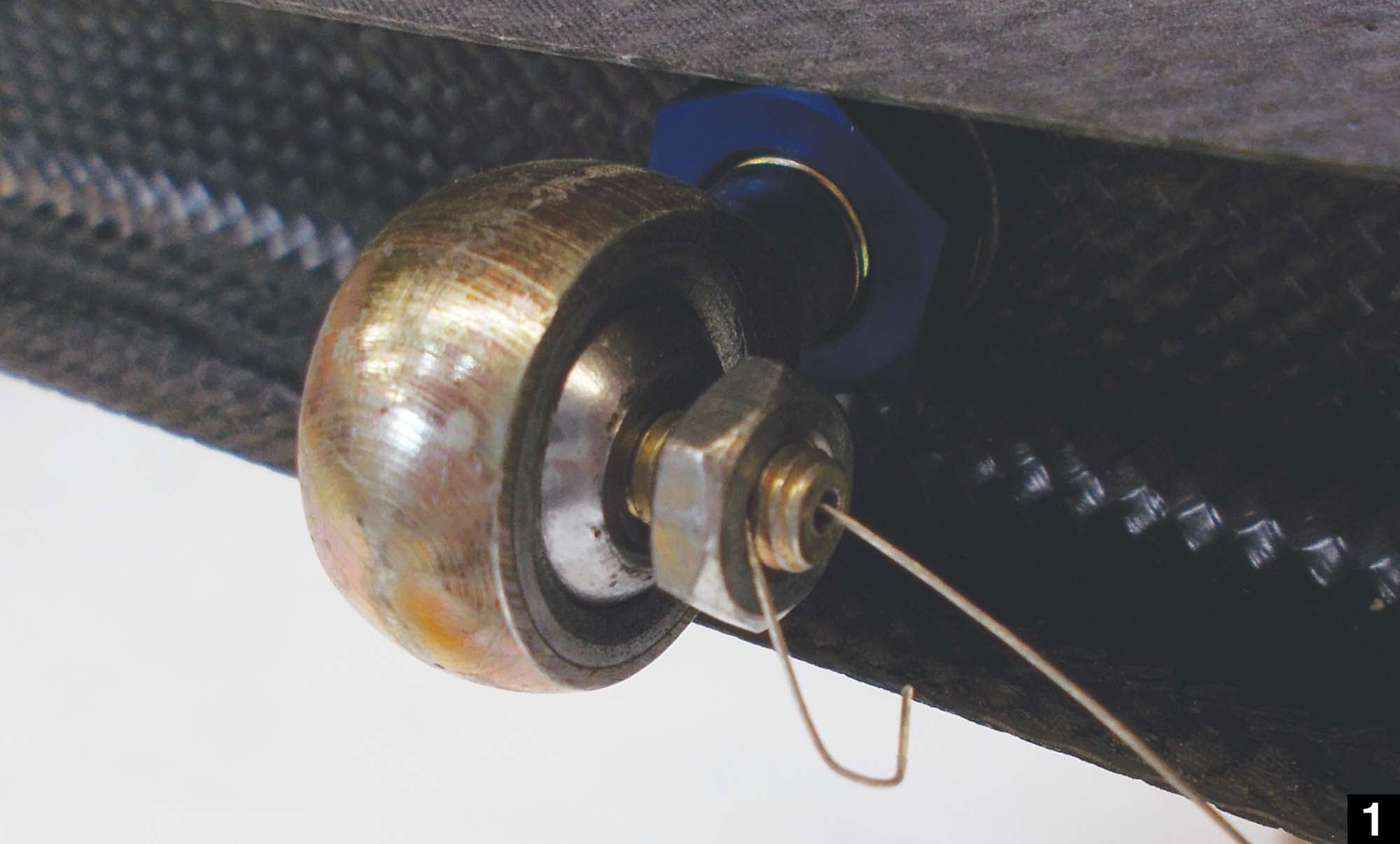

As noted earlier, one of the advantages of using rod ends as hinges is the ability to make sure the rotational axes of the rod ends are collinear. The next tool helps to establish this axis. It is comprised of a pair of drilled AN3 bolts (or whatever size bolt the rod end takes) that are also center drilled with a 1/16-inch or #40 bit.
For the end drilling operation, first file or belt sand the end of the bolt flat; otherwise the bit will wander. Clamp the bolt in your drill press and spot drill the end with a bit approximately the same diameter as the bolt, just enough to get the surface concave. This will prevent the smaller 1/16-inch bit from wandering. Go slow, using new bits and a small amount of WD-40 as cutting fluid to avoid breaking the bit.rod end installation tools 03
Step by Step
Follow these instructions and you should be able to establish a straight line through your rod ends.
1. Insert the first center-drilled bolt through the far left rod end and thread on a jam nut. Thread steel wire through the center of the bolt and out through the side hole, then (un)screw the jam nut until it holds the steel wire tight.
2. Run steel wire through the center of the rod ends and bearings.

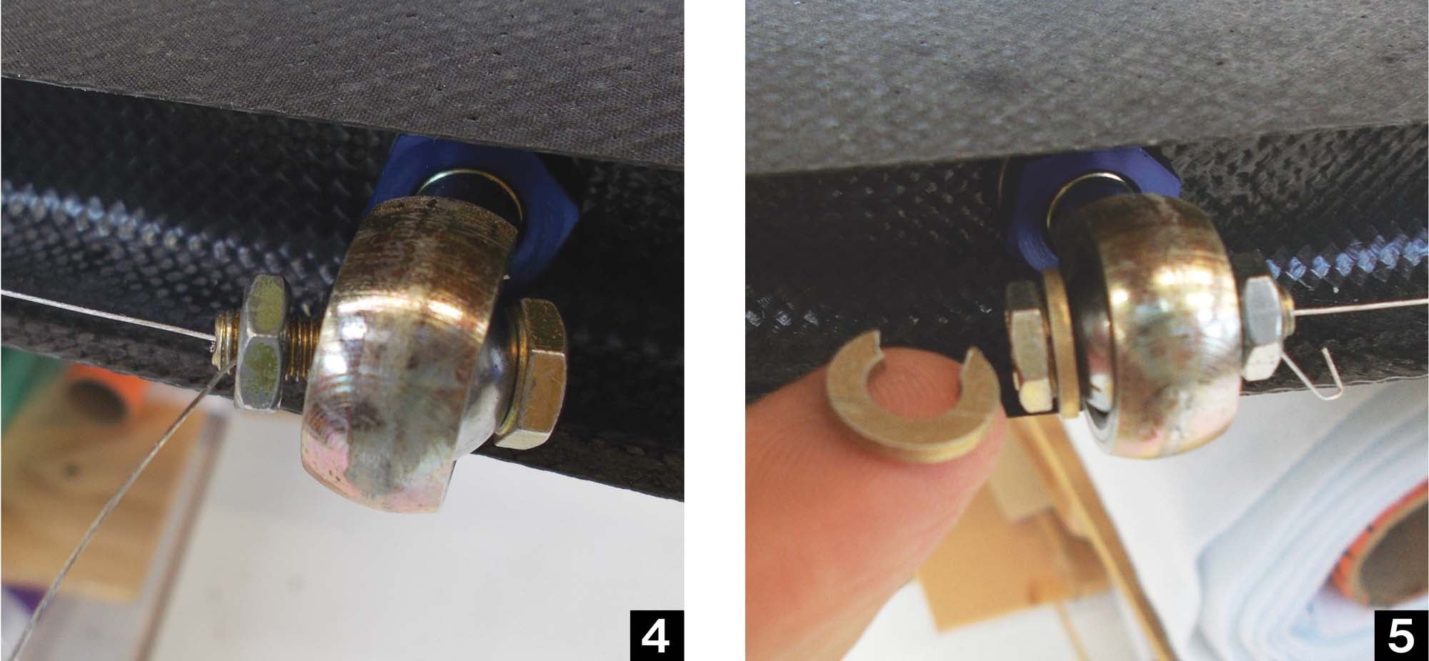

3. Prep the far right rod end with the other center-drilled bolt and jam nut.rod end installation tools 04
4. Pass steel wire through the bolt, pull as tight as possible by hand and tighten the jam nut to hold the wire in place.
5. To achieve maximum tension on the wire, spacer washers can be fabricated by slotting 0.062-inch-thick aluminum AN3 washers and inserting them between the head of the bolt and the ball of the rod end.

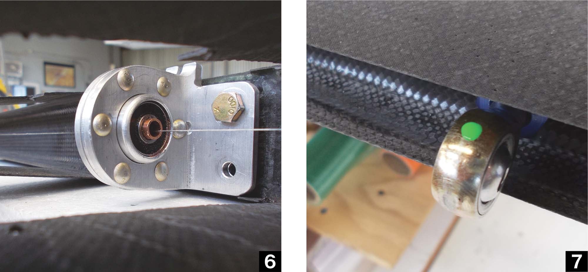

6. It’s difficult to tell from the oblique perspective, but the right ball end still needs to come out a half turn in order to center the wire in the middle bearing.rod end installation tools 05
7. Once the wire is perfectly centered, the rod ends are marked with a small dot of red (left/port) or green (right/starboard) nail polish to indicate the orientation (up or down) of the rod end in case it needs to come out. Again, once final assembly is finished, the jam nuts should be tightened and marked with nut lacquer or torque striping to indicate they have been final torqued. I also use red and green nail polish to differentiate between left and right parts that are otherwise identical looking. rod end installation tools 06
