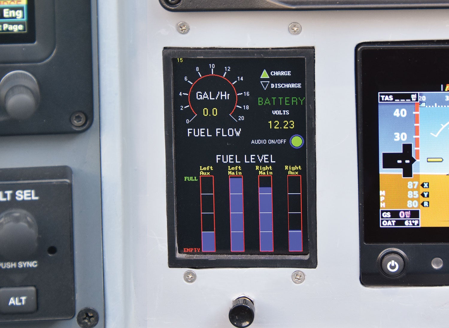

Development hardware includes: (1) the 3.5-inch color display, (2) the universal programing and I/O interface board, (3) a USB cable connecting to the development computer and (4) application-specific external circuitry (left). My display shows fuel flow, fuel level, battery information and includes an audio alert on/off indicator (right).
Hardware Design
My display items were four fuel-tank levels in vertical bar graph form and fuel flow in gallons per hour in a circular gauge. Battery voltage is shown, along with battery charge/discharge information, and there’s an audio alert on/off indicator. Take a look at the photo for a view of the completed display.

An aluminum housing contains the electronic components (left). The finished unit includes a bezel made out of black Corian (right).

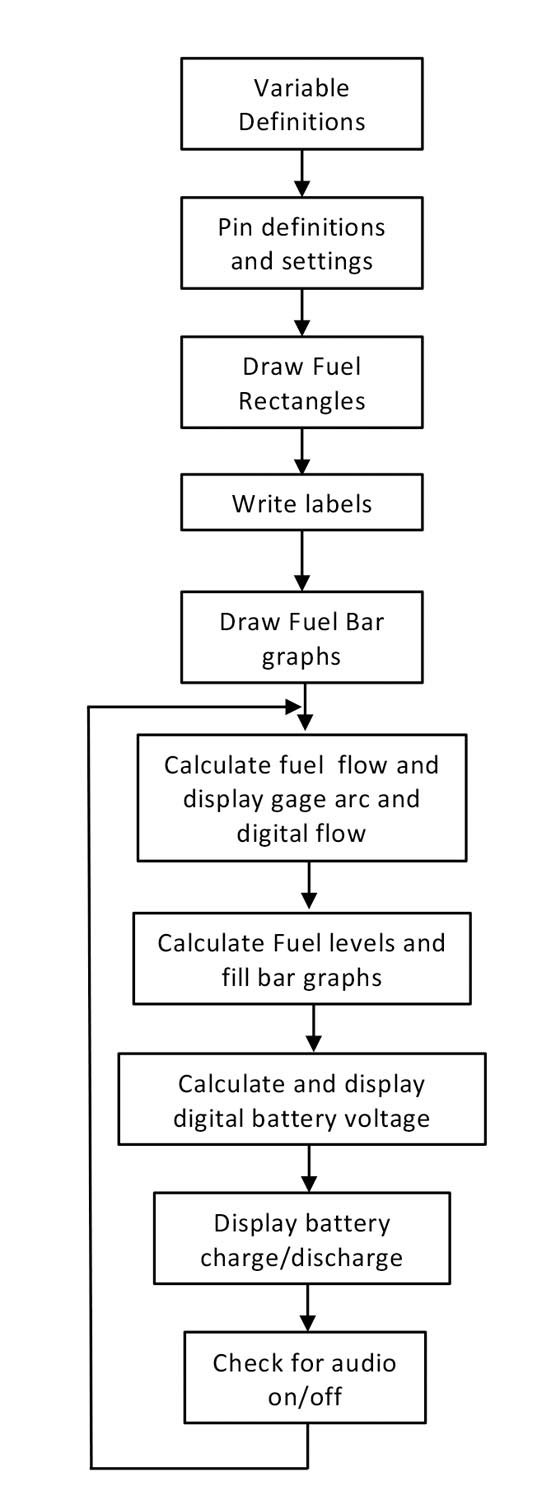

High-level firmware structure.
Take a look at the high-level block diagram of the firmware design. The actual code is here. In any case, the process of writing code is greatly simplified by the excellent 4D examples and extensive application notes organized by typical functions. Without going into the details of the entire firmware for this design, let’s examine a couple of the pieces of the design to see how simple it is to create a display.
The fuel tank graphic consists of four vertical rectangles, each having a red outline, three white separator bars and a blue fill for the level. Here’s what it takes to create the red outlines: In the Diablo16 code set there is a graphics instruction “gfx_Rectangle(x1, y1, x2, y2, colour).” (Yes, that’s how they spell color—remember, this is an Australian company!) You simply supply the coordinates of the lower left and upper right corner and color code for the desired rectangle and, voilà, it’s done. So, for the outline of the four fuel gauges there are four such instructions. Of course, you need to do a bit of homework to figure out those rectangle coordinates in terms of where they should end up in the 320×480 pixel display. But the development environment makes this super easy, as you can write code, load it into your display in seconds and see what you’ve got, and interactively modify and incrementally grow your code base one piece at a time.
Similarly, the fuel flow gauge semi-circular red line is created with one simple “gfx_RingSegment(x, y, Rad1, Rad2, starta, enda, colour)” instruction, in which you supply an x-y center coordinate, an inner and outer radius, a start angle, an end angle and a color. This is an example of the richness of graphics instructions available to let you do just about anything for your desired display look—and also an example, once you get the hang of it, of the simplicity of creating graphics on these displays. Text creation is also simple: a location instruction, followed by an instruction that includes the text, font, size and color. And just like that, it appears on the screen.

  1. Do you have a rating of the display brightness? Most graphic displays I have used are not daylight readable. For a trim indicator, I finally went with an e-paper display but their update rate is measured in seconds!
    • I have encountered the same issue and found e-paper to be slow and also wanted backlighting – one solution I tried was using dual OLED displays side-by-side. That worked but still, there are some issues/limitations with that. I am also investigating a couple of daylight-readable TFT displays I was able to find. The biggest issue is keeping the cost down on these types of displays! Another problem is getting something I can integrate into – I prefer to use an ESP32 and do not want my display to use every IO I have.
  2. You are right, this display is not as bright as my Garmin screens, and when hit with direct sunlight I usually end up holding my hand to shade when I want to read it, and without direct sun, it is a bit dim, but readable. I mounted this a bit low on the panel, which helps. At night, it is perfect!
