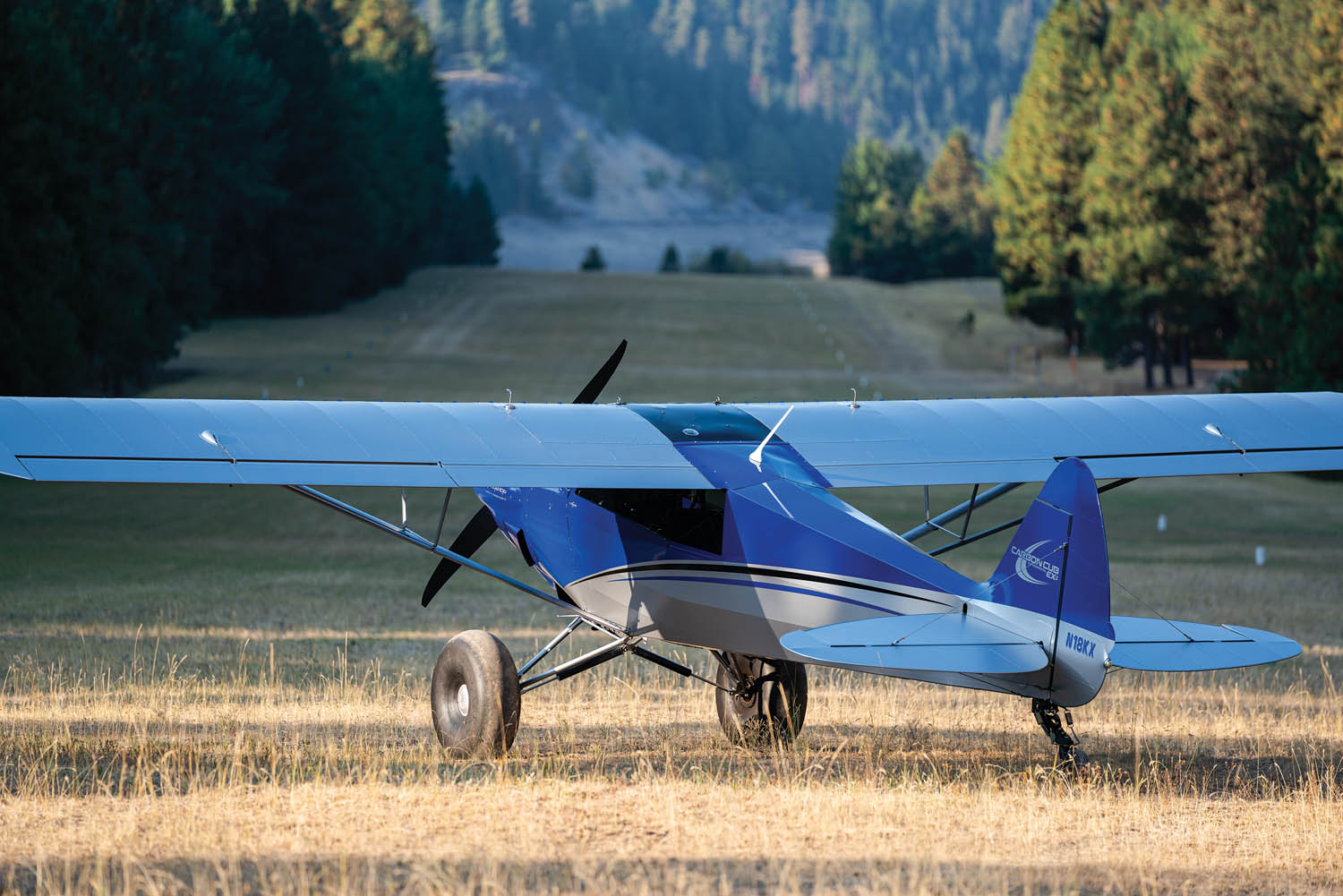

CubCrafters EX 2 363i 01Product development has many mothers. Sometimes you create a new airplane for a particular set of missions. Sometimes you take that design and tweak it based on customer feedback, advances in manufacturing capability or simply to crank up your market share and get your brand some juicy press coverage. And sometimes necessity is the driver.
The curious case of the CubCrafters EX-2 CC363i project derives from the latter influences. Originally built with a carbureted O-340 and a fixed-pitch prop, the EX-2 has long been the “step up” aircraft from the LSA-compliant SS. It slots in below the EX/FX-3 in weight and power. Think of the EX-2 as the Honda Accord with the four-cylinder and the EX-3 as much the same car with the sweet-sounding V-6.
Back to the EX-2, then. All was going well with the EX-2, sales-wise. Same for its FX-2 sibling, which makes this a good time to unravel the EX and FX nomenclature. Simply put, both are Experimental/Amateur-Built aircraft. The EX was designed to be shipped out and built at home, whether that home is your garage or airport hangar. The FX is the very same airplane but it goes through CubCrafters’ unique builder-assist program. A bit of further background here: Eligibility for the FAA National Kit Evaluation Team (NKET) program includes proof that the kit itself does not intrude on the builder doing the “major portion” of the work. The NKET checklist is broken down by tasks, where builders are given credit for both assembly and fabrication, and that credit is broken down to, say, fabricating a wing rib. It doesn’t say the builder has to fabricate all of them, so doing one gets the builder credit for all.
