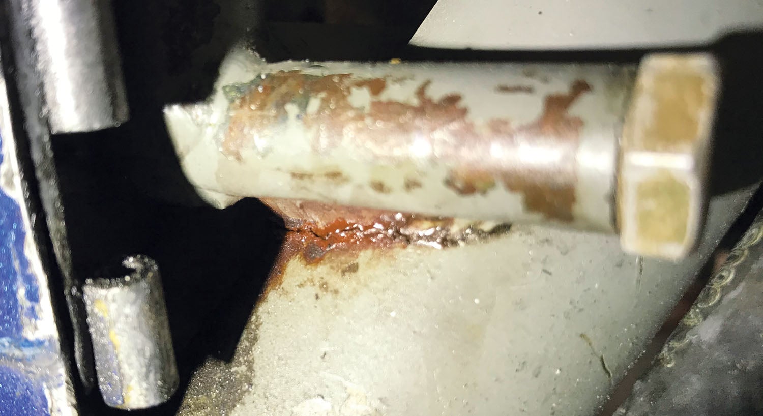

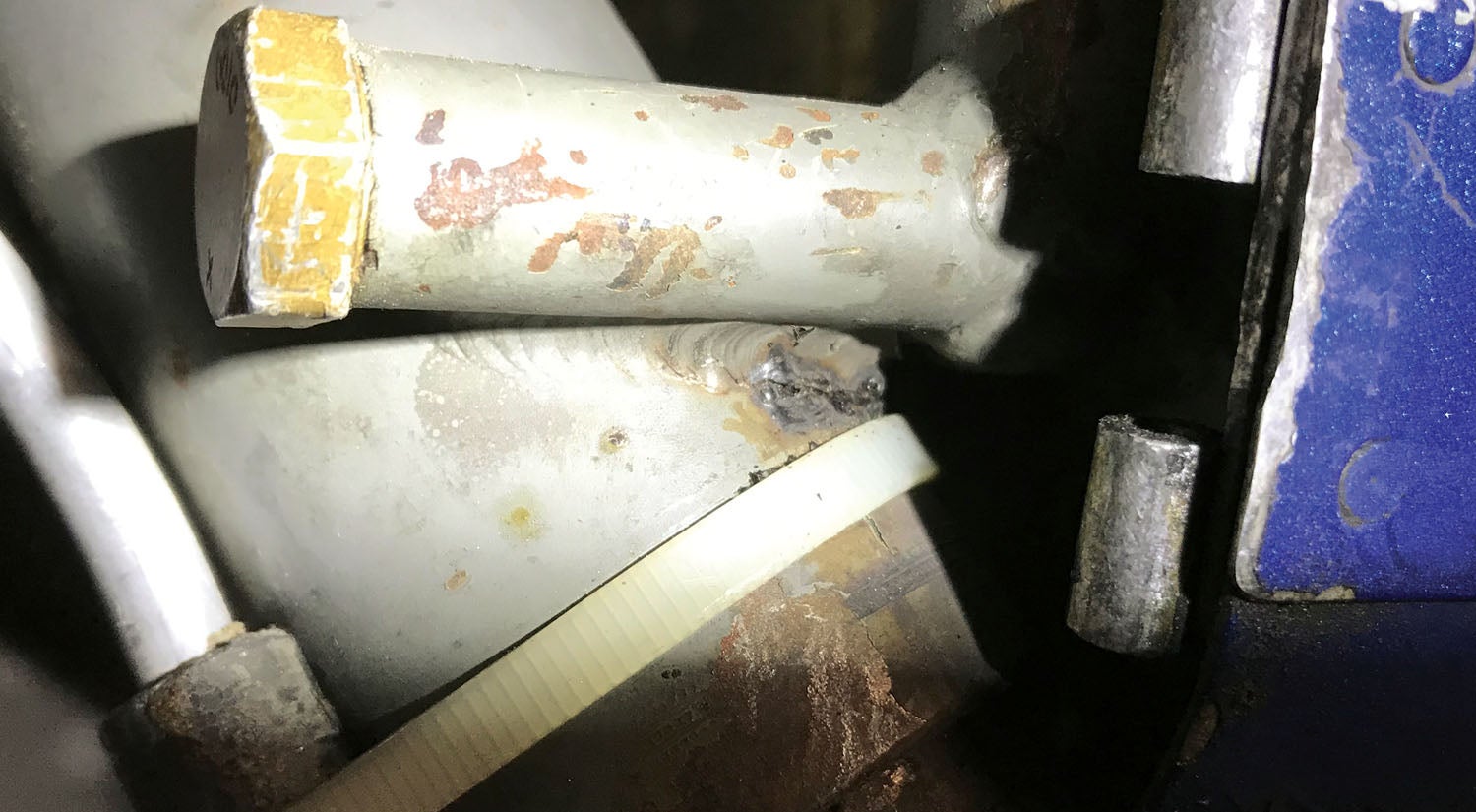

The crack on the port side was more subtle but still suspicious, and when we ground off the paint, the crack was apparent.

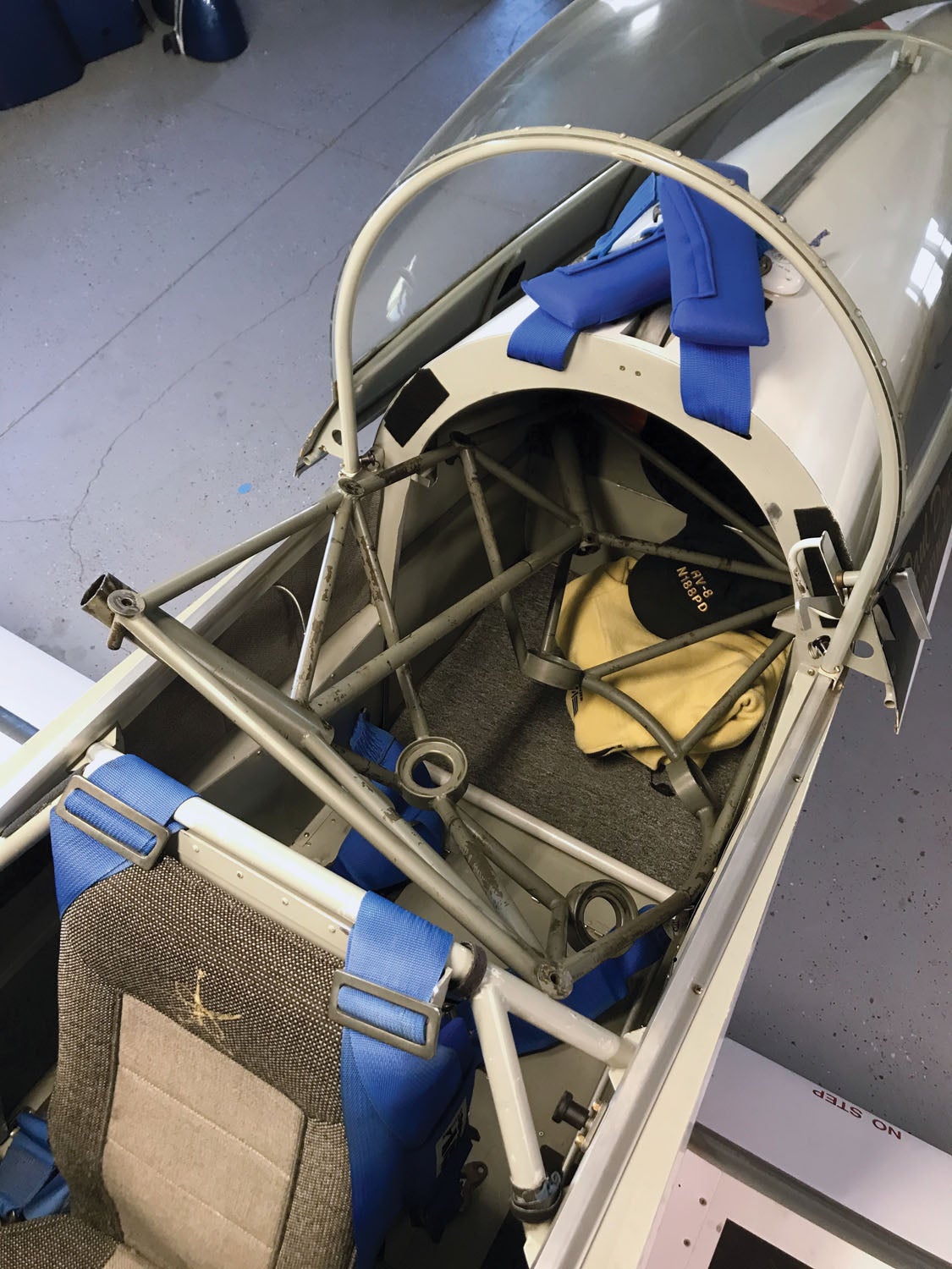

The RV-6 Motor Mount
Like most of the RV line of taildraggers, the RV-6 features a motor mount that also serves as the anchor point for the main gear legs. This is a very common design solution that simplifies overall structure and puts all the heavy loads in a substantial welded structure. The exception to this rule (in the RV world) is the RV-8, which features a more complex set of structural aluminum towers to mount the gear about a foot behind the firewall. It’s a solution to a CG challenge, basically, but it’s unique to that model, so let’s concentrate on the RV-6, the first side-by-side two seater to come out of the prolific Oregon design factory known as Van’s Aircraft.

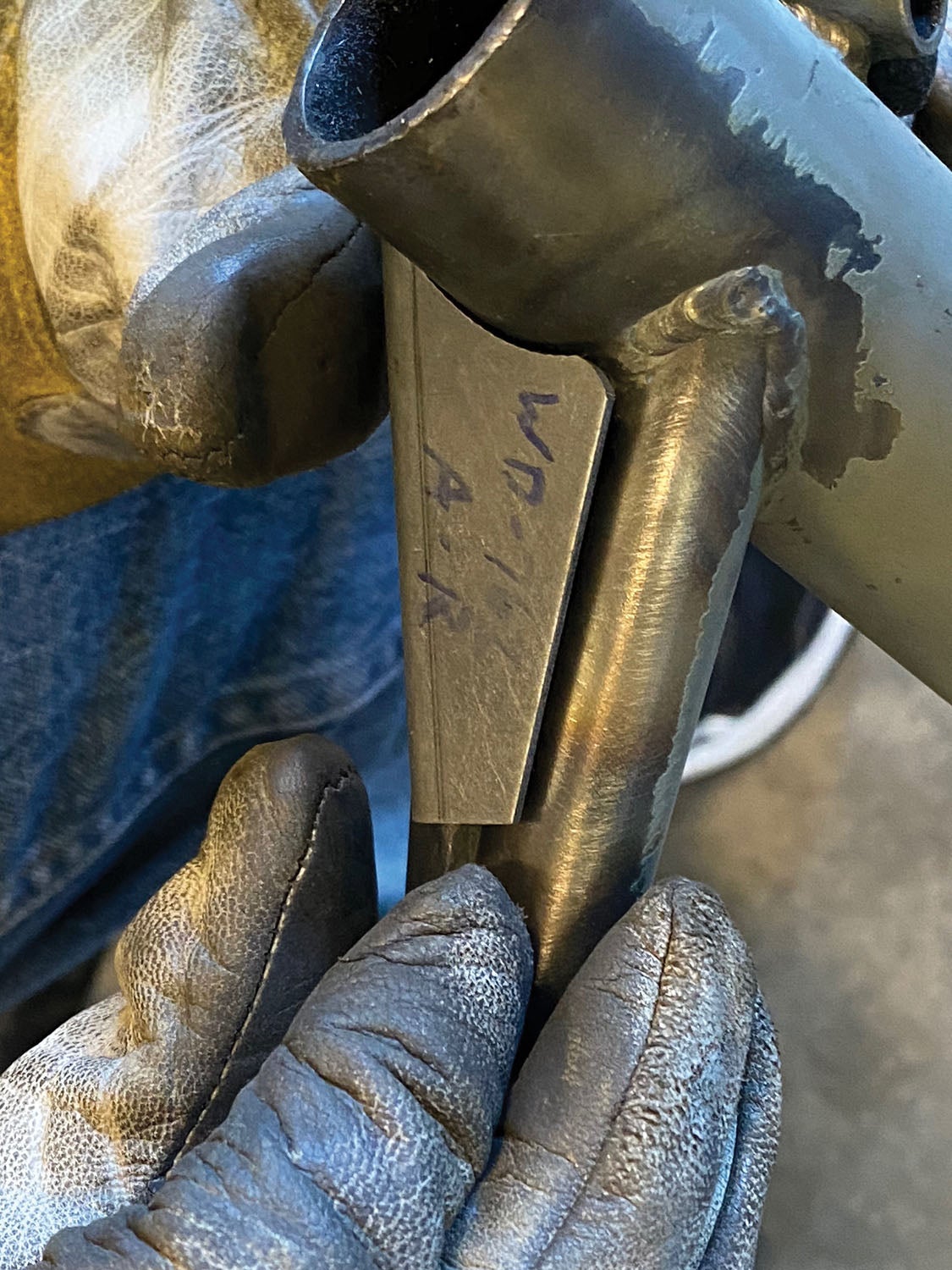

The gussets come from Van’s and each one has to be custom fit to the mount before it is welded in place. No two mounts are identical because of the welding, and
these are actually RV-7 parts.
A fix was developed using additional welded gussets when the RV-7 came along, and these gussets have been used to reinforce RV-6 mounts ever since. When one needs to be repaired (and they don’t all develop cracks), the gussets are usually added and the problem is solved. Many builders still working on RV-6s have added the gussets proactively as it is a well-accepted fact that they work, so why not put them on and avoid cracks later on? So there is a mixed fleet of original no-gusset airplanes with no cracks, original airplanes with cracks that have been fixed (with or without gussets) and airplanes whose mounts were reinforced with gussets before they ever flew. We haven’t heard of any gusseted mounts that have cracked or ones that have cracked after being properly repaired; the fix seems to be a good one.

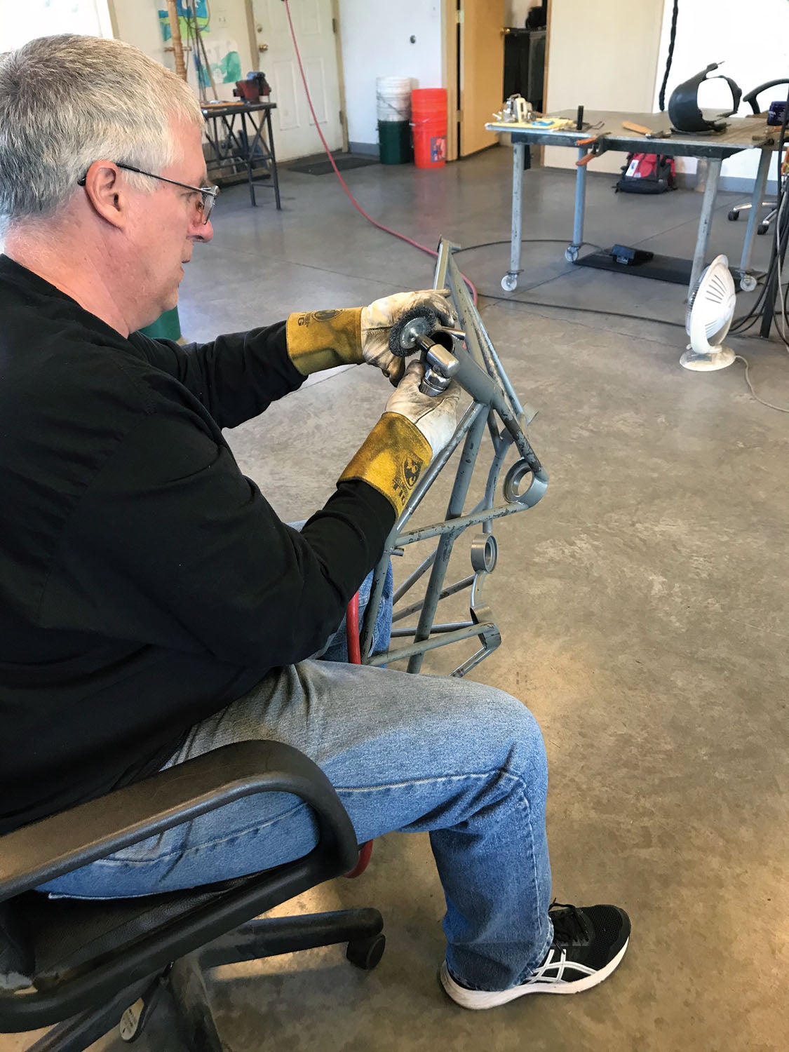

The first step at the welding shop was cleaning with a wire wheel to get all of the paint off and expose the bare metal.

Considering that removing the mount took the better part of a day for two people, the repair itself was almost anticlimactic (which is sort of the point). Russ met us at his local airport, and we made our way to his shop with the engine mount tossed in the back of his SUV. Once in the shop, he took a wire wheel to the parts of the mount where he was going to weld, then put on the helmet and fixed the cracks. Next he carefully tweaked the premade gussets he had obtained from Van’s until they fit perfectly, then donned the helmet again for another 10 minutes of careful welding. And that was that. Of course, Russ is an experienced welder who works on this stuff every day—and his work reflects that. For those of us who have demonstrated nothing more than the ability to make a puddle of metal with a welding rig, the repair seems daunting. But that is why we have experts available to us in just about every facet of airplane construction.

With the paint removed from the joint, a crack was visible in the gear leg tube itself.

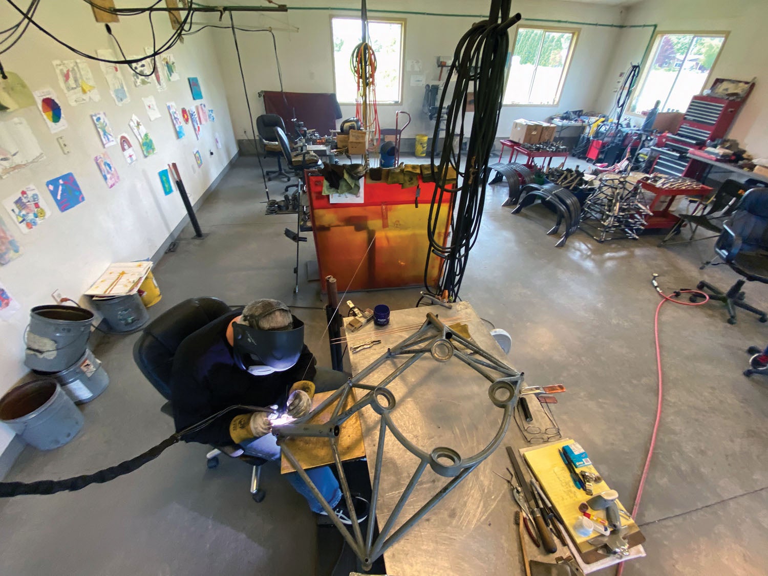

It was interesting using the same welder who had worked on the airplane previously, but we’re still mystified by the fact that once he saw the mount, Russ said that this was not the same one he had reinforced before. Logbooks in Experimental aviation can be a hit-and-miss proposition, but putting together the clues we do have, it appears that it was changed when the second owner had an off-runway excursion.
IMG 6628 1
The Master welder at work! Russ McCutcheon makes this look easy, but he’s been doing it all his life. It is far quicker (and probably cheaper) to hire a pro for a weld repair than it is to learn enough welding to do it yourself.

With the fresh welds in place, it was time to fit the reinforcing gusset (left). The gusset is formed from sheet steel and welded in place to make sure this mount never has to come off for cracks again (right).
