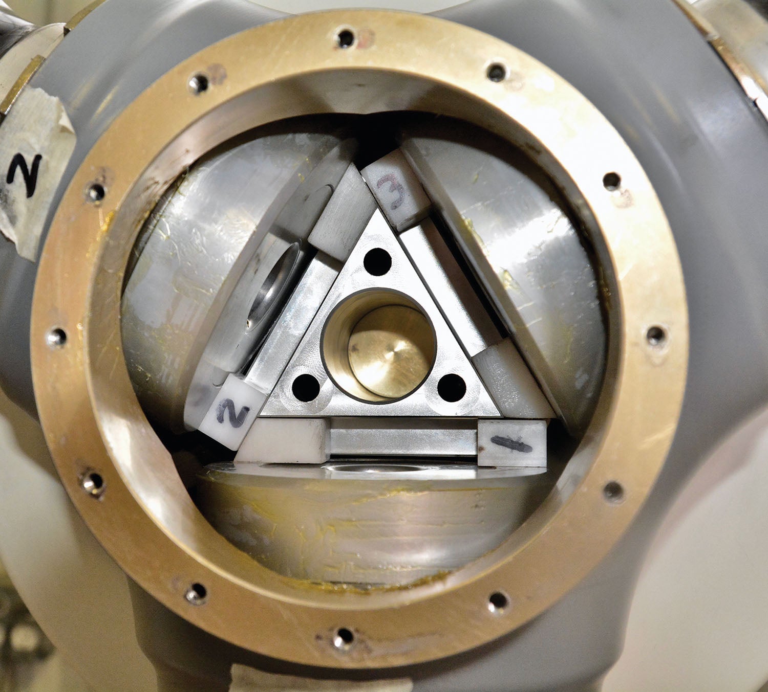

In the three-blade Whirl Wind hub, the piston pushes forward on a triangular spacer. The spacer sits just inside the ends of the three blade ferrules, and each ferrule has a hefty pin sticking out of it. A Delrin block is placed on the pin and rests against the forward face of the spacer. When the piston pushes the spacer forward, the Delrin block is forced forward, carrying the pin with it and thereby changing the blade pitch.
Since the pin is not actually moving in a straight line—it is moving in a curve, and the Delrin block slides along the face of the spacer—the spacer actually has a ledge machined into it, creating a channel for the block. The spacer looks more complicated than it has to be for this simple function—it also has a groove on each face for the pin to slide into. This is used only for assembly, however, to allow the spacer to slide in place past the pins. In operation, the slot doesn’t come into play. In order to make absolutely certain that the pin can’t find its way into the assembly channel in operation, a second Delrin block fits over the channel for each blade, plugging it up.

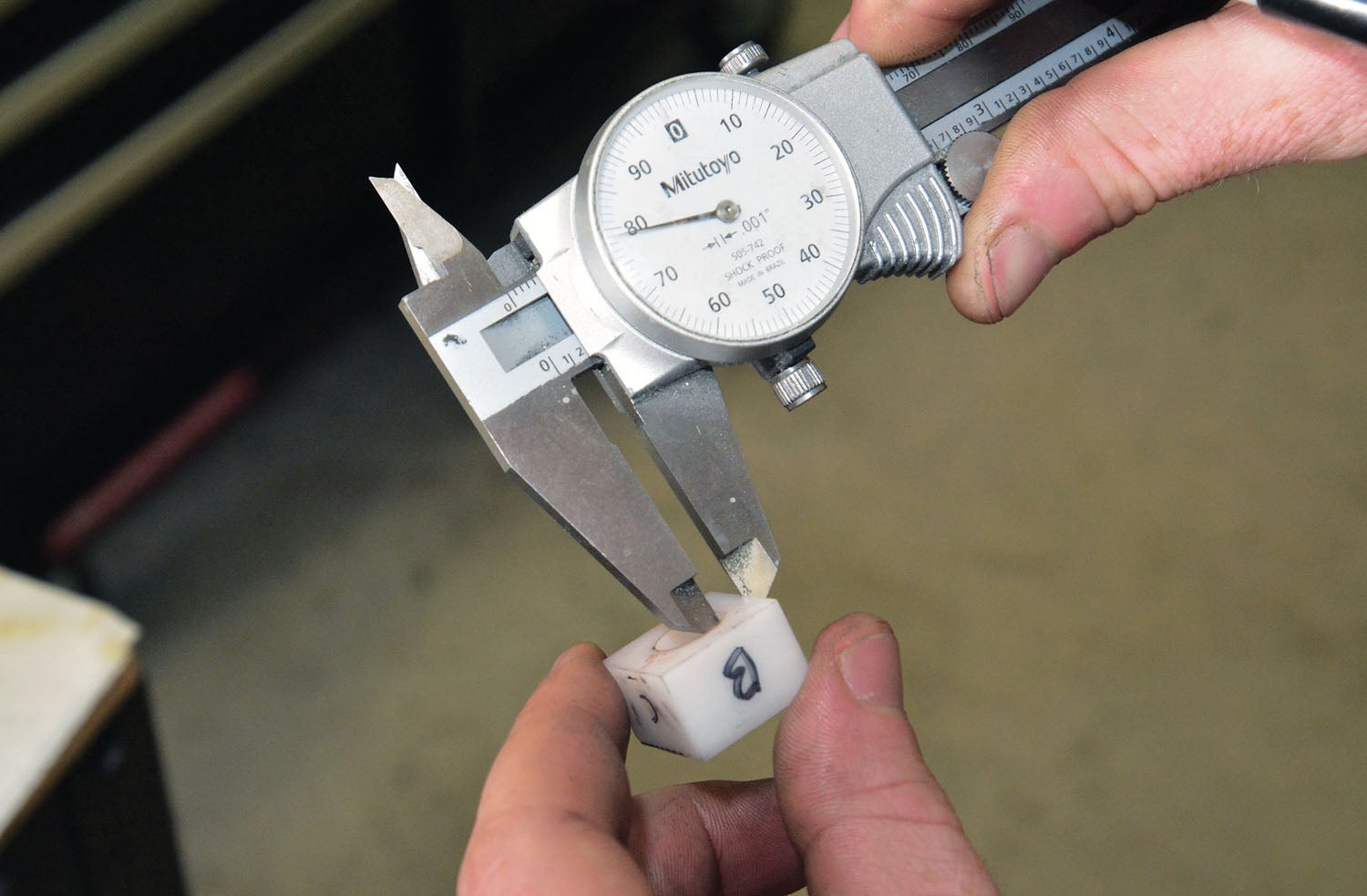

So how do you make sure that all the blades match perfectly? The little Delrin blocks that fit on the hub pins are drilled slightly off-center. Instead of the hole being exactly off center, it is offset so that if you place the block in one of four orientations, it is nominal. In the next position, it is 0.005 inch off. Turn it again, and it is 0.010 inch off, and the fourth face gives you 0.015 inch off. This adjustment range is enough to perfectly match the blades to each other, accounting for the possible range of manufacturing tolerances.

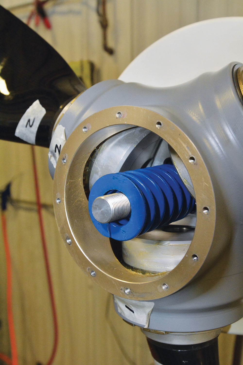

Once the prop is mounted to the stand, the blades and blade ports are numbered (for identification), and the front cover is removed. This involves removing the big nut that acts as the low pitch stop, and a dozen perimeter bolts. This is followed by removing the big spring, spindle and plunger. Next, the blades are manually rotated so that the actuator blocks can be removed, followed by the Delrin blocks that plug the spacer/plunger slots. The blade pins are lined up with the slots, and the plunger comes straight out.
