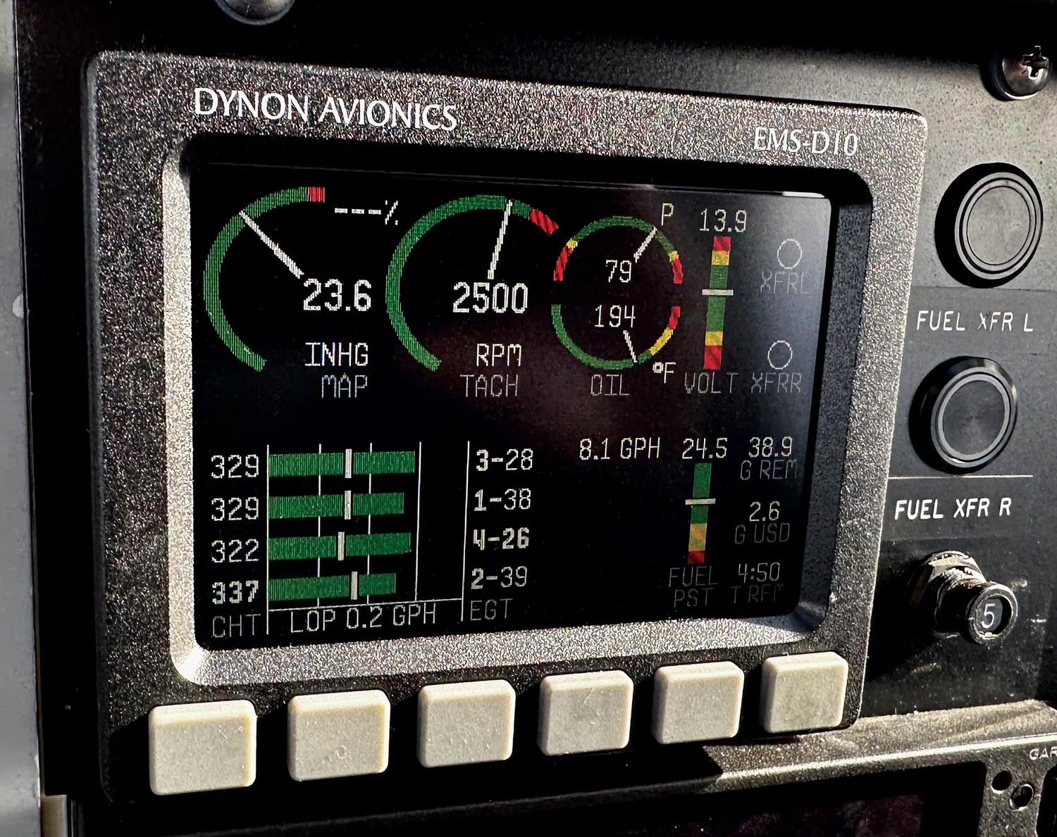

EIS data
Look to your engine instruments for verification of what you see and feel, as well as for corresponding relationships. If the oil pressure reads low, has oil temp begun to rise?

Let’s take a look at something a little more serious—oil pressure. You can’t hear oil pressure and the only way to tell if you really have it is via some sort of gauge or pressure switch. Most certified aircraft simply have a gauge—a single source of data. Those with advanced avionics might have software that reads the pressure and if it falls below a preset limit will turn on a light to get your attention. But in the Experimental world, you can add anything you want—and a very simple pressure switch is an easy addition. Wire this up to a light in the cockpit, and you now have the ability to independently confirm or deny the information given to you by the pressure gauge.
Yes, I can hear you saying that a man with two watches never knows what time it is! Well, this is true in principle, but if the man knows that it is daytime and one watch says it is noon while the other says it is 3 a.m., he has a way to pick between the two. Likewise, if your engine has been running fine, and the oil pressure light comes on—the pilot can check the gauge to see if it has changed. Unless you have had two independent, dissimilar yet simultaneous failures, it is quite likely that the engine’s oil pressure is doing just fine. A quick check of oil temperature should add additional data to tell you if things are heating up from a lack of oil (and oil pressure) or not. While these indications are sometimes slow to manifest, they almost always follow each other. Loss of oil pressure leads to rising oil temperature. (Yes, no oil in the engine can show low temperature but by the time that happens the grinding noises from ahead of the firewall will be a more prominent clue.)
Many years ago, we had no EGT gauges in light airplane cockpits, then we got single-point gauges. We could lean until the needle peaked and that would give us some idea how we were doing toward optimizing fuel flow. Next came all-cylinder gauges with a probe for each exhaust port and we learned that maybe we didn’t know as much as we thought from that single probe and gauge. Unfortunately, some folks have always flown with the all-cylinder EGT systems and have never had to simply have faith in the engine designers who say that for a normally aspirated engine, there is no such thing as too high of an EGT. The pilot sees a temperature and wants a limit—or they see a high value and get worried. For non-turbo engines there is no real limit. Instead, you should be looking for consistency from cylinder to cylinder and from day to day.
We teach flight test engineers some very basic interpretation skills that cover most types of transducer systems. A sudden drop-off (it is reading high, then reading low) is usually an indication of a transducer or instrumentation failure. Most temperatures or pressures simply can’t change that suddenly. A steady decline, however, is a good indication of a trending measurement that might be real—a leak, for instance. If your fuel gauge goes from 30 gallons to zero instantly, you probably didn’t rupture a tank, you probably broke a wire. If, on the other hand, you see a steady decline over time, you might very well have ruptured a hose.
