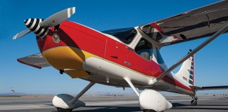

William Prokes’s Kitfox
N419BM is a Model 4 Kitfox with a Rotec radial engine (2800). It was completed almost three years ago, has 150 hours now and is a great airplane. The Rotec radial has run flawlessly.
Thanks to my wife, Teri, who is always encouraging me to fly more; work less. Teri loves this airplane, too. Thanks to Phil Laker who introduced me to the Kitfox and has shown me the way. Thanks to the McBeans of Kitfox Aircraft, too.
