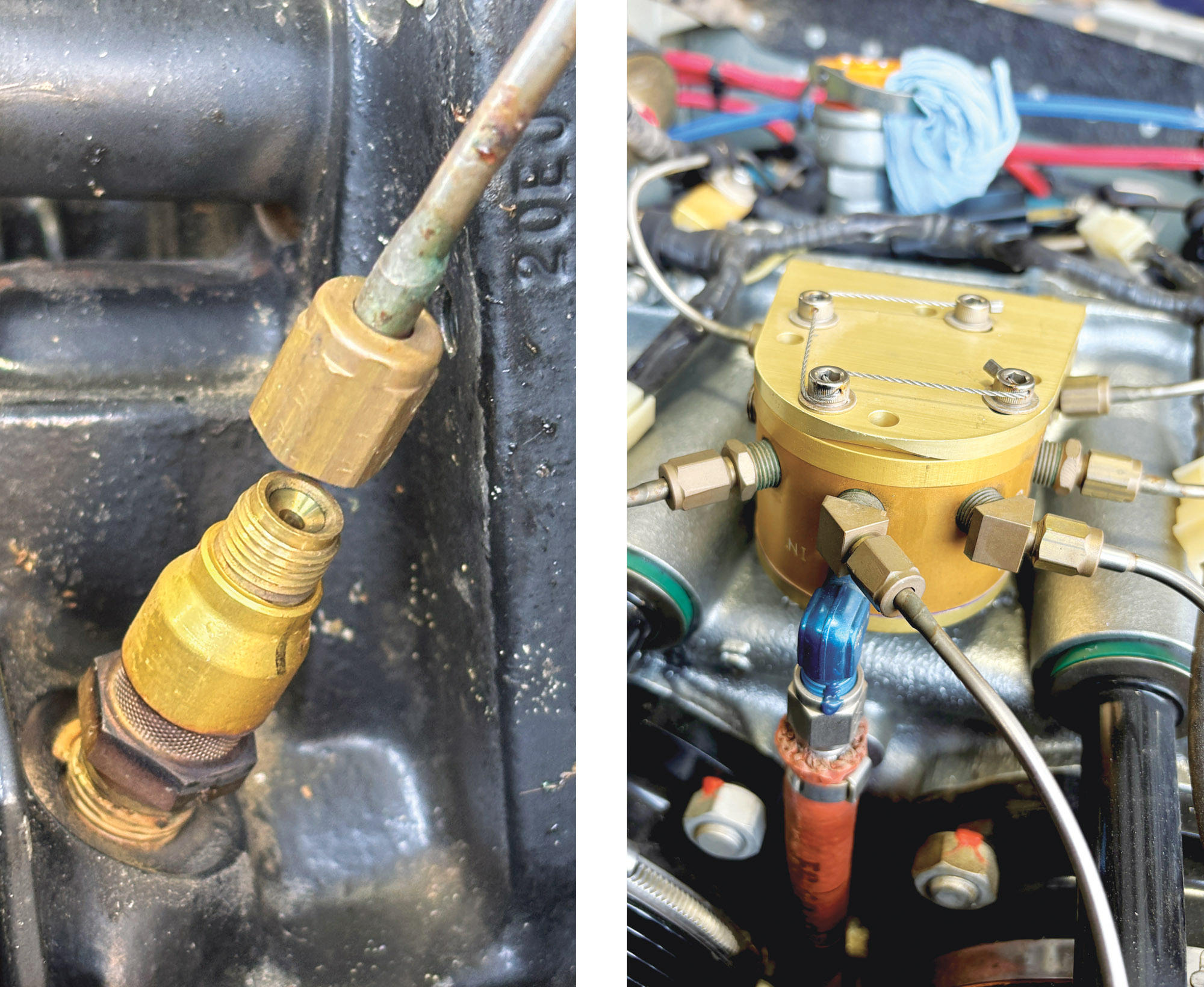

Broken, loose or cracked injector lines can cause very serious, life-threatening engine compartment fires. At full throttle, the fuel pressure in the injector lines can be upward of 25 psi and act like a blowtorch. At idle, with pressures at only 3 to 4 psi, you might miss the clue, thinking the rough-running engine is hot. Be sure to compare the EGTs across all of the cylinders.

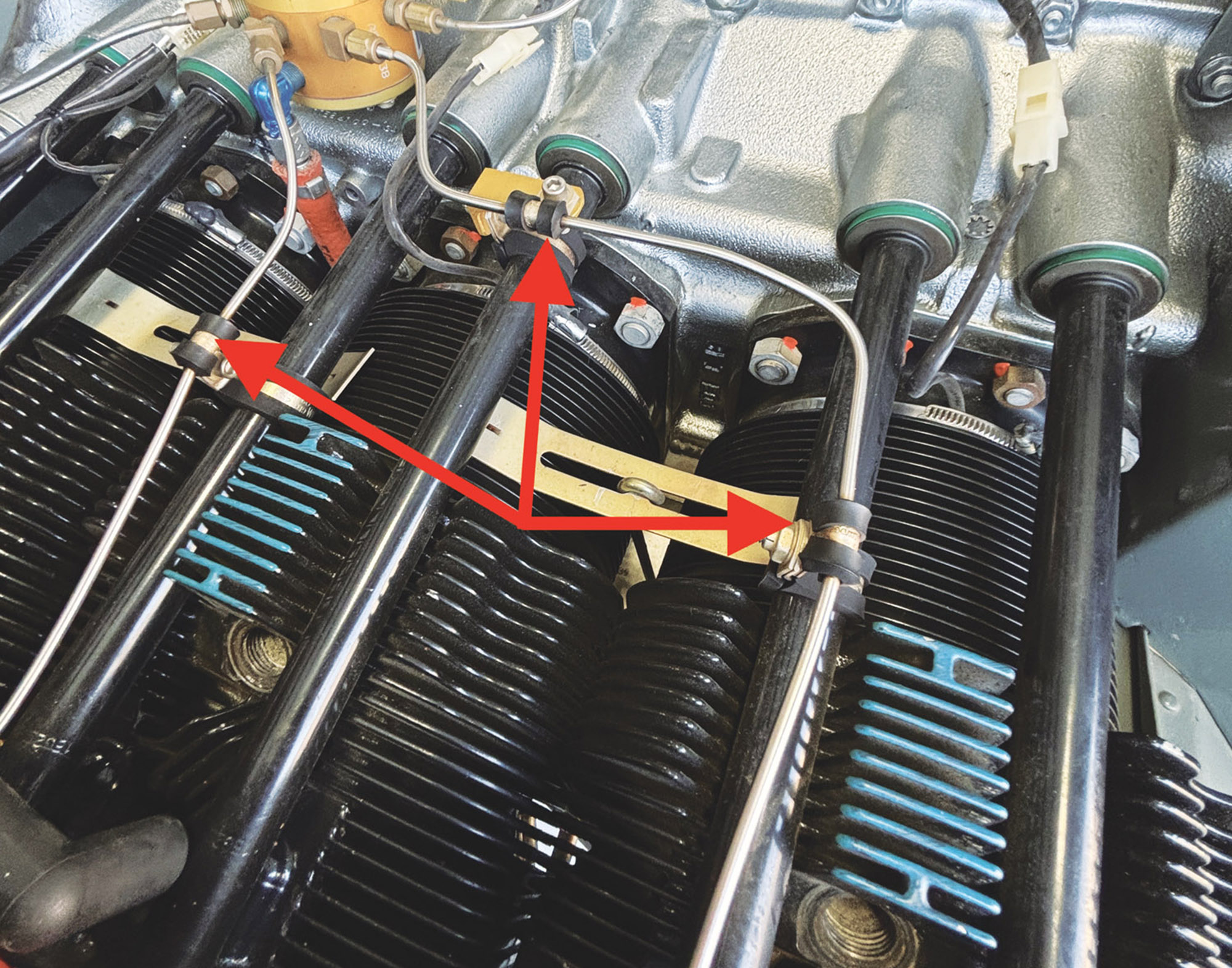

There is an AD that specifies the injector lines must be clamped/supported every 6 inches from the fuel distribution unit (spider) to the cylinder. Do not skimp on this. I have seen builders clamp them with zip ties, which is unacceptable. Use quality Adel clamps.

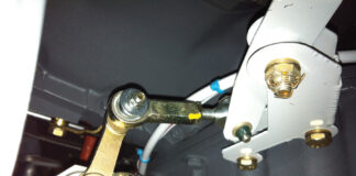

Although you have made the decision to seek out a landing spot, it doesn’t mean that you should stop troubleshooting. I had this happen to me in a friend’s RV-10. There was an unlabeled knob on the panel, and I had no clue as to its function, as turning it in either direction caused nothing to change in the cockpit. After leveling off I was presented with a rapidly climbing oil temperature indication. After I made a turn back to the airport, I did a rapid sweep of the cockpit, asking myself what I could have done. When I came to that knob, I immediately turned it completely in the other direction, and in less than a minute I saw the temps decreasing. Yes, we had a pointed discussion when I landed. It turns out the knob controlled a recently installed oil cooler valve.

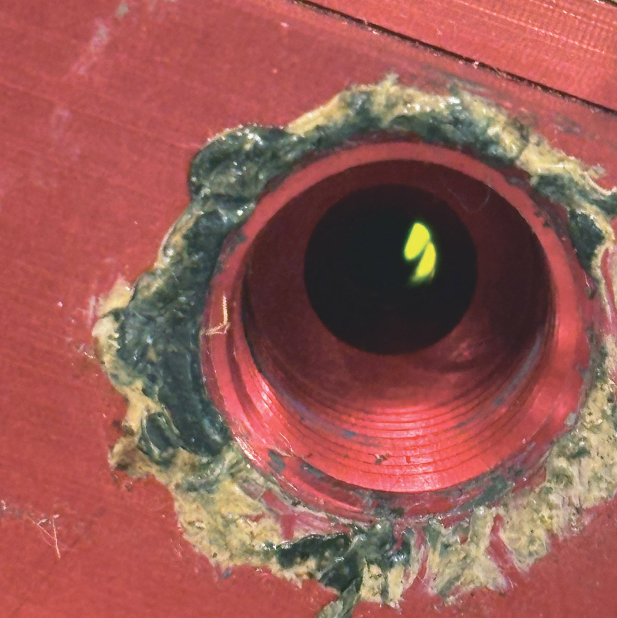

The hole in the fuel flow sensor is very tiny, as you can see here from the light shining through from the other end. It’s important to have a good filtration system in the fuel system, as it’s very easy for a small piece of rubber fuel line to affect the sensor or even block the fuel flow.
Most of the failures I have seen usually have the fuel flow indicating zero because the unit fails or something lodges in the sending unit. The fuel pressure gauge is a good cross-check for this one, but the best indication usually comes from your ears. If the engine continues to run normally, it’s probably an indication problem.
An abnormally high fuel flow indication is something that needs immediate attention but not necessarily a course of action until it is confirmed. It could very well be indicating that there is a fuel leak downstream of the sender, especially if the engine continues to run normally. A rough-running engine, coupled with high fuel flow, could indicate a broken injector line if the sending unit is between the fuel servo and the fuel distribution unit. This could be a very serious engine fire issue and needs to be dealt with immediately.
You can confirm this scenario if you have a multi-cylinder EGT/CHT gauge, as the affected cylinder should show a huge, rapid decrease in EGT and a decreasing CHT, although not quite as rapid. It is important to reduce power and set a course for a landing spot. Reducing power will reduce the pressure in the fuel lines to the cylinders, hopefully decreasing the fuel spray from the broken injector line.

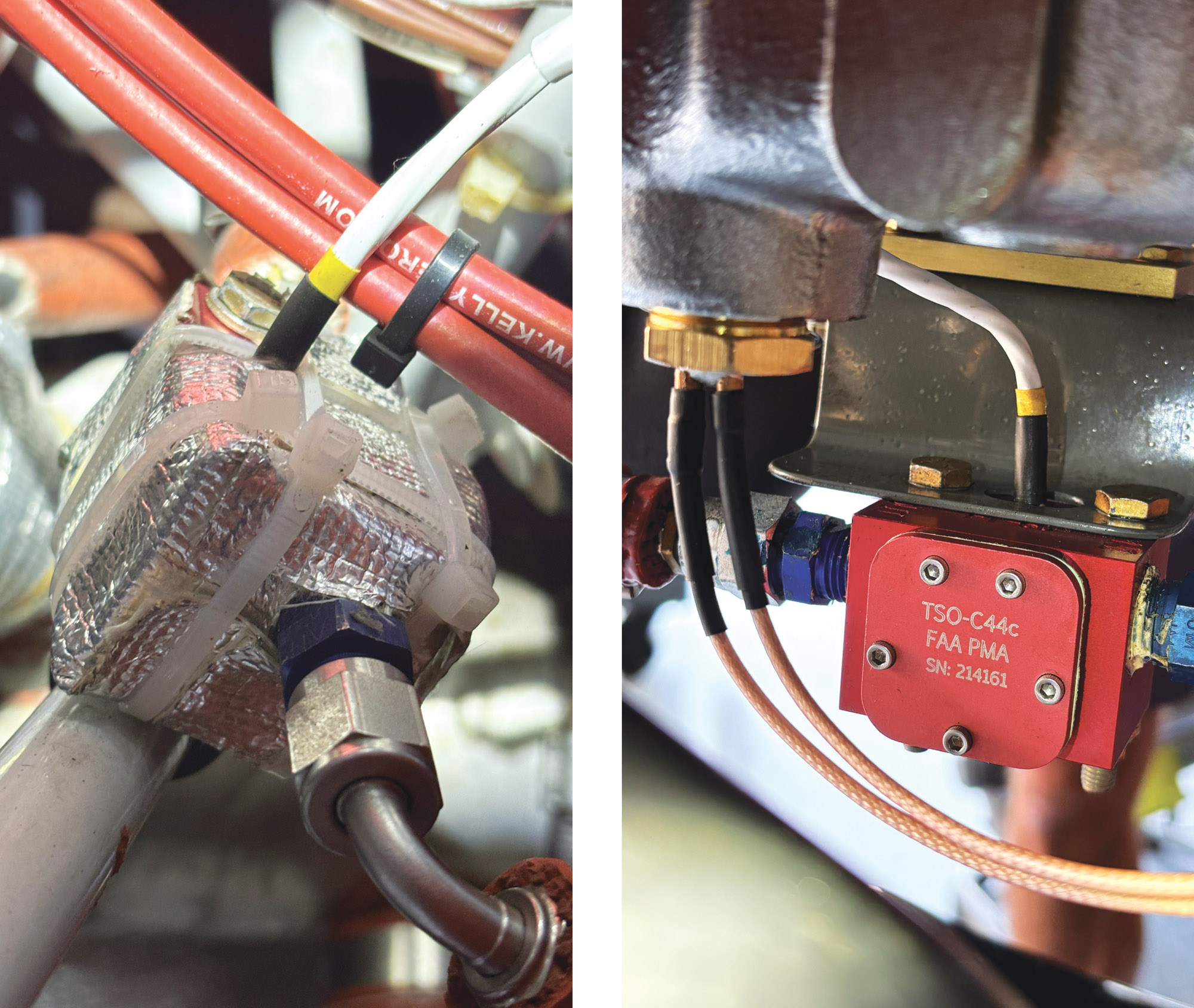

Here are two fuel flow senders installed in different locations within the fuel system—one between the fuel servo and the fuel distribution unit (left) and one ahead of the fuel servo (right). Read the column to understand how a higher-than-normal fuel flow reading could have different causes for each of these.
A steady, high fuel flow reading coming from a fuel flow sending unit that is plumbed before the fuel servo or pump could be a leak in the downstream plumbing. Fuel leaks in the engine compartment are not to be treated lightly. The airstream will fan the flames and even act like a cutting torch if the source is not turned off.
