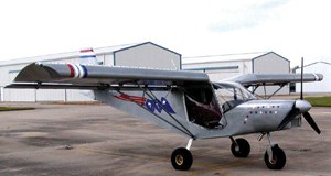

By the time the rule was finally implemented in 1993—nearly a decade after the initial proposal—the industry was beginning to rebound and interest in alternative certification means was waning. Homebuilt Experimentals continued to grow, and the few companies with the wherewithal to pursue certification realized there wasn’t quite enough of a market there to justify the costs. Quicksilver certified the GT-500 as a Primary Category aircraft and sold almost none. At the time, the category was a bust.
