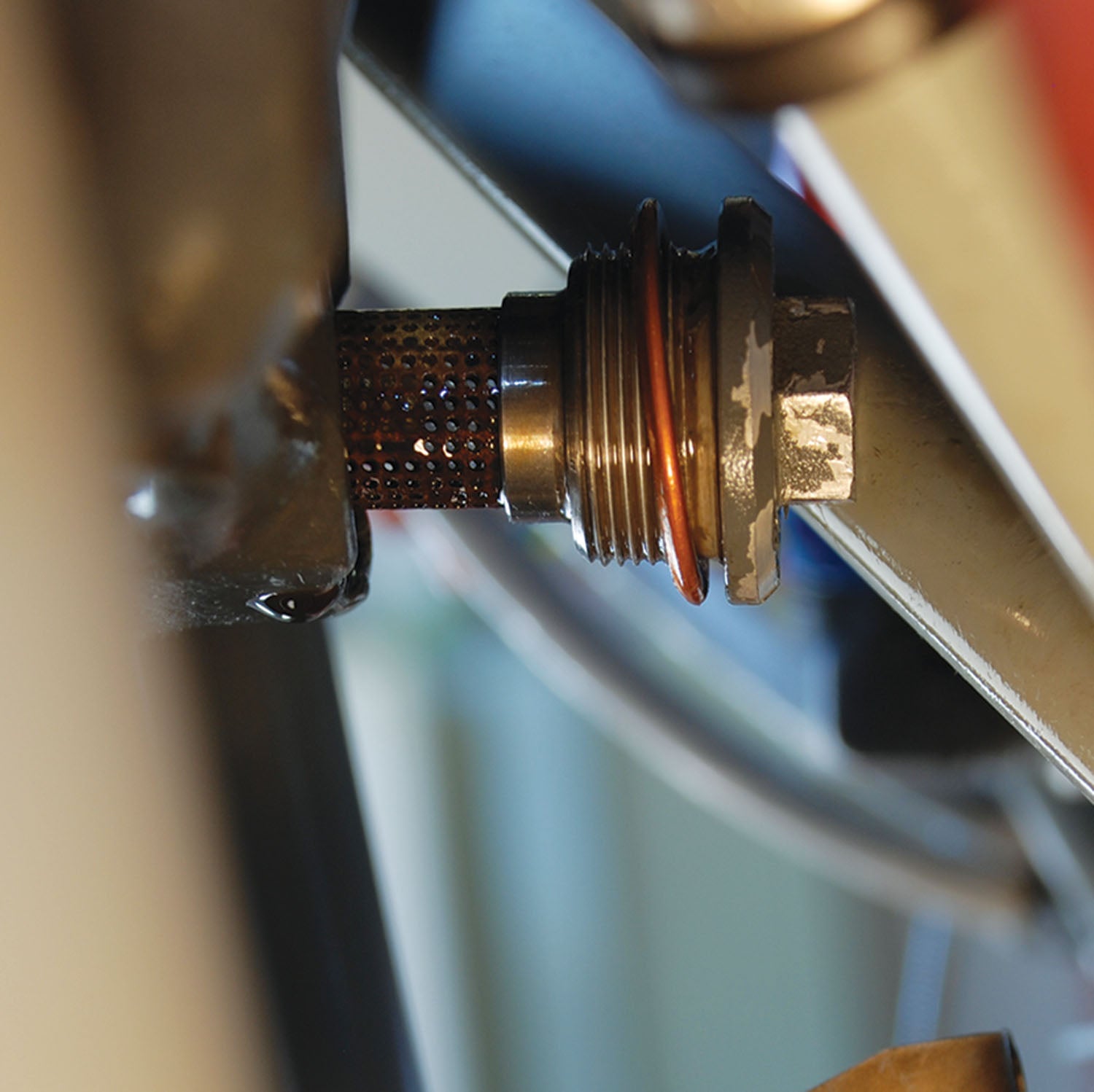

IMG 2426 vic syracuse
This oil sump screen has a lot of debris in it (left). Some serious investigation needs to be done before this plane flies again. The Rotax engine has a very different oil change procedure than a Lycoming or TCM (Continental) engine (right). Used oil drains out of the remote oil tank on the right.

8. Remove the magnetic plug on the engine crankcase below cylinder Number 2 and look for metal filings. There should be few to none present. This metal most likely comes from the gears in the propeller drive. An excessive amount of metal on the magnetic plug is cause for repair or overhaul before further flight.
