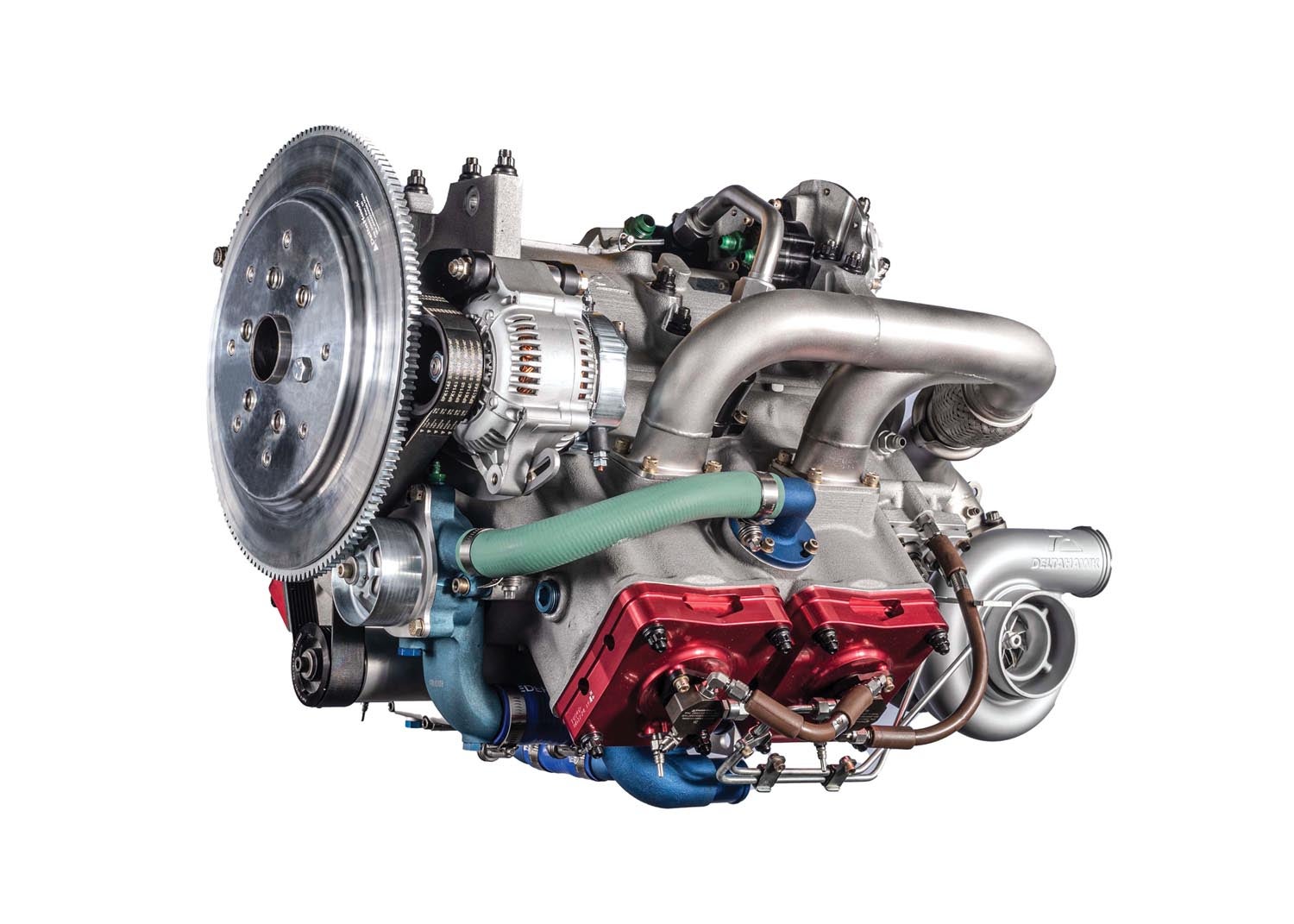

DeltaHawk DHK180
DeltaHawk’s DHK180.
Racine, Wisconsin-based DeltaHawk has been slowly developing their all-new engine for decades. An influx of major funding a few years ago saw them make a big splash at AirVenture 2023 with FAA certification completed and planned customer deliveries set for Q3 2024.
The all-new engine is a two-stroke, Jet A-burning compression-ignition, 90° V-4. Both a screw-type compressor (mechanical supercharger) and a turbocharger are fitted to facilitate starting and provide intake boost at all engine speeds; an intercooler is mounted between the compressor and turbocharger.
Simplicity is the central hallmark of the design and it is indeed elegantly spare engineering-wise. The internal engine parts count is impressively low, weight should not be a major consideration and there is no valve train meaning reduced manufacturing expense and no valves to stick or burn. Ease of major maintenance is also provided, with every accessory mounted on the outside of the engine, all the way down to the dry sump oil pump. There are no electronics; fuel is supplied via mechanical Bosch-style fuel injection.
The initial offering is the DHK180, displacing 202 cubic inches (3.3 liters) and rated at 180 hp. In the works are 200- and 225-hp versions, and a higher horsepower family of engines is planned. DeltaHawk is sure to add cylinders at some point, a capability built into the design.
Engine dyno and flight testing were ongoing in 2023, using Cirrus and Twin Velocity test airframes. Going into 2024 a hydrogen fuel variant was in development. Customer deposits have been accepted since AirVenture 2023 and a 24-month/2000-hour warranty established. That can be extended to 36 months with data download and oil analysis.
There are many other potential wins in the DeltaHawk design. It is a simple but not basic engine promising good performance and excellent fuel economy (DeltaHawk says 35% better than comparable gas engines). There are, of course, other considerations. The largest now is that the DeltaHawk is not a proven entity. We should not have long to wait for proof as its mechanical and business viability will most likely be decided in 2024–2025 as the world gains real-world experience with the DHK180.
For kit-aircraft builders the DeltaHawk holds promise if perhaps not instantaneous viability. With big engineering bills to pay, production to ramp up (over 30 engines have been built so far), along with their 100% U.S. engineering, manufacturing and funding, we’d think retail pricing should be challenging but DeltaHawk says they’ll be “very competitive with current engine offerings.”
So, once again we’re reminded that the price of progress is trouble, but we like what the DeltaHawk offers. The many operational and mechanical advantages from liquid cooling, including the major gain in fuel economy, are alone worth the consideration.

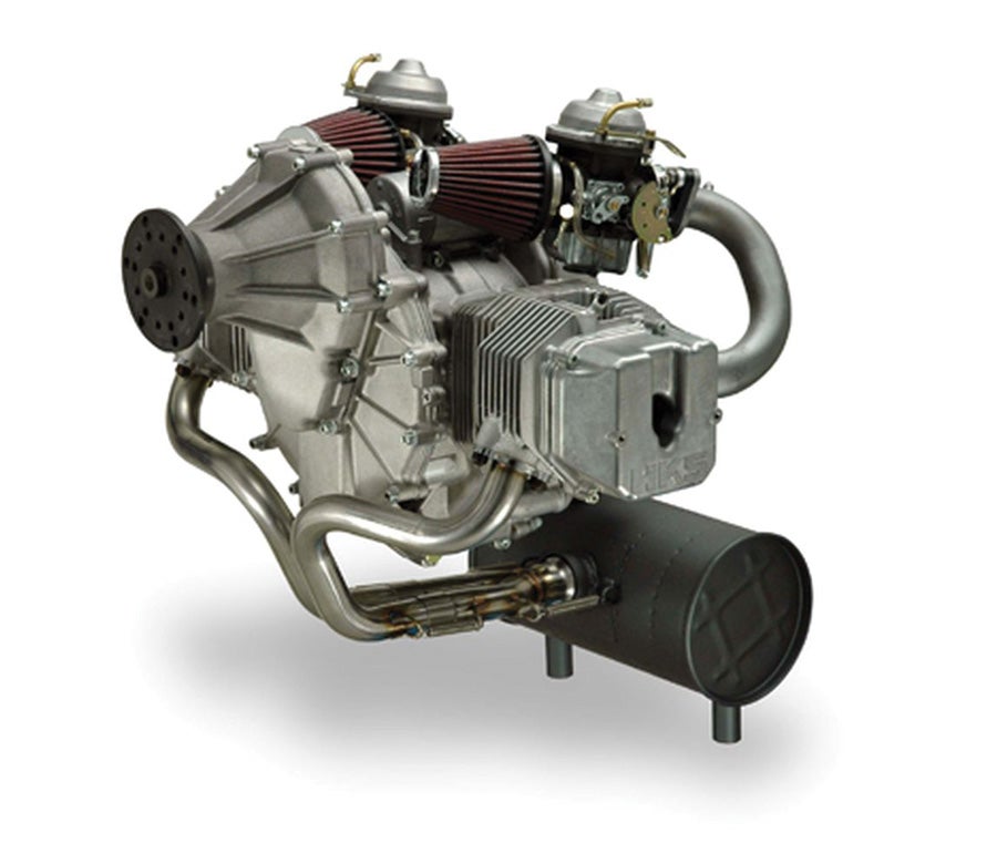

HKS 700E
From the other side of the world, Japan gave us the 60-hp (58 hp continuous) HKS 700E. Parts, service and a few of the time-tested two-cylinders remain available through Quicksilver Aircraft Northeast. These engines feature reduction gearing (two ratios available), a 1000-hour TBO and pricing in the $15,000 range when fully dressed with dry-sump oil tank, oil cooler and throttle cable.

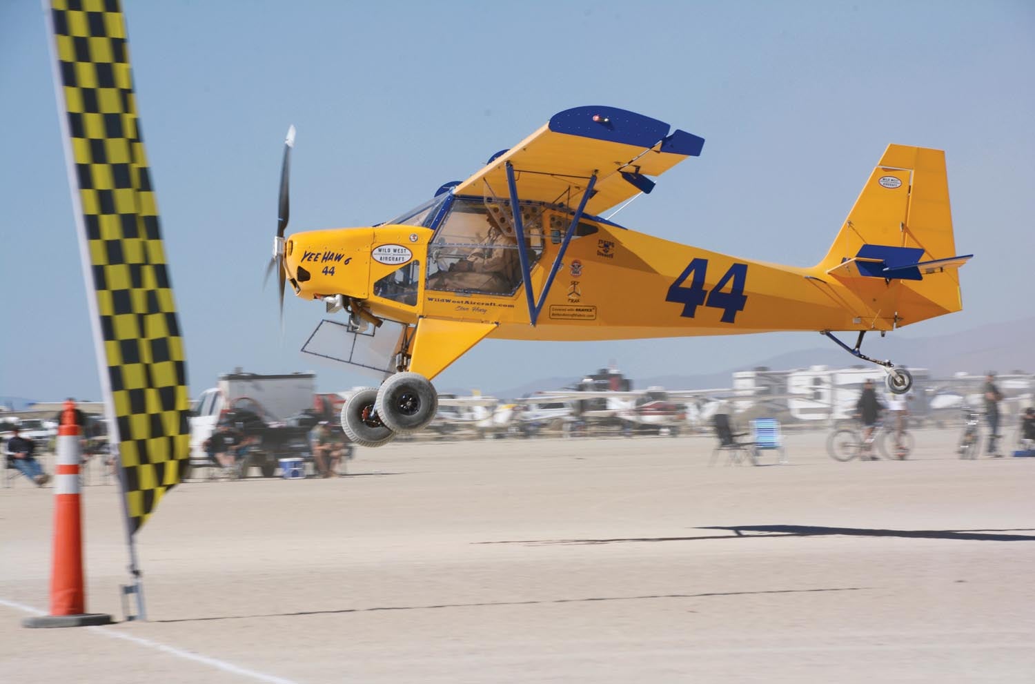

Interest in competition has brought specialized racing engines to sport flying. They’re great performers but need too much attention for casual sport flying. Here Steve Henry demonstrates the 9000-rpm(!) Yamaha EPeX.
Yamaha EPeX
“Welcome race fans” is a suitable introduction to this family of very hot-to-trot Yamaha engines available from BadAss PowerSports, Mohawk Aero Craft and others. Most famous for its winning ways in Steve Henry’s Just Highlander, this 9000-rpm, 300+ hp four-banger is great for winning STOL competitions but is a high-strung beast needing fairly regular attention by an involved, tech-savvy owner and is not particularly sport flying friendly. The same holds for the newer three-cylinder Yamaha race motor as well.
