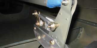

No safety wire
Drilled head bolts are drilled for a reason. Usually the part is subject to high vibration or rotation, such as this wheel pant bracket. It requires safety wire. I pointed this out to one builder/pilot and received a very questioning look. I was vindicated when we looked at the other wheel pant and the bolt was completely missing!
