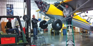

Now that you’ve installed the engine in your homebuilt, do you know how to maintain it? The required skill set is completely different.
