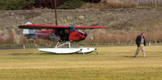

It may be summer as you read this, but when it was written, we were all being inundated with the news that record low temps were being set across North America. It certainly brings back fond memories of my maiden flight in the very first aircraft I built, an RV-4. It was -10 F on New Year’s Eve in 1983 in Cleveland, Ohio. I’m sure the adrenaline kept me from noticing the cold, and I certainly didn’t have any engine cooling problems! And what a contrast to the maiden flight of my most recent completion, a Kitfox Super Sport, performed on a June day in Atlanta, Ga.
The author’s Kitfox Super Sport on climbout.
Having built nine airplanes across those 30+ years, and having performed all of the maiden flights myself, along with many other maiden flights for other builders, I thought I would pass along some observations and recommendations.
