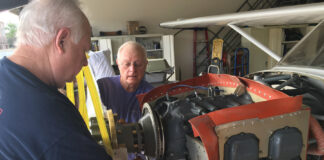

“I have an ancient O-340 in it. Rare birds, Lycoming only made them for about two years,” Bounds said. “I think they were made for the twin Navion because it needed more power than the 320 produced, so Lycoming stroked it. Two years after that, they came out with the O-360, and they quit building the 340.”
bearcoupe 08
With the Bearcoupe complete, Bounds hauls its 3D Prospector plans to the city dump.
Bounds bought the four-cylinder, 170-horsepower Lycoming used. “It seems to pull the airplane well; I cruise at 115 knots and land at about 40.” It burns 13 gph wide open in a climb, but lean of peak at 11,000 feet it burns 5.5 gph at cruise. “With 55 gallons of fuel, it gives you enough to go out a bit farther—and get back—without crowding” the reserve.
Originally, the Lycoming turned a metal Sensenich propeller. Then he tried a Catto composite prop and became a fan. “I lost no takeoff performance and gained 10 mph, and it only weighs 13 pounds,” he said.
bearcoupe 14
A rare 170-hp Lycoming O-340 turns a Catto composite prop.
