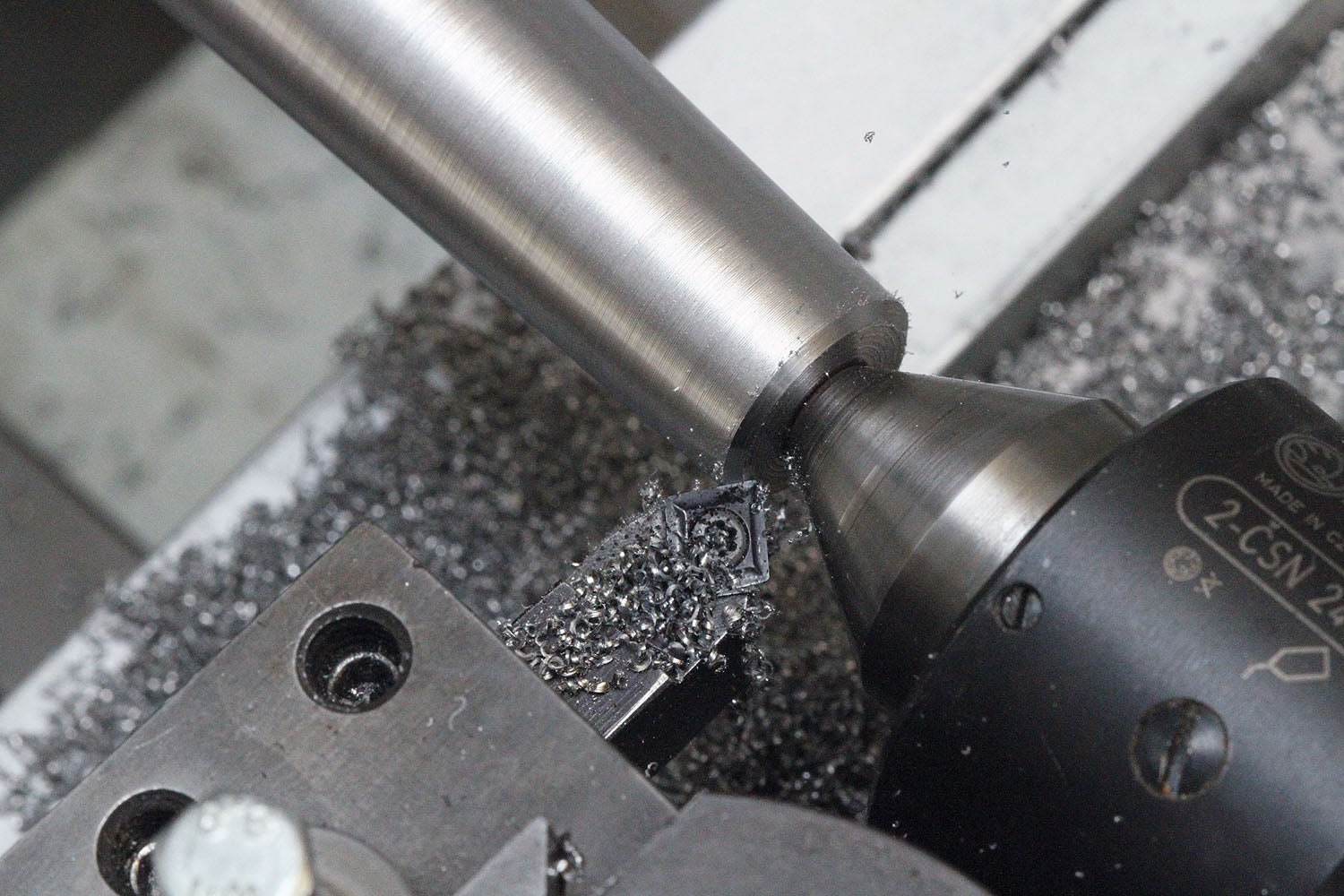

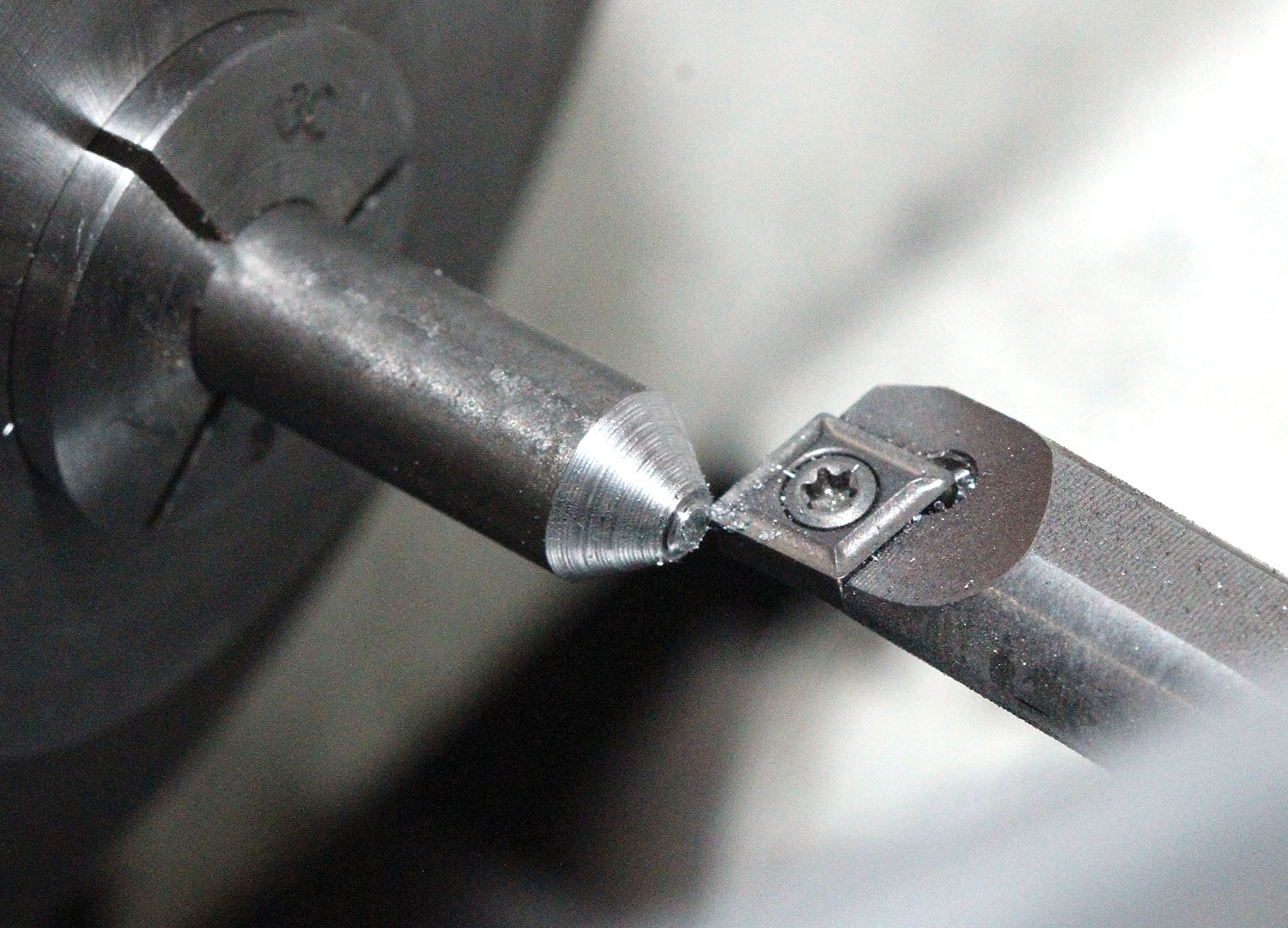

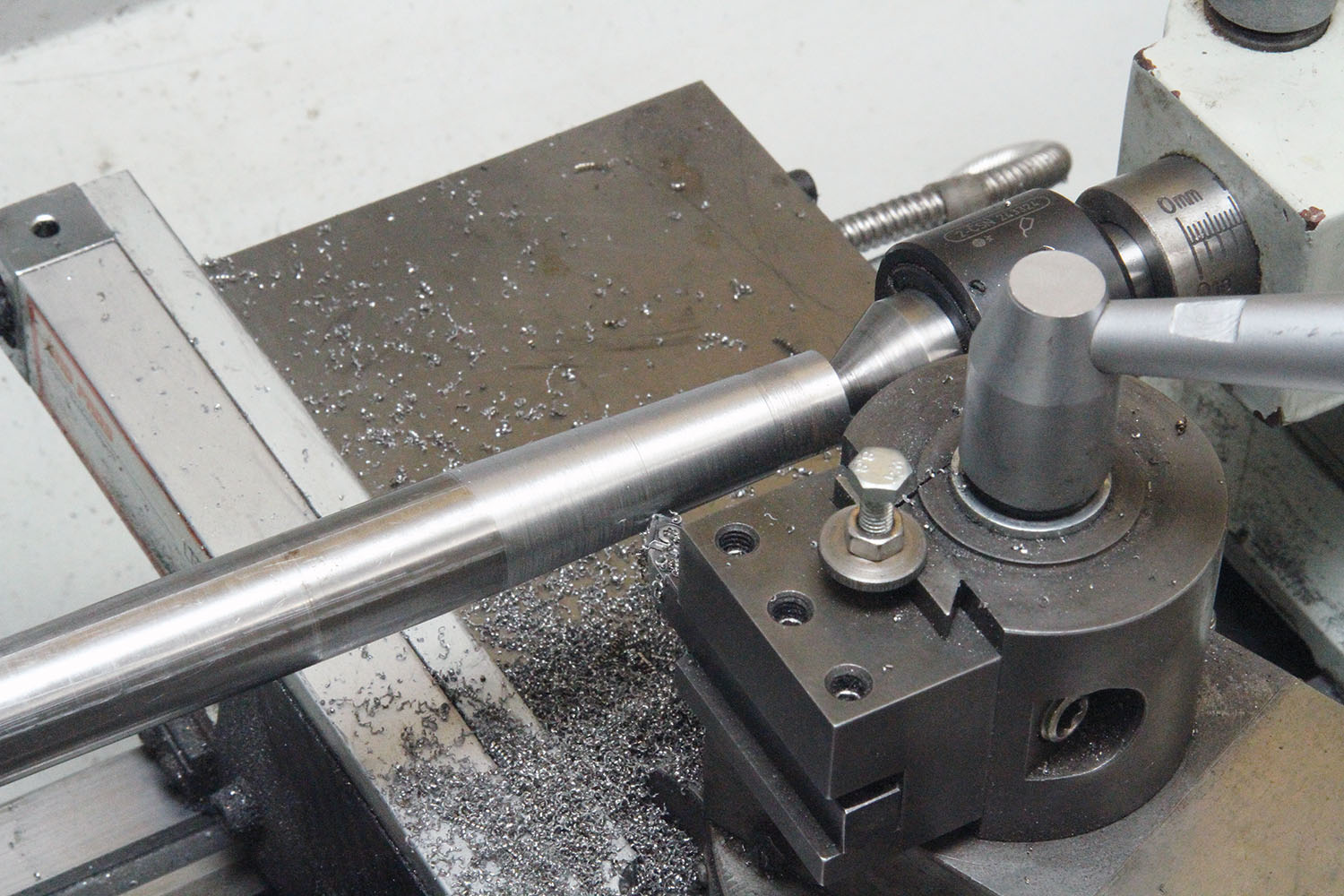

Shallow and small chamfers often can be quickly machined by positioning the long edge of the tool to the edge of the workpiece and making a plunge cut. But more often than not, I set the compound slide at the correct angle and advance the tool to make the chamfer.
Photo 6 chamfer spindle R1
Advancing the compound slide at the desired angle (represented by the ghost image) is how I make most chamfers. Note the tool is cutting on the side away from the operator with the spindle rotation in reverse (red arrow). A boring bar is a convenient tool to use for this type of chamfering.

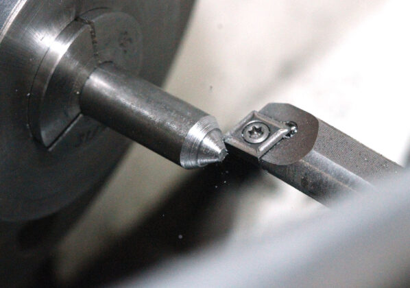

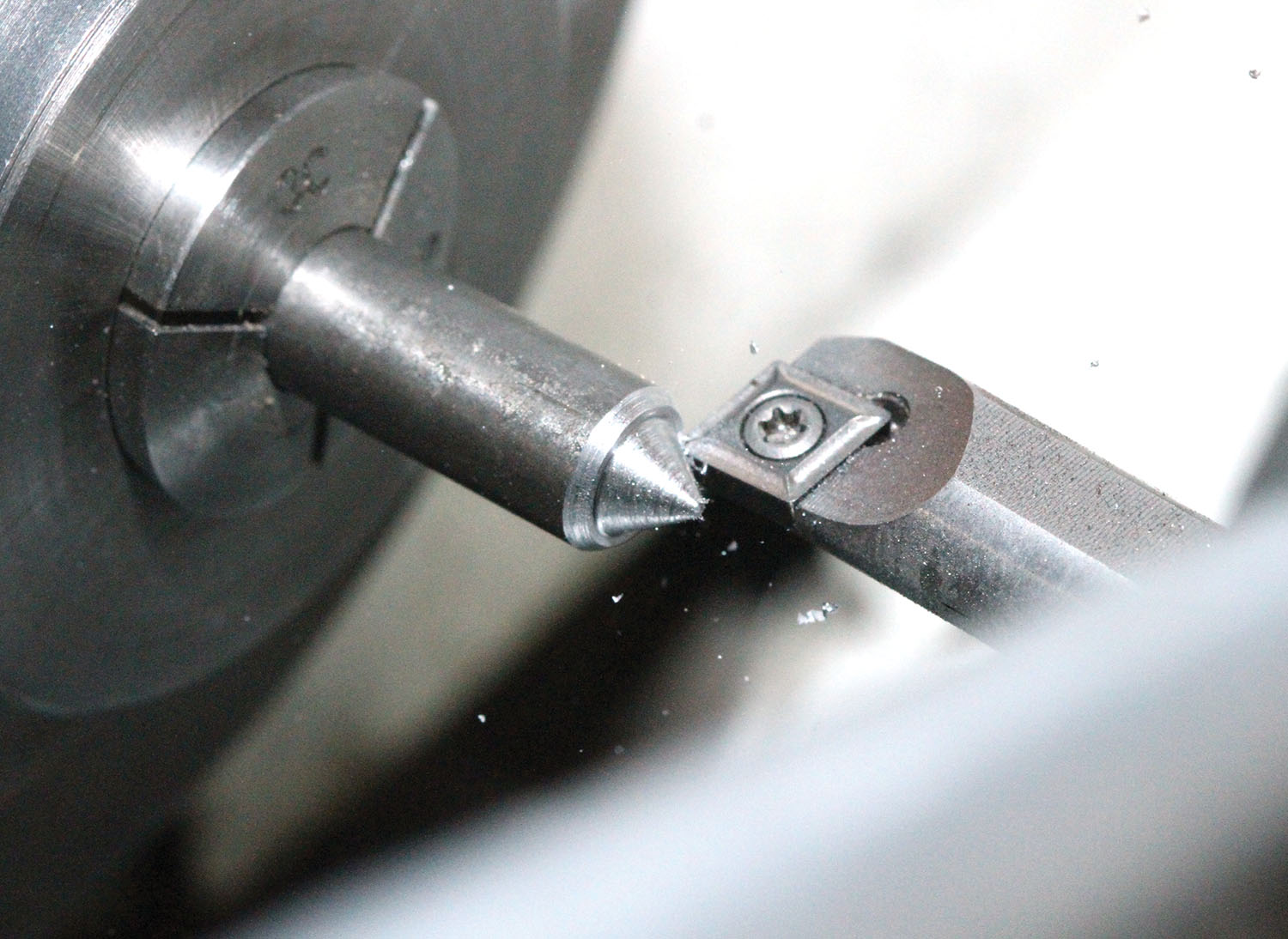

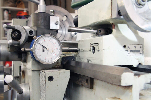

Generally speaking, a taper is a type of chamfer that is either to a point, or longer and more gradual than a beveled edge. Short tapers can be made using the compound slide the same way as a chamfer: Set the compound slide to the desired angle, align the cutter, and off you go! Tapers that exceed the travel capabilities of the compound slide are made by either offsetting the tailstock, or by means of a special taper-attachment accessory. Since no taper attachment exists for my small lathe (they’re typically not an option for small bench lathes), I’ll focus on the offset tailstock method.
Photo 11 taper
The taper is determined by the distance between centers, the length of the taper, and the offset of the tailstock. The above sketch shows how the same offset (0.319 inches) results in an ever-increasing taper as the distance between centers is shortened.
Photo 12 taper example CAD
The top sketch is the raw turning stock. The center-drill details at each end represent an accurate distance-between-centers length. The middle sketch is with the 4-degree taper. The bottom sketch is the sketched part angled 2 degrees to show the tailstock offset.

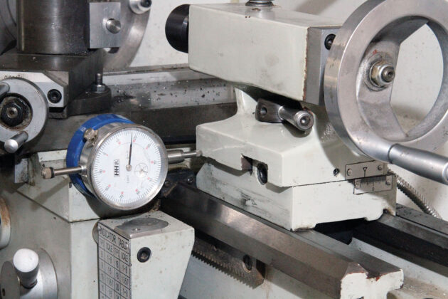

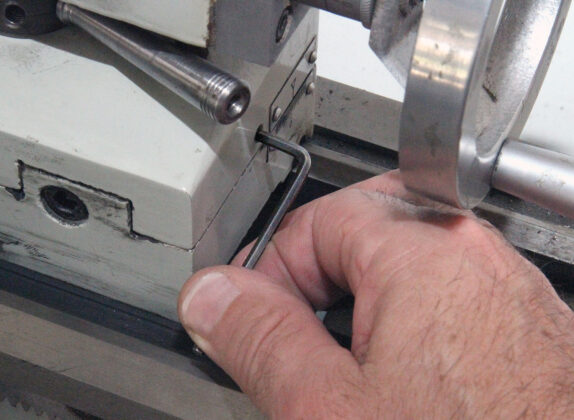

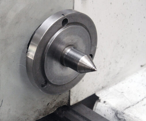

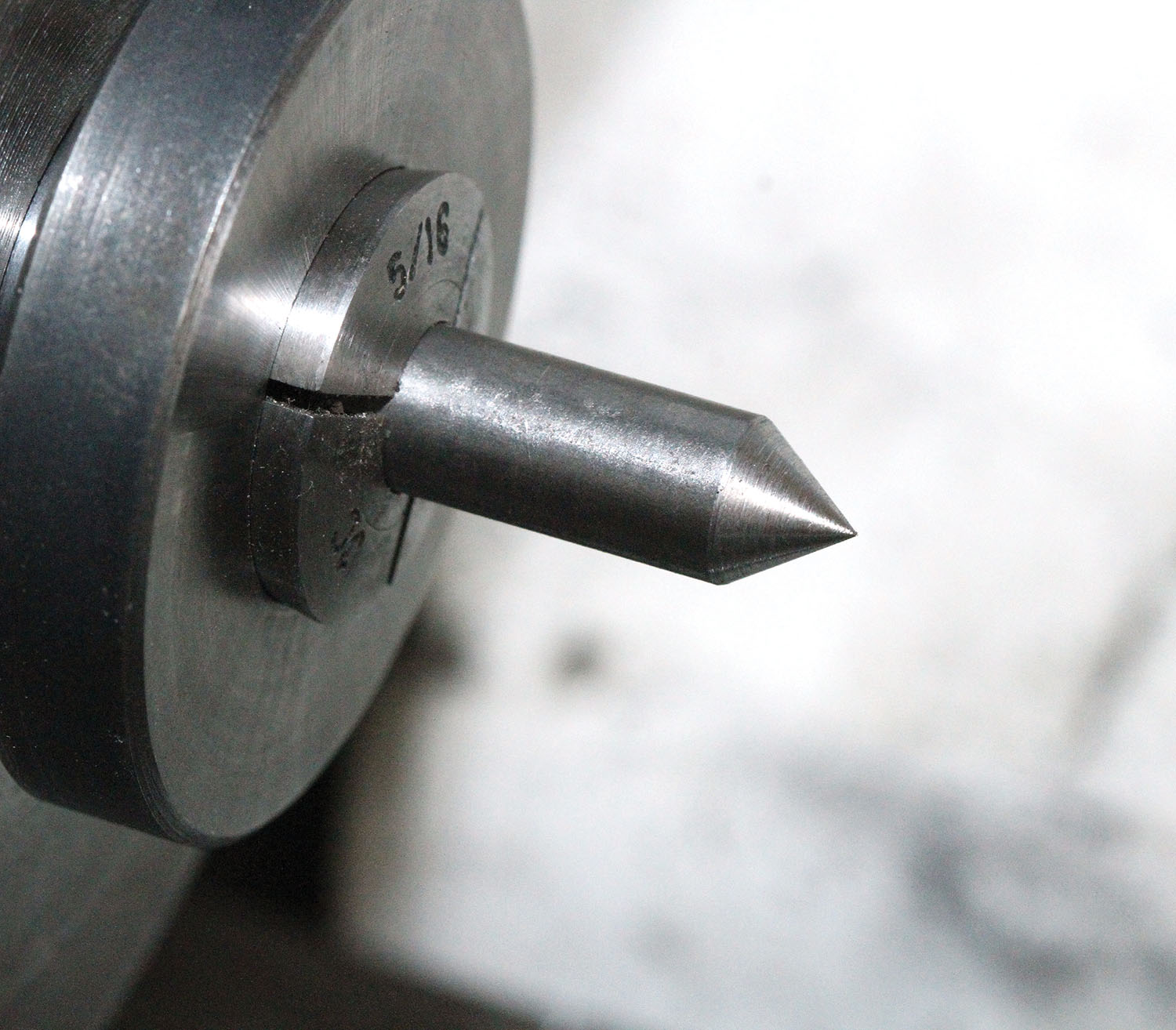

The offset tailstock method takes advantage of the taper “error” that occurs (when machining between centers) when the tailstock center is not perfectly aligned with the headstock center. To make a taper, the idea is to offset the tailstock a prescribed amount in order to generate the desired taper.
How much to offset the tailstock depends on the angle or slope of the desired taper and the distance between the centers.

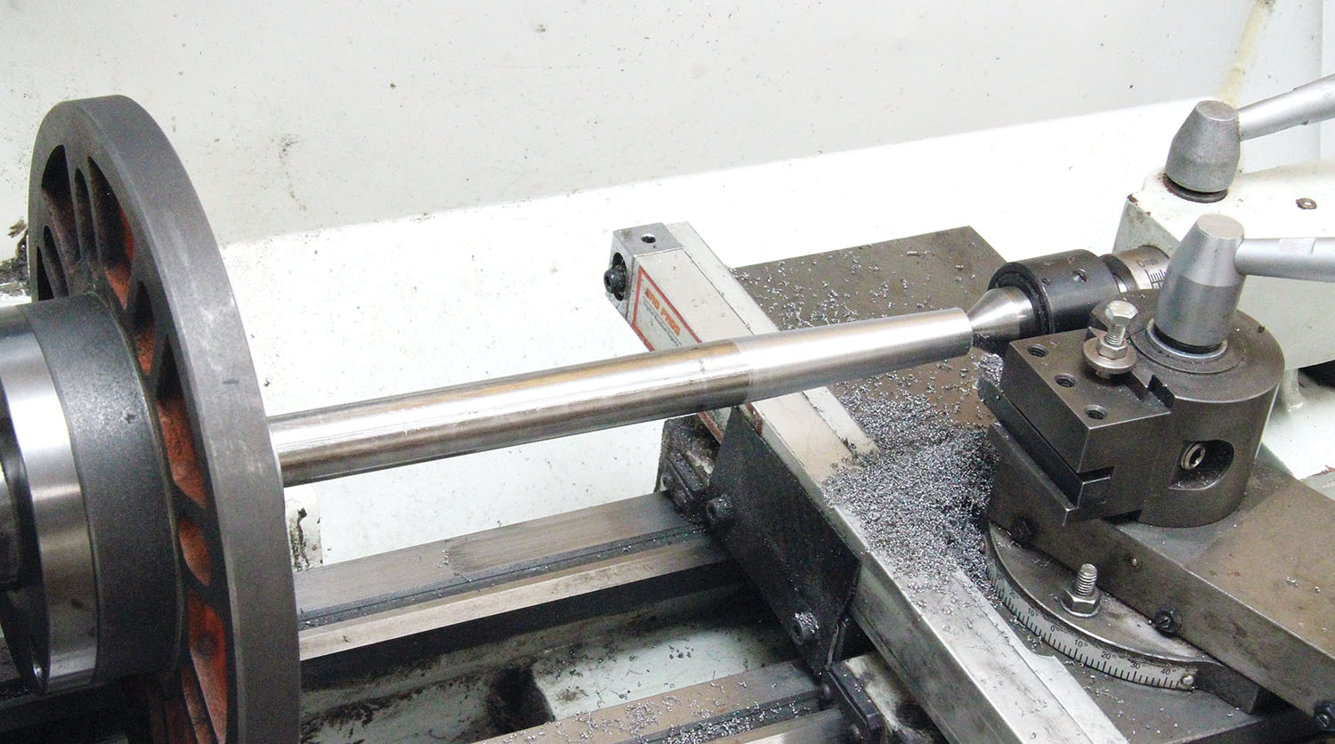

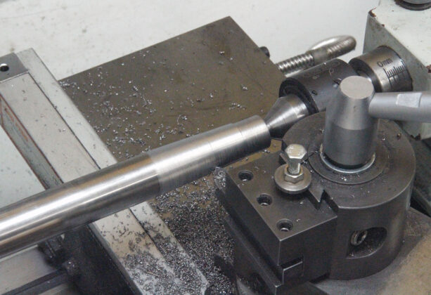

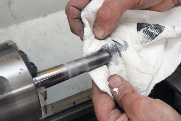

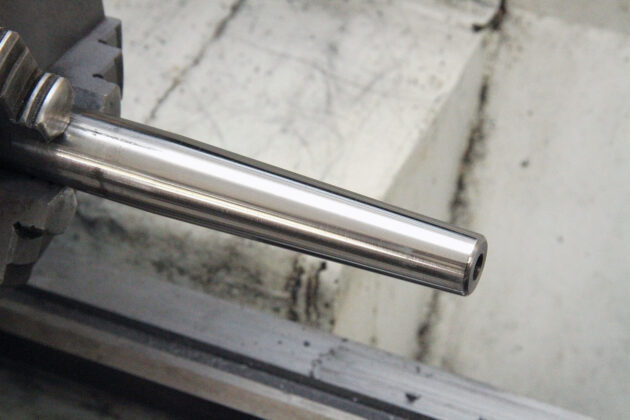

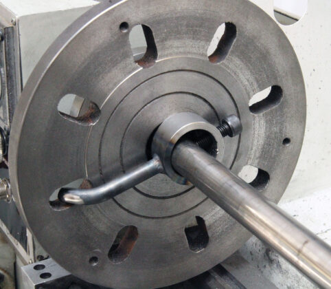

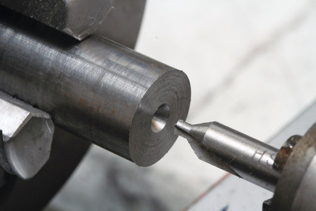

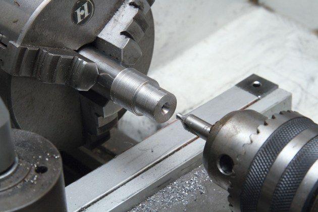

To demonstrate taper turning, I made an alignment drift. This is a tool that comes in handy when you need to coax a spar and strut end to line up with a mounting hole. The material for the drift was a 9.3-inch length of steel bar salvaged from a go-kart axle. The diameter was 0.787-inches (20mm), and it had a small 5/8-inch diameter stub already turned on one end. After some sketching, a four-degree taper looked perfect. CAD software made it easy to get the distance to offset the tailstock. It’s hard to overstate the convenience of sketching with a CAD program. Provided your sketch is accurate, you can derive precise dimensions with a click of the mouse. (Download a free version of Solid Edge 2D drafting software. EAA members can download a free version of SolidWorks.)
With the offset dimension in hand (0.319 inches), it was time to set up the lathe and get started shaping metal.
