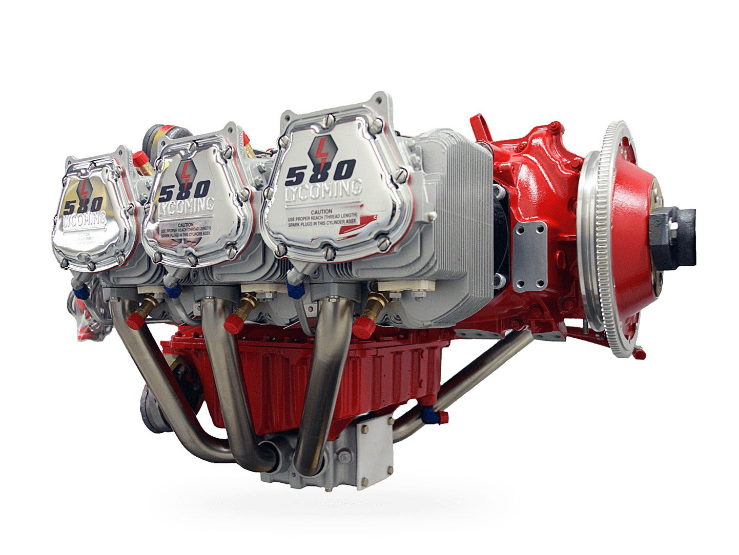

thunderbolt engine
Lycoming’s Thunderbolt line is intended for the E/AB market.
Using a new certified engine on an Experimental airplane is certainly no problem other than it’s the most eye-wateringly expensive option available. Also, a certified engine must be kept absolutely stock to retain its certified status. If you modify it with a different intake, ignition or even rocker covers, it is no longer a certified engine and drops in value as it’s now an Experimental engine. The same goes for complying with service bulletins and airworthiness directives.
