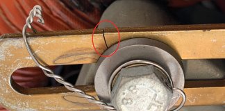

Routine carburetor maintenance mostly does not actually involve the carburetor. It consists of keeping the air filter clean, the airbox in good shape (many are prone to cracking) and the fuel filter clean. If you do that regularly and keep your fuel clean and free of water, you have covered most of the maintenance needed. Whenever you have the cowl off, it’s a good idea to check for any signs of fuel leakage. These need to be corrected immediately if found.
Also check the airbox for soundness and secure attachment to the carburetor. Over time it can crack or come loose and allow unfiltered air into the engine. The screws that attach the airbox to the carburetor should be safety wired to prevent the airbox from coming detached from the carburetor. By the way, Marvel-Schebler recommends that you use copper wire instead of stainless steel safety wire on the carburetor. That said, my Precision Airmotive (same as a Marvel-Schebler model) carburetor came from Lycoming with stainless steel safety wire. I’ll leave the choice to you.
