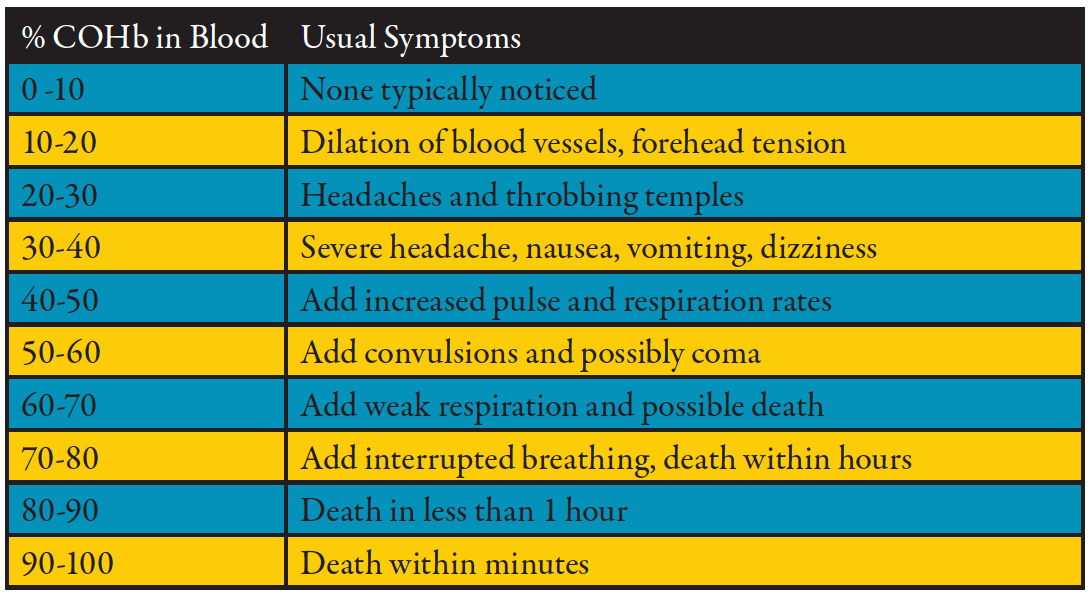

Symptoms of gradual CO poisoning aren’t always easy to detect. In many cases, the effects of sustained CO levels have been attributed to the occasional headache, nausea from motion sickness, a minor case of influenza or other vague flu-like symptoms. Of course, higher concentrations of CO will result in more severe symptoms, and Table 1 illustrates which symptoms are typically found at increasing concentrations of CO.
carbon monoxide poisoning symptoms
Table 1.
