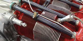

This is the latest version of the Sky Dynamics sump. I’ve used their cold induction system on my engine since the first time the plane flew about 26 years ago.
Tunable Induction
We need a tuned and tunable runner from our plenum, so I am trying to develop one, working with the cooperation of Sky Dynamics. Kevin and Marshall Murray have been very helpful and provided the components that they already make. I’ve been running their cold induction system, developed for the Lycoming 360, for 26 years or so, since the first time my plane flew.
