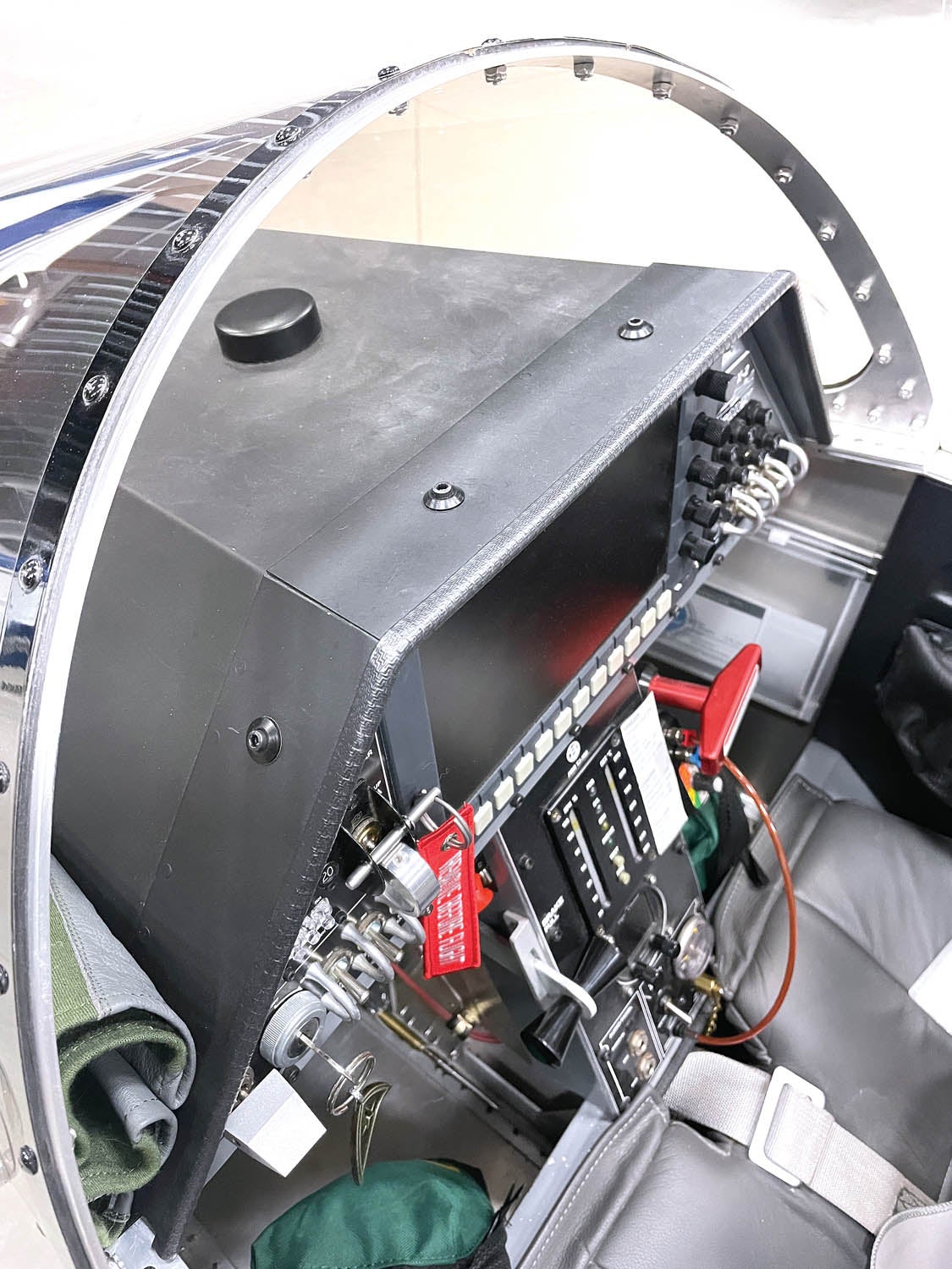

Paul had originally used buttonhead screws (thread size 8-32) on the glareshield. Buttonheads were a good choice. They combine a low profile with a relatively large face. But after a few times removing the glareshield for various tweaks, and despite the fact that they only needed to be moderately tight, the two screws closest to the canopy (one on each side) were stripping out due to the shallow socket and sharp angle, which required the use of a ball driver. In the end, Paul changed all the buttonhead screws to socket head cap screws (SHCS). This solved the problem of the heads stripping out, but presented a minor (but annoying nonetheless) issue of bare metal showing where the paint had worn off from the old screws. You can’t have that on a show-quality airplane!

The glareshield of Paul Dye’s SubSonex jet. For details about building the SubSonex, see “Turbine Temptation” (November 2019 through May 2020).
Short of respraying the glareshield or using flat washers, which Paul did not want to do, we conjured up the idea of making decorative washers to conceal the missing paint and dress up the look of the screws. The material we selected was black Delrin, a tough, easy-to-machine DuPont plastic that’s similar to nylon. Unlike a basic flat washer, these were made with a close-fitting counterbore and a beveled face and they are threaded so they stay married to the screws when removed. (Anyone who has ever spent the better part of a day trying to find a small washer among an array of wiring harnesses will agree: That is a good feature.)
