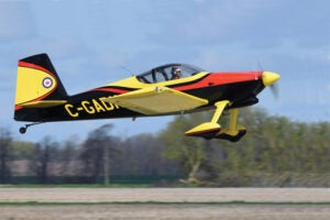

rv 7 buying used 7 ray clegg ian bellamy airborne
Nineteen years after the RV-7/7A was introduced, over 1800 examples have been completed.

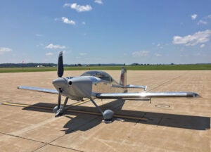

rv 7 buying used img 1553
This RV-7A was built with a sliding canopy, but the tip-up canopy is also popular.

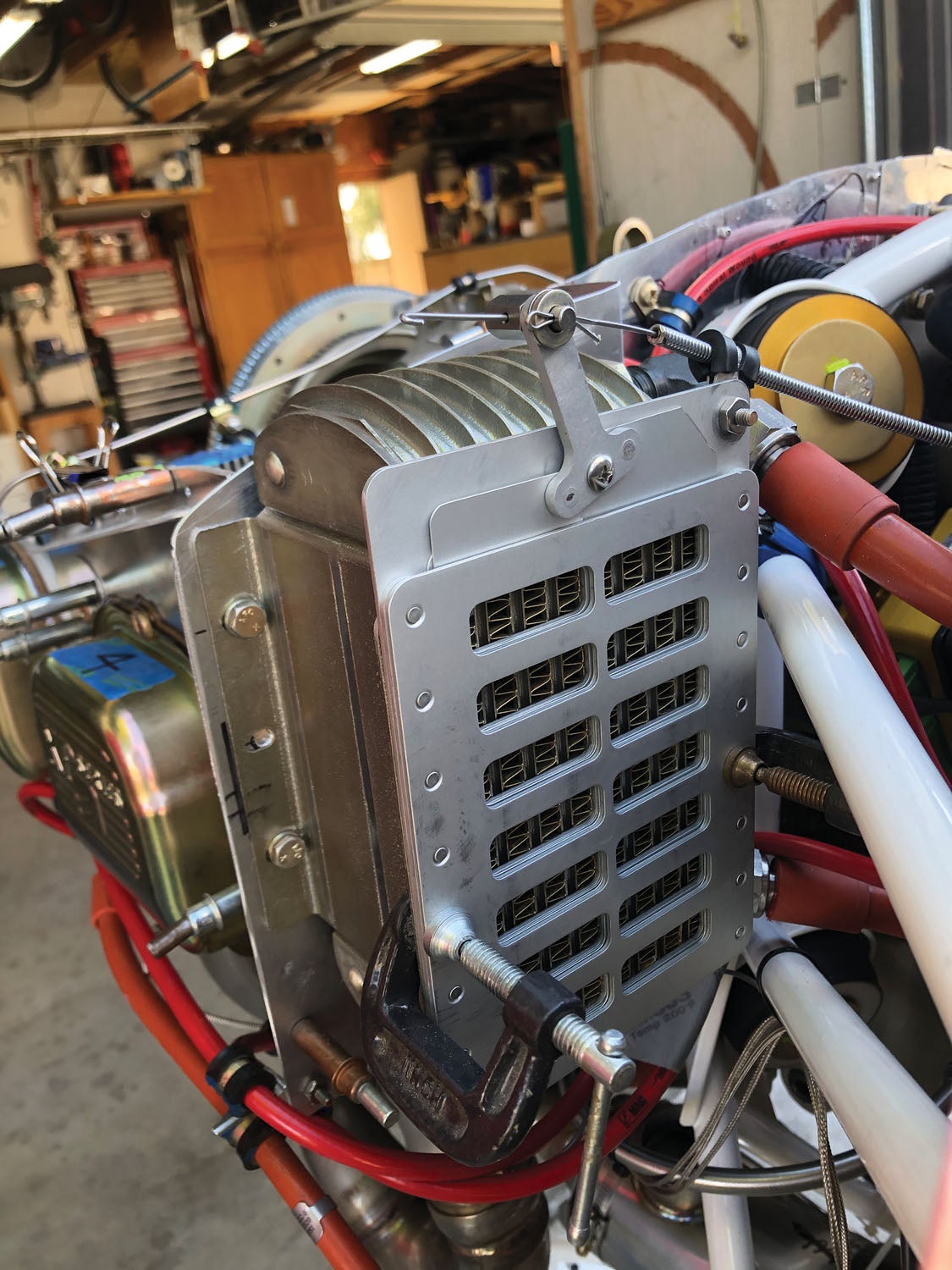

rv 7 buying used img 0196
An interesting modification for those who fly in cold climates is this adjustable shutter that controls the amount of air flowing through the oil cooler.

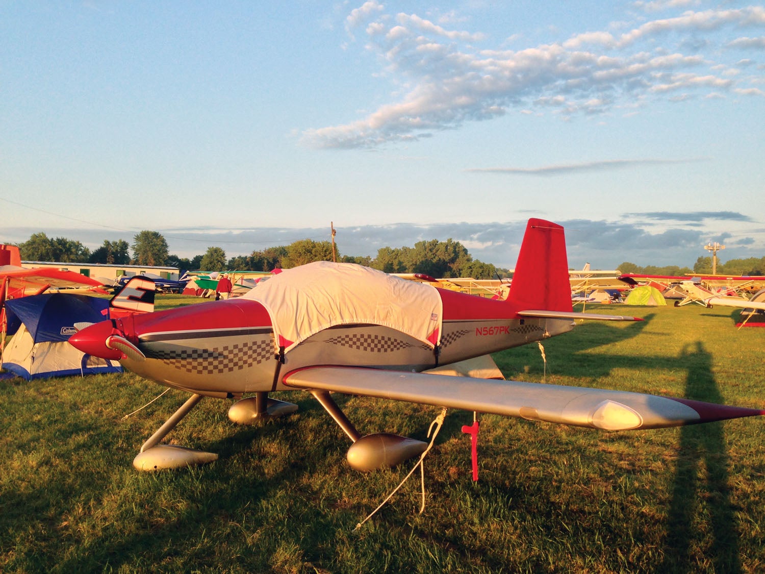

rv 7 buying used 7 cfcox 2
Like most of their models, Van’s designed the RV-7 to be sporty but also capable of cross-country flight.
