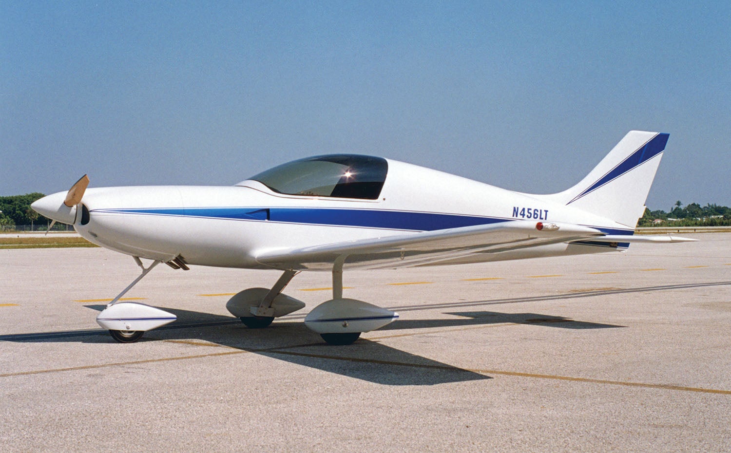

pulsar buying used pulsar n456 ramp original leadThe dream. Lifting off in a small, form-fitting craft. The machine behaves perfectly, just as you expect it will. The machine responds to every nuanced action as if it is reading your mind. The machine blends with human interaction perfectly. The air flows quietly over the polished surfaces, lifting you higher, faster, according to your desire. The engine sound is reassuring and smooth. There is no apprehension, no fear, as you are carried effortlessly into crystal blue air. Leveling off at 1000 feet, you marvel at the effortless performance and intimate response of this small airplane. It’s a dream.
But this isn’t a dream. It’s the real thing, so perfectly matched to the dreams I had over and over again, falling into fantasies of flight every night. By day I would labor in the garage, assembling the aircraft and thinking about how it would behave in the air. More importantly, how would I feel? As a new pilot with few flight hours, could I possibly arrange a situation where I didn’t feel fear and apprehension on my first flight?
When you look for the perfect airplane for yourself, you want these expectations to line up with reality. With a little help from my friends getting dual in the Pulsar and a thorough test plan, I could combine the dream with reality. In fact, reality won out over the dream.
Today, the Pulsar remains a fond memory for many. And while the design is no longer in production, there are occasionally unfinished kits surfacing, and there are, according to a recent fleet-size estimate by KITPLANES® contributor Ron Wanttaja, just more than 100 still registered. (There were more than 150 as recently as 2009, but the FAA’s move to a triennial re-registration process has culled what are likely to be non-flying examples from the rolls.)
So the question is: Is the Pulsar for you? Here’s what you should know.

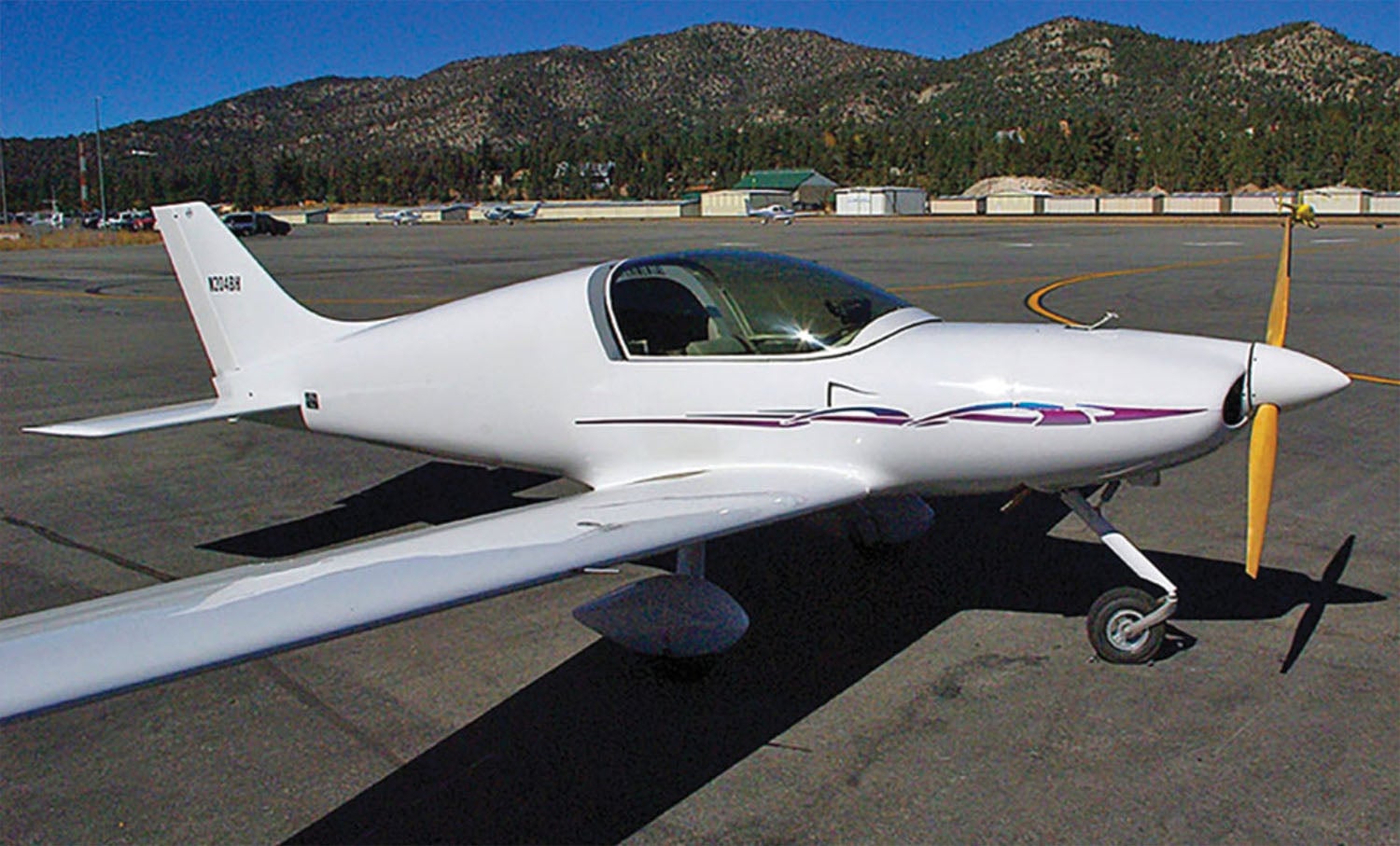

pulsar buying used scans349b
The Pulsar combines economy with performance and looks good to boot.

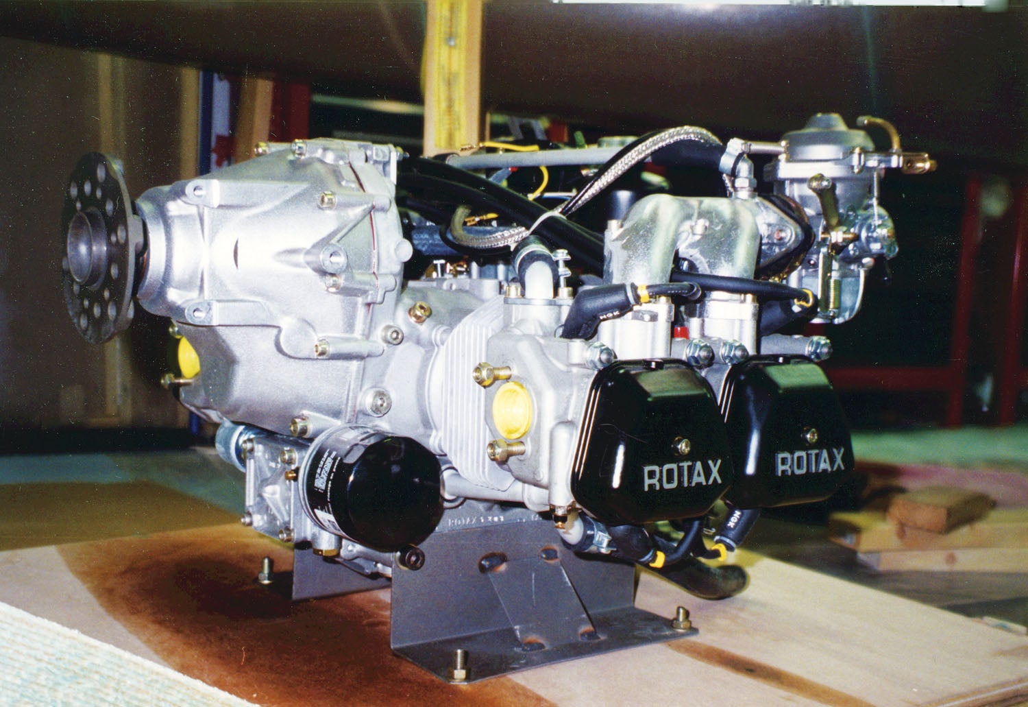

pulsar buying used scans347
The Rotax 912 four-stroke gradually replaced the Rotax 582 two-stroke as the engine of choice for the Pulsar.
Even with new-builder empty weight creep, the airplane performs with vigor. If you go Pulsar hunting intending to buy, don’t be surprised at empty weights of up to 630 pounds. Between applying too much fiberglass resin to layups and adding an IFR panel, weight creep is fairly normal. You’ll just need to decide how much you want to fit in the airplane when you fly, especially on trips. When I built mine, I added 20 pounds of soundproofing foam to the cockpit before upholstery; it was a deliberate trade-off. Gross weight on the Pulsar XP is 1060 pounds; however, several builders told me they “tested” the aircraft to higher loads, so some data plates show higher gross weights.
One hallmark of flying behind the Rotax 912 is that you don’t need to think about fuel mixture. The dual Bing carburetors are self-compensating at altitude. A free-castoring nosewheel along with high outward visibility make taxiing a delight. The canopy can be left open until run-up on hot days. The Pulsar gets off the ground quickly and climbs at 1200 fpm after getting free of the ground in about 800 feet of runway.

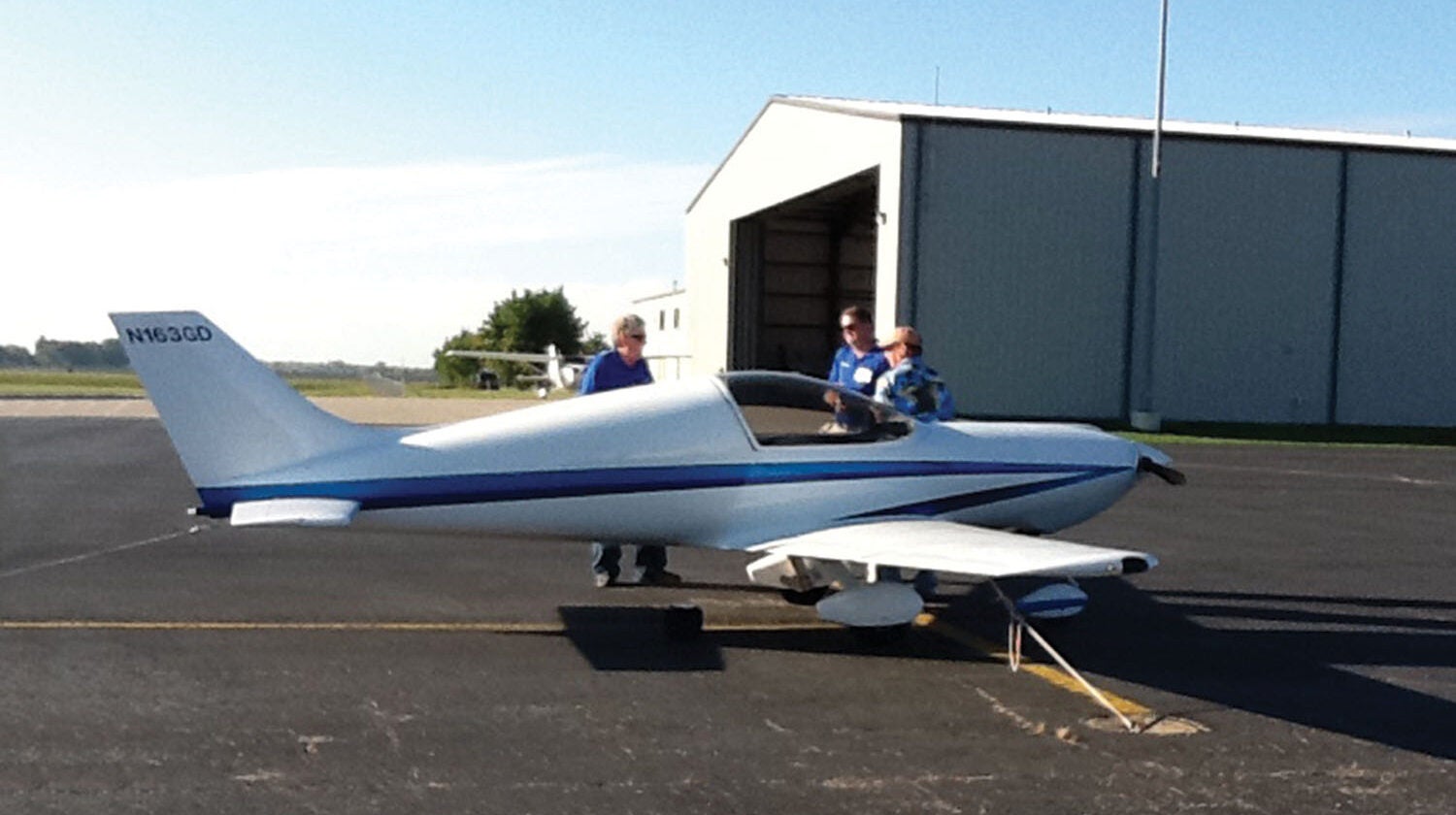

pulsar buying used kansas fly in
Every year the Pulsar builders and flyers get together in Lawrence, Kansas, to enjoy Pulsar discussion and flying fun.
