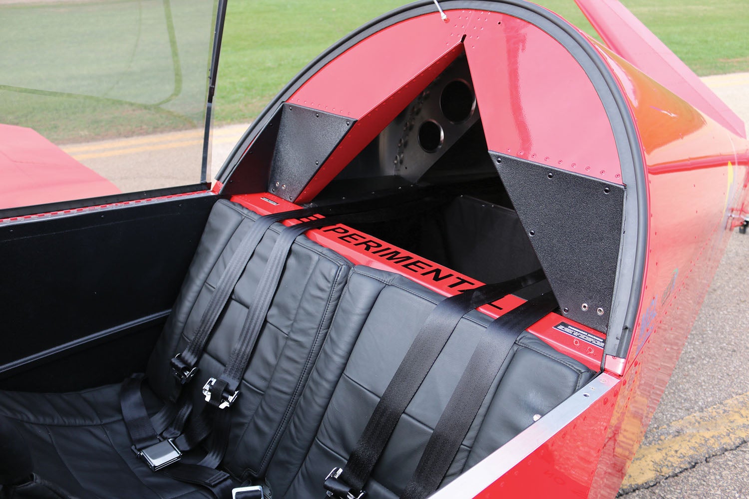

sonex buyer guide 04
A well-built Sonex/Waiex has room for up to 40 pounds of luggage behind the seat.

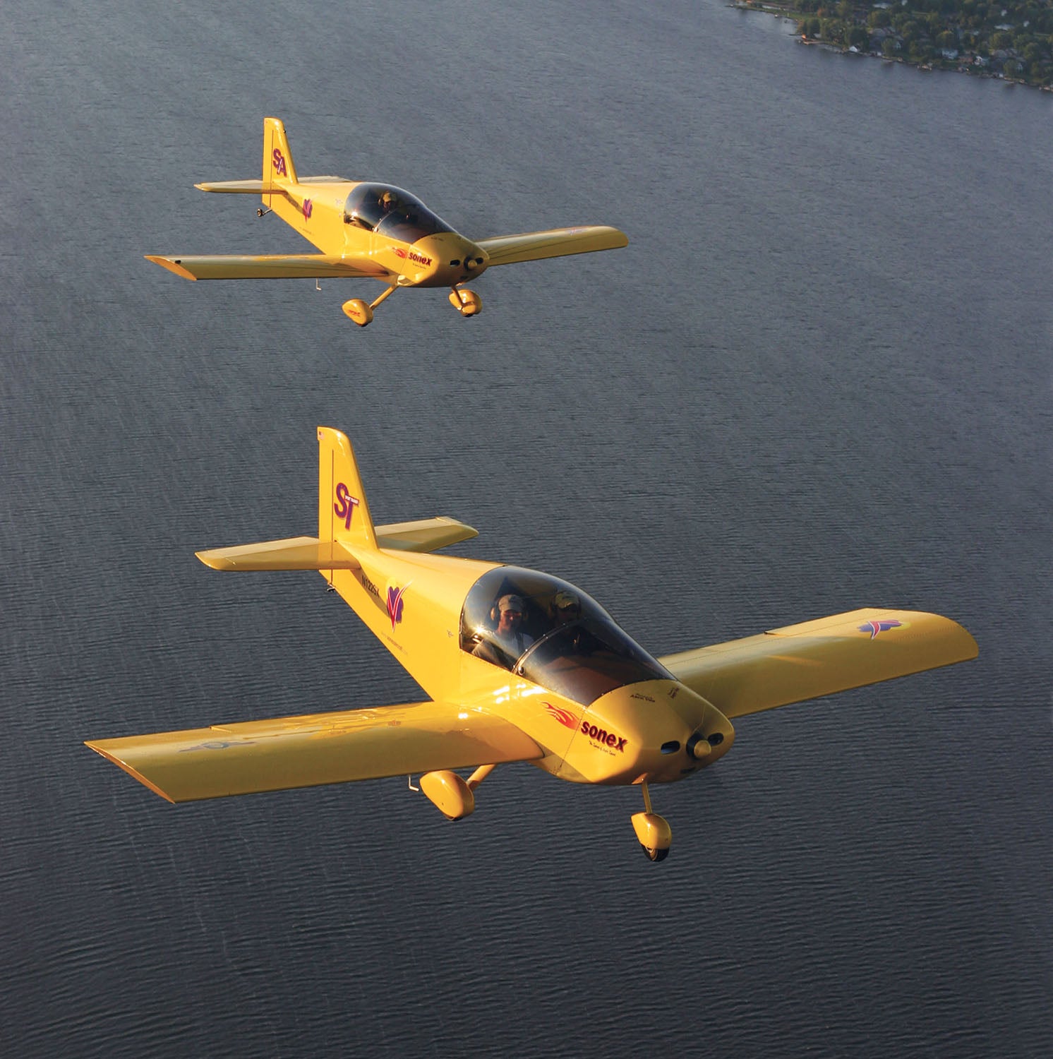

sonex buyer guide 05
The Sport Acro version of a Sonex or Waiex features longer ailerons and shorter flaps for increased roll rate. Every kit includes the parts for this option. A completed airplane can be refitted with standard or Sport Acro ailerons and flaps.
