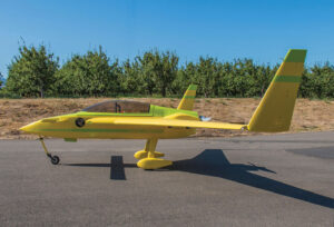

GOPR0456

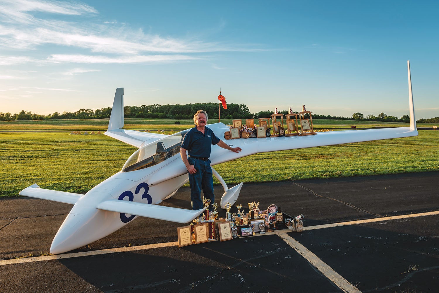

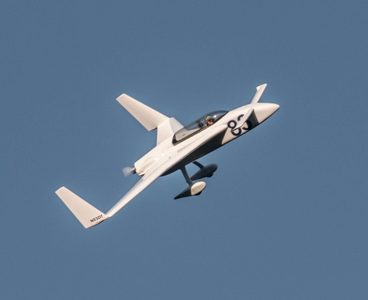

Mike Sabourin’s Long-EZ is shown in the main photos.

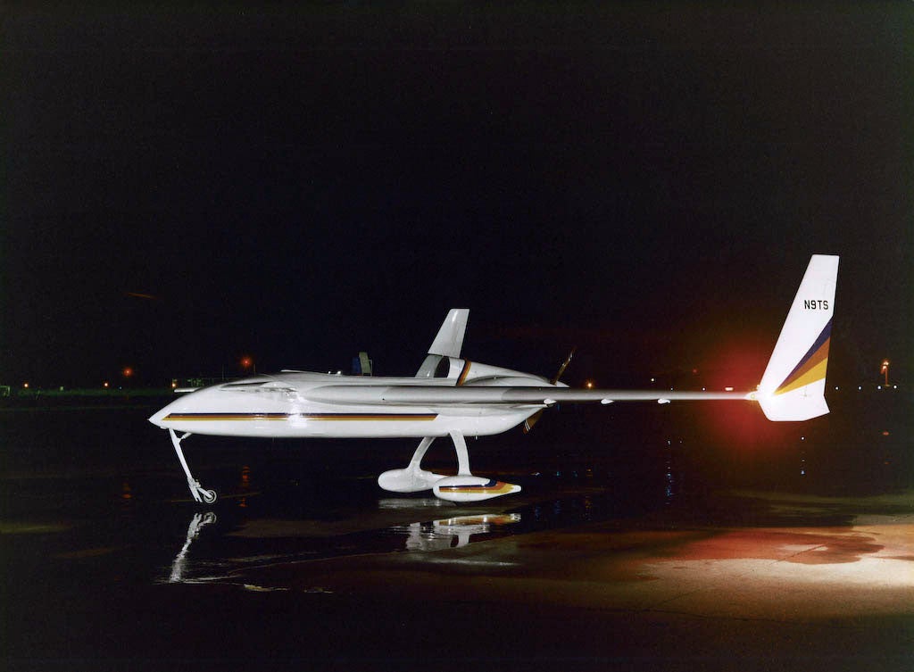

Terry Schubert’s Long-EZ engine installation is artfully revealed in this double-exposure shot, taken before and after the cowling was installed.
