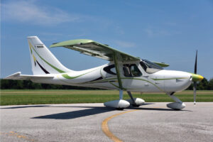

Prizio Finished Plane
Your author’s first GlaStar. It took about 2500 hours and four years to build. After three years we switched it over to conventional gear. The switch took about 40 man-hours to do the first time, but it was very easy to switch it back later.
