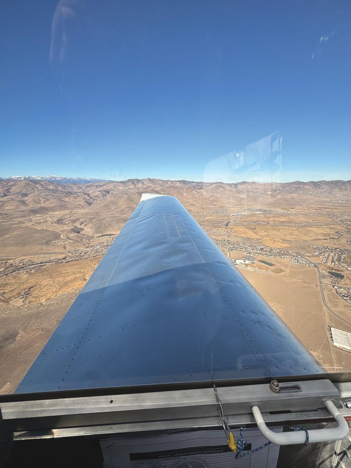

eXenos test card flight 02
Those wrinkles in the skin are simply because the wing of the eXenos is so long. But it’s still disconcerting until you get used to it.

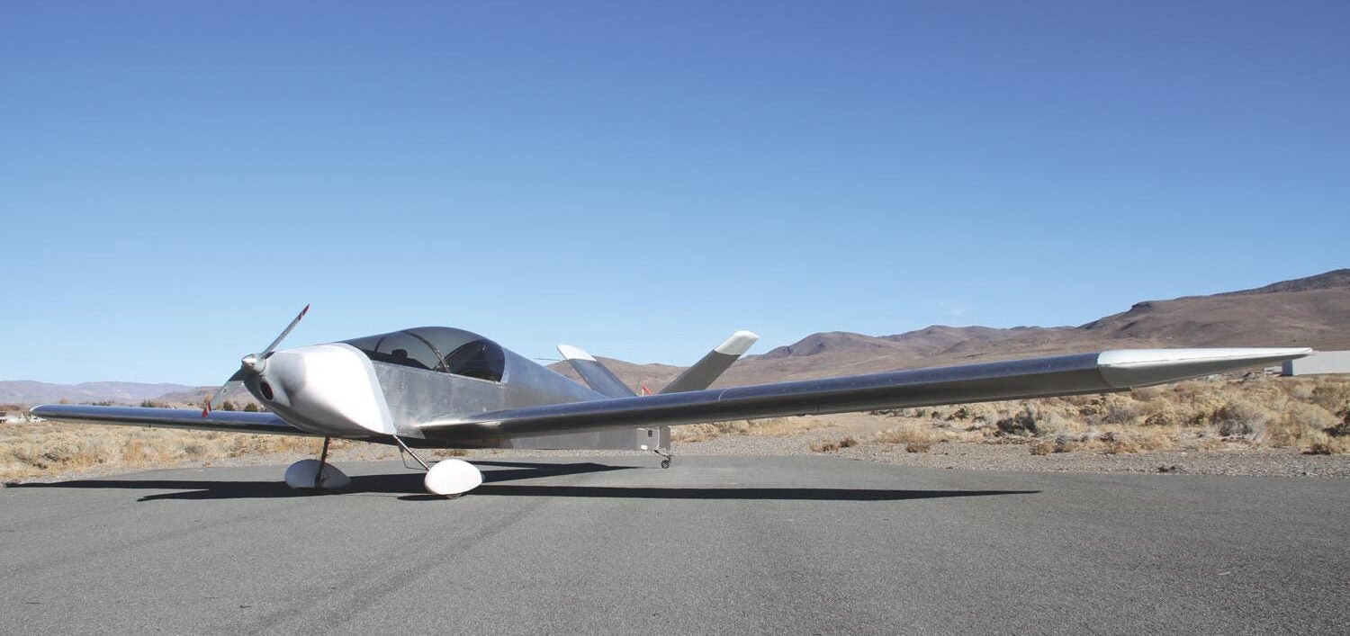

eXenos test card flight 09
The very long wings are as apparent from the ground as they are from the cockpit.
