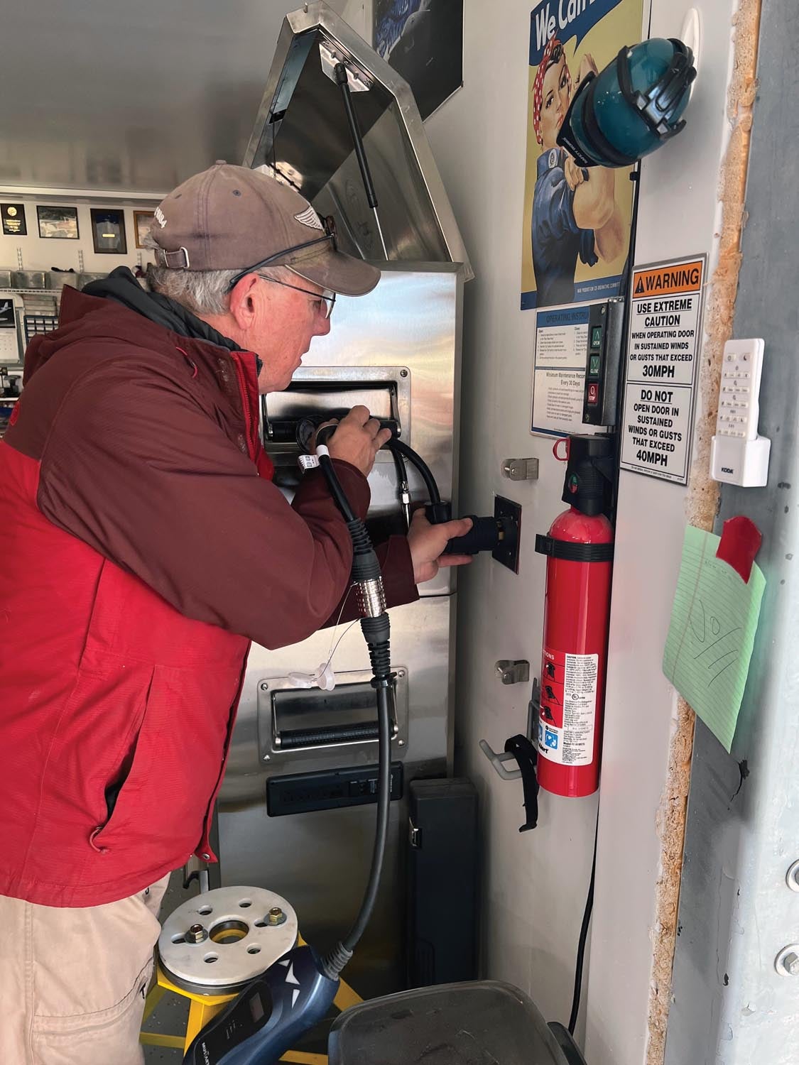

Preflight of the eXenos includes fully recharging the batteries.

We rolled the airplane out of the storage hangar and taxied it to our shop, where the charging setup is located. This taxi gave me a chance to test my helmet with the radio and to make sure the power system was happy. As I’ll point out later, the com checkout was incomplete—a common problem with many first flights! We generally store the
eXenos with between 30% and 98% charge because it is better for the battery. This morning it was at 92%, so it needed a top-off before the first flight.

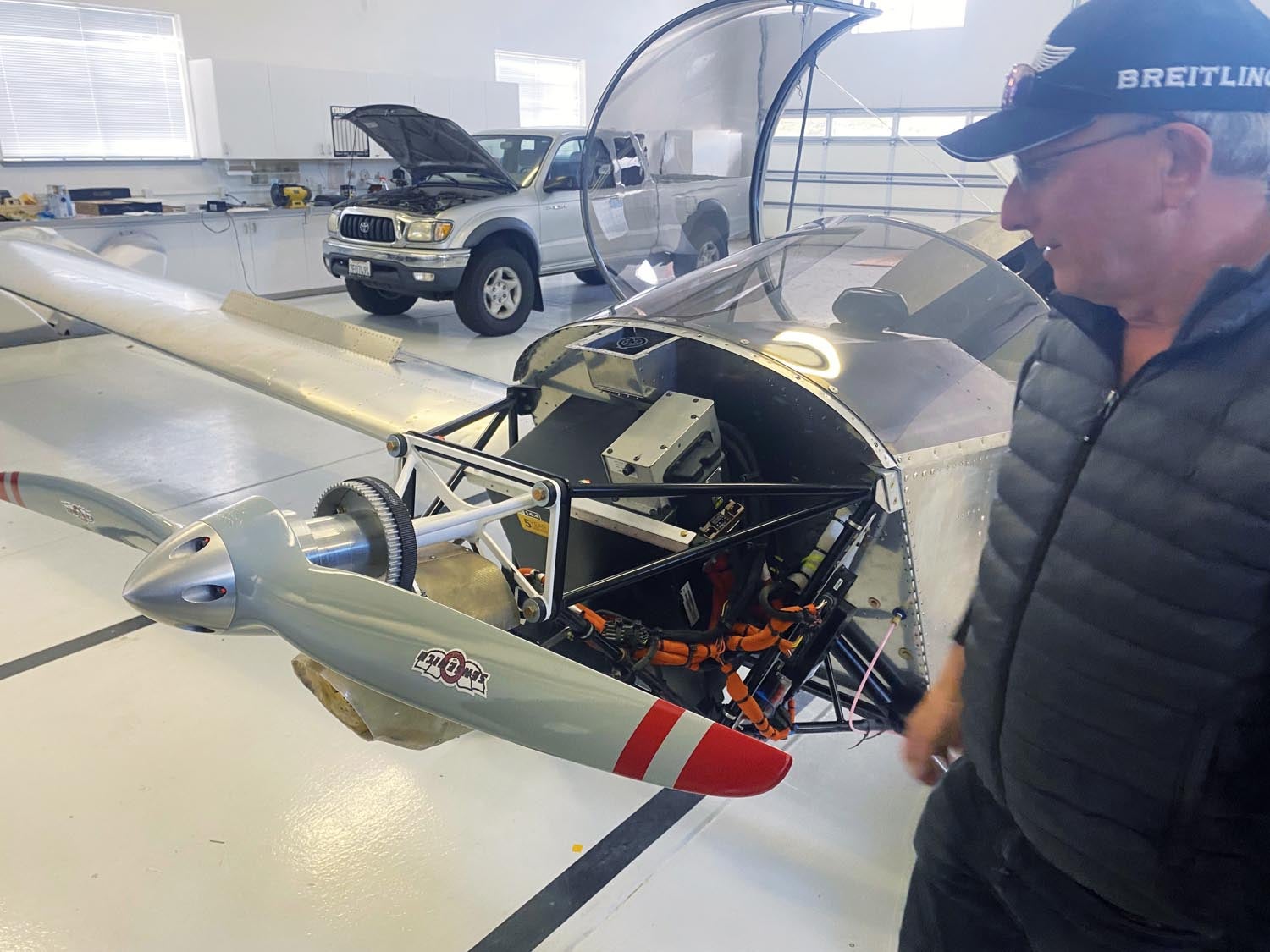

Preflighting the electric motor and battery pack is simplicity itself. Check the oil? No reason, but it’s worth giving the prop-reduction belt a second glance.

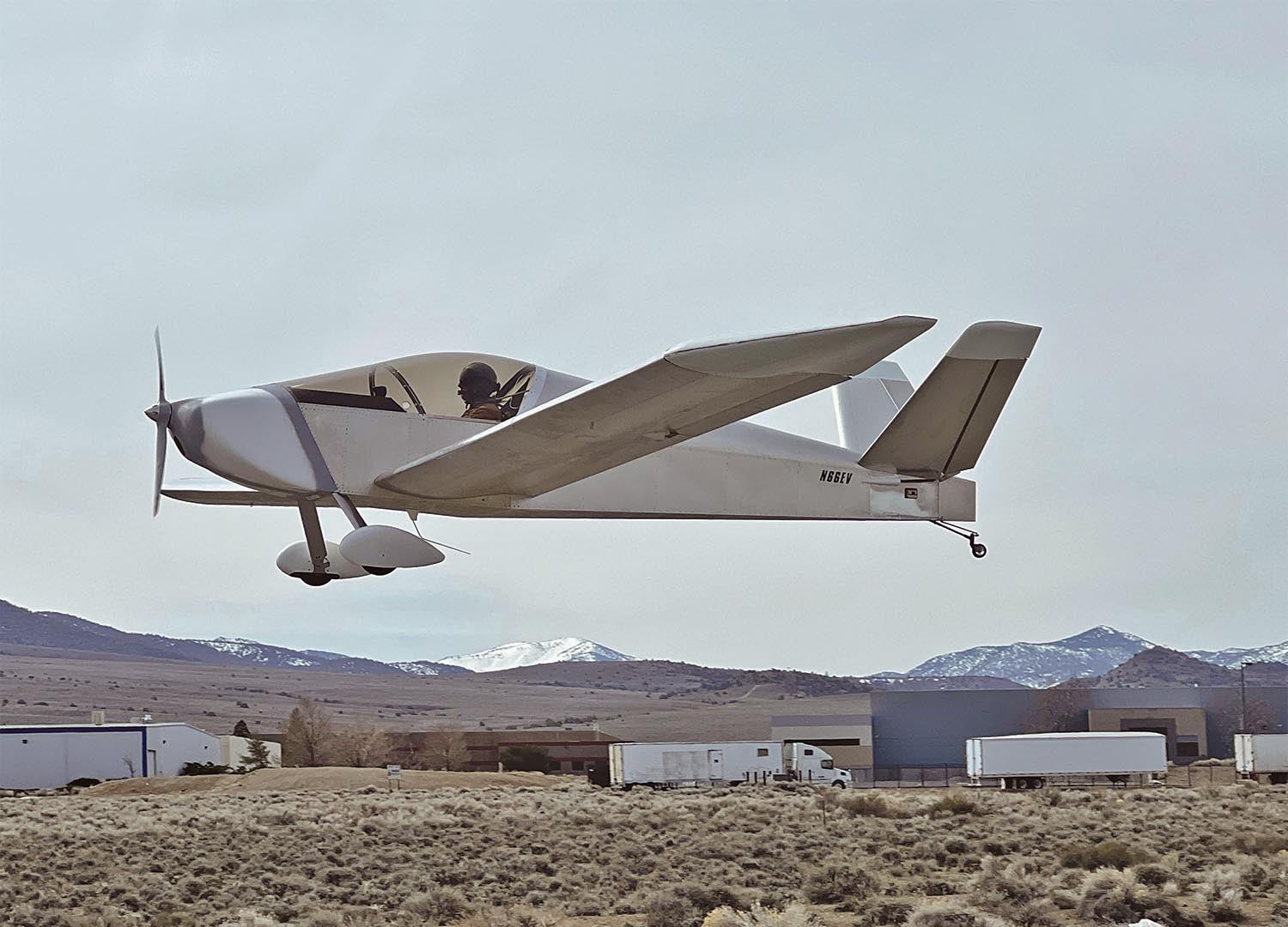

Nevertheless, the eXenos tail came up with a little coaxing in maybe 300 feet and we lifted off at about the 600-foot point. It accelerated in ground effect for a few seconds, then I lifted it to about 50 feet to check roll and pitch controls. With positive control assured, I eased back on the stick and began a climb. If I hadn’t liked the control feel, I could have set back down on the long runway. Now I was headed to the pattern.
The motor heats up quickly at full power and low airspeed. By the time I was at 300 feet, I was seeing the temperature climbing through 200° F, headed for our arbitrary limit of 250°, which protects the real limit of 300°. Fortunately, throttling back to a good climb power of about 25 kW (about half the maximum of 55 and below the max-continuous of 28) slowed and then quickly reversed the temperature rise—and still gave me a 300–400 fpm climb. Temperature management is important but not difficult. It’s also important to note that we’re at an altitude of 4400 feet msl to begin with, so the cooling air is a little thinner than at sea level, where Gabe developed the package.

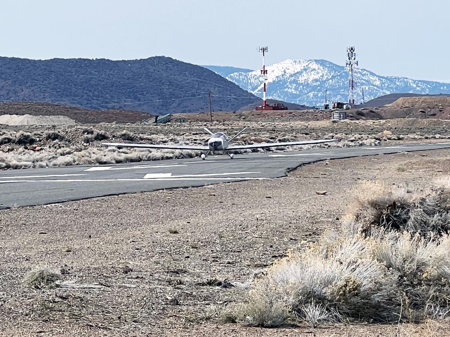

A properly planned first flight includes enough runway to allow for a brief control check while still in or near ground effect, with enough runway remaining to abort and come to a stop before encountering dirt. Be ready and willing to abort if necessary.
