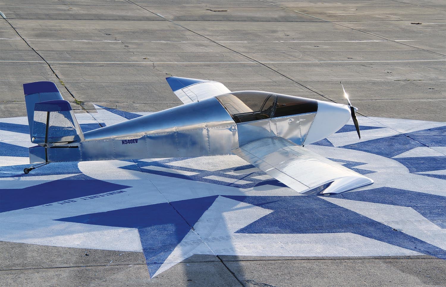

e xenos 5 03After years of on-again, off-again building, we have finally reached the point where there are no parts left in the box and it’s time to enter the flight phase of this project. Building any homebuilt involves logistical challenges, but building a motorglider (or any glider for that matter) poses one that most sport-plane builders don’t face—finding a hangar big enough to accommodate a 46-foot wingspan. While traditional gliders are usually designed to have easily removable wings, the Xenos is not quite so simple to disassemble, so you can’t simply pull the wings off after every build session and store them away. It is probably a 2- or 3-hour process to remove the wings and involves several people. Putting them back on is similar. So before we could commit to the final stages of assembly and rigging, we needed to find a hangar big enough to do the work then store the machine through Phase I.
The right hangar became available at our airpark just as the massive winter of 2022–23 arrived, so while we were able to get the components in and assembled, it became a several-months-long waiting game before enough snow had melted to allow the hangar doors to be opened, motor testing to commence and the final stages of flight preparation begun. But with clearing weather, we put the wheels in motion to get the project inspected, licensed and ready to go. First, of course, we had to determine if the eXenos was going to be an “aircraft” or a “glider.” (See “The Ins and Outs of Licensing a Glider,” below.)

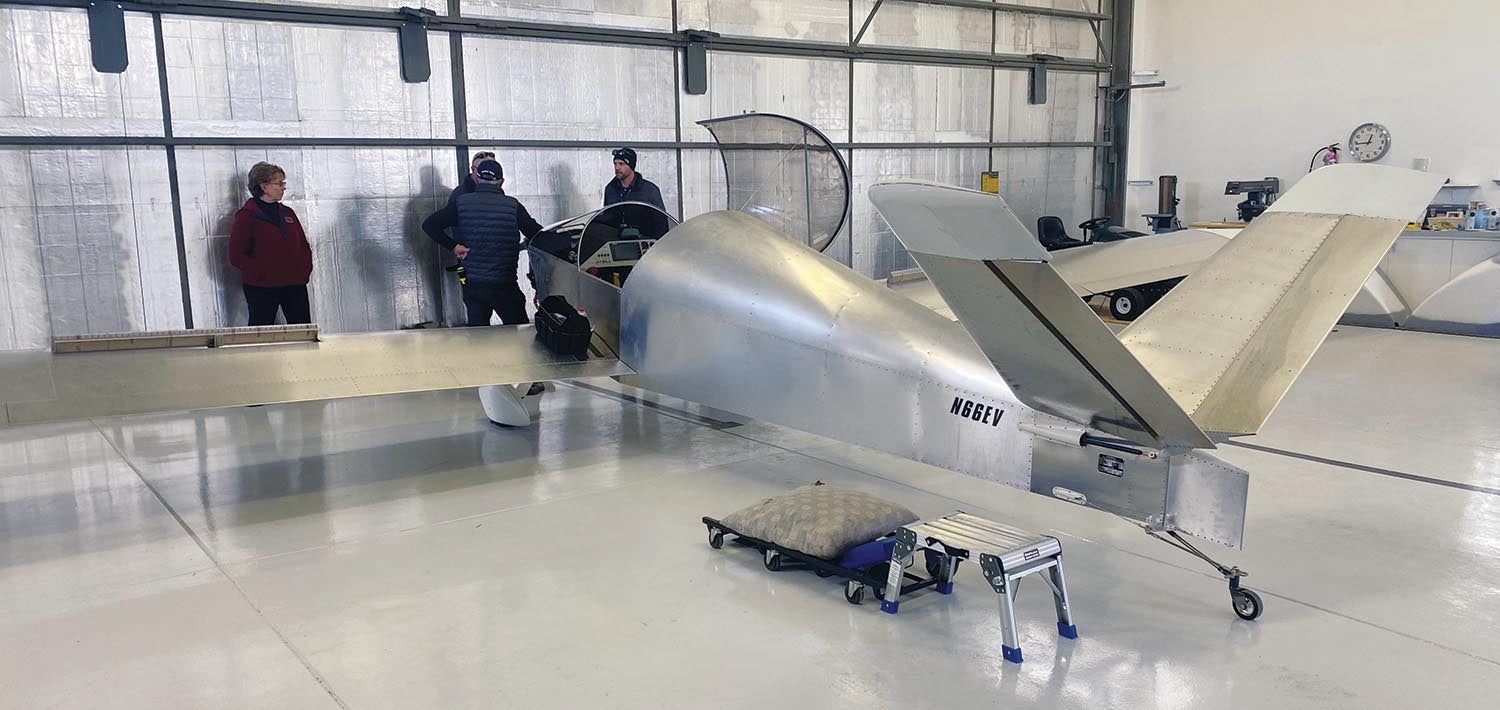

We’ve been through numerous homebuilt AWC inspections before so knew the drill well—have the airplane opened up and all the paperwork nicely organized and be ready to answer the inspector’s questions honestly and fully. In the case of the eXenos, this meant not only being ready to show that the airframe was built well and that all connections and controls were properly safetied and rigged, but we had to explain just how that funny-looking power system worked!
The airframe is, aside from the hangar-filling wingspan, conventional and very simple. The long wings meant that there were some extra pushrods and idlers in the aileron linkages to look at and, of course, since it is a glider, it has a spoiler system to inspect. The V-tail is somewhat unconventional, so there is a mixer to look at. But in the end, it’s just control connections, rod-end bearings and jam nuts to check.
Our inspector found just three things that had eluded all previous sets of eyes that have looked at the plane—one missing rivet in a row (of 100) on a wing skin, a mandrel that hadn’t broken off stuck in a rivet inside the fuselage and a bushing on the control mixer that was installed backward. All three took about 7 minutes to fix—and the airframe was ready to go.

Equally important to getting the AWC, we needed to prove during the inspection that Louise qualified for the repairman’s certificate for the airplane. Since I already have my A&P certificate, I had no need for the repairman’s ticket, and since we had built the airplane together it made sense that she have it. So we dragged out a computer with pictures from the past eight years of building to prove that she had been an integral part of the work. We also had her prepare the condition inspection checklist for the airplane, which is fairly unique once you get to the firewall-forward portion. Basically, she erased almost everything.
e xenos 5 09
The author and Louise Hose explain the motor system to FAA inspectors Gerry Rose and Ryan Branch (left). Dye explains the belt adjustment to Rose and Branch while frequent build helper Barry Wingate looks on (right).
